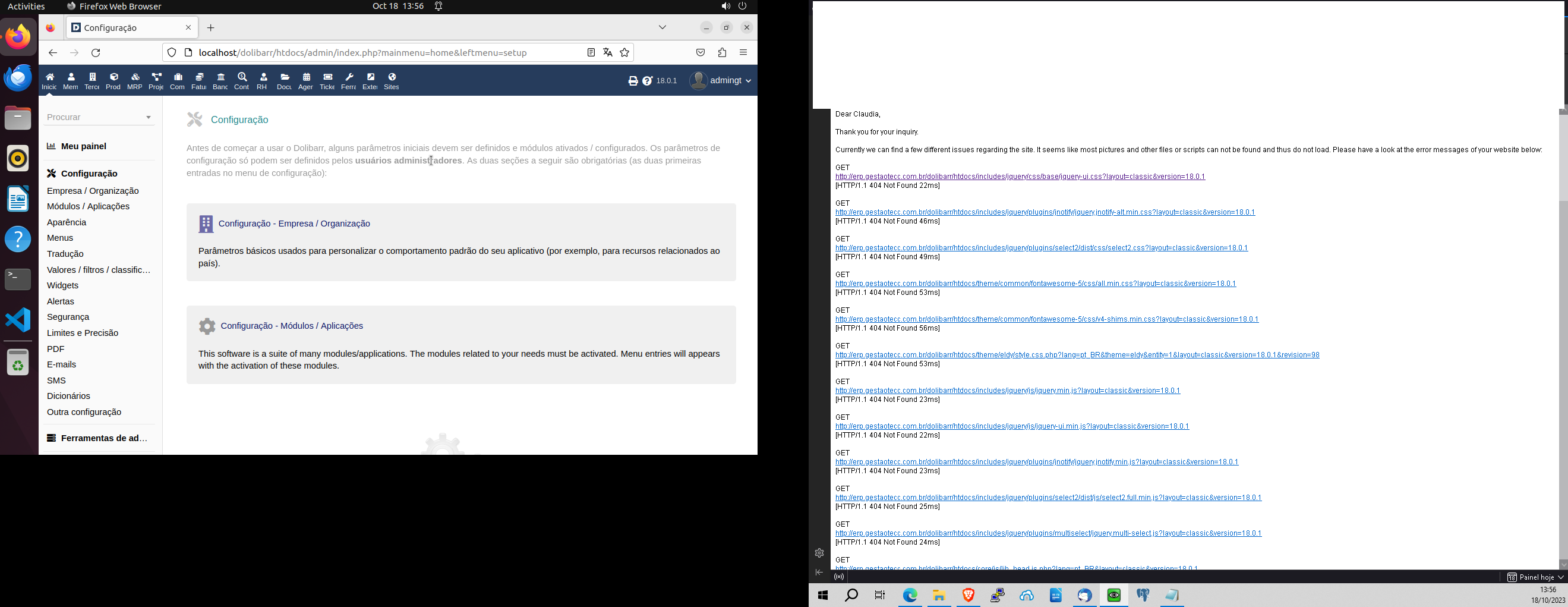

Hello dear !! Server instaled php 8.2 ubuntu 22.04
Please, tell me in fix this problem. When I try to access my dolibarr environment local its ok, but externol browser show erro not found. What I can fix this?

which platform do you run it at?
what error does your webserver show in it’s log?
can the webserver read the files?

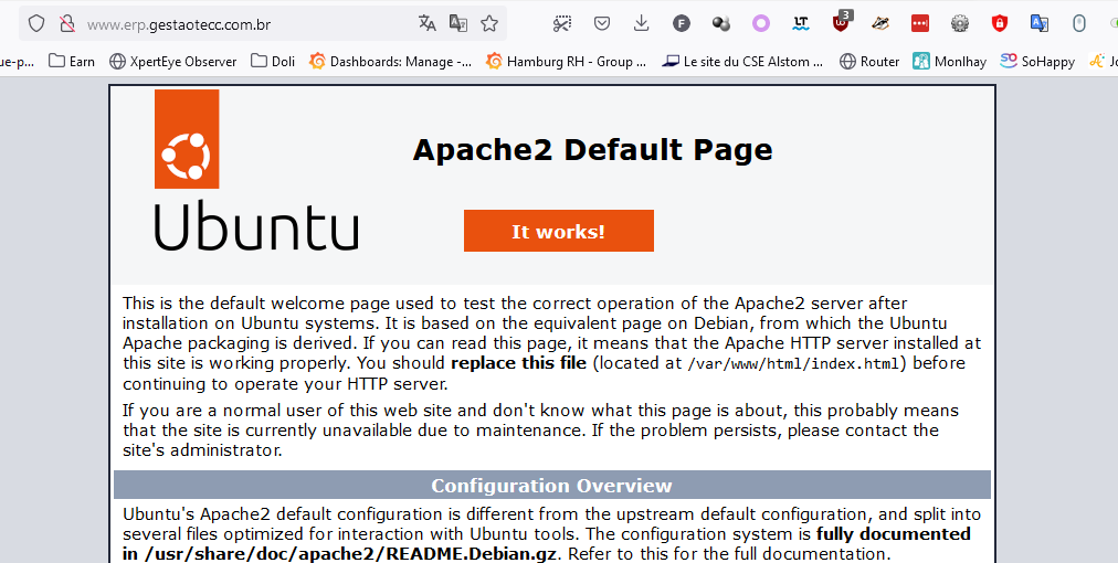

look www.erp.gestaotecc.com.br
Ok, I just removed the www.
http://erp.gestaotecc.com.br/
It’s quiet simple your $dolibarr_main_url_root variable is not good in conf/conf.php file
it should be $dolibarr_main_url_root='http://erp.gestaotecc.com.br';
