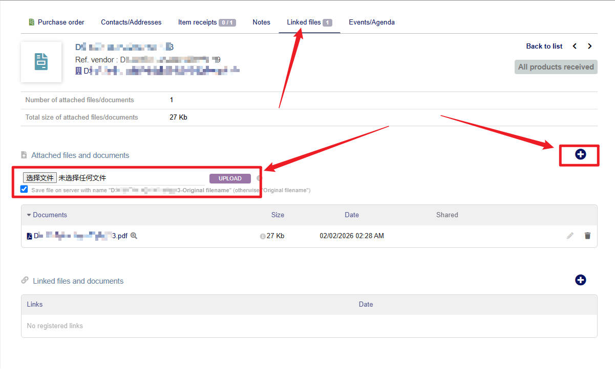

After upgrading from version 19 to version 22, it is necessary to click the “+” button in the linked file before uploading the file. How to directly display the file selection box without clicking the “+” button
Re-enable/deactivate the module; if that doesn’t work, please share the error logs.

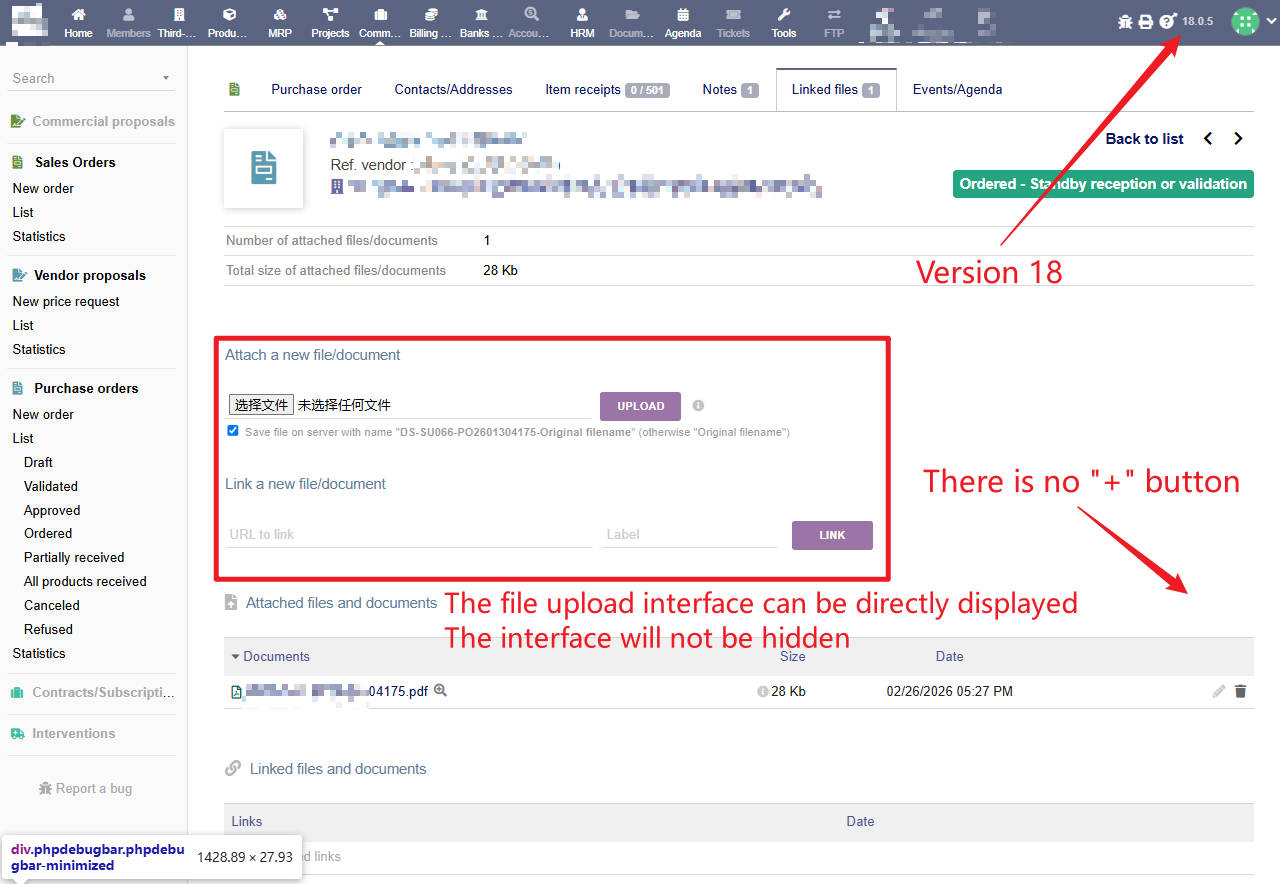

Could you please tell me how to turn off this “+” button so that the uploaded files are displayed directly like in version 18?

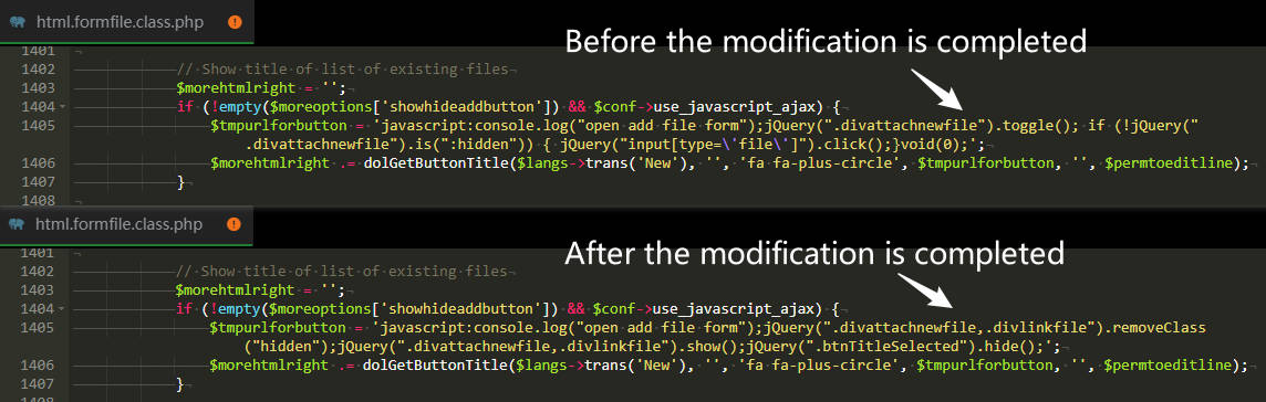

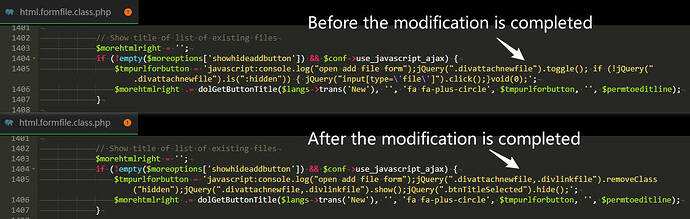

I modified the 1405th line of code in this file
/htdocs/core/class/html.formfile.class.php

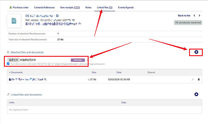

Now you still need to click the “+” button to display the file upload box
How to set it to display directly without clicking a button? Same as version 18

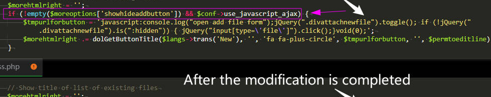

This view is generated from a (expand/collapse) HTML template vs. made dynamic with JS. Modifying the original Dolibarr documentation is not a healthy solution. You will lose these changes in situations like drag upgrades.
Ideally, you should do this with a module.
Also, the marked area indicates that there is a setting. I’ll look into that further.
Hello, where can I turn off this setting?
