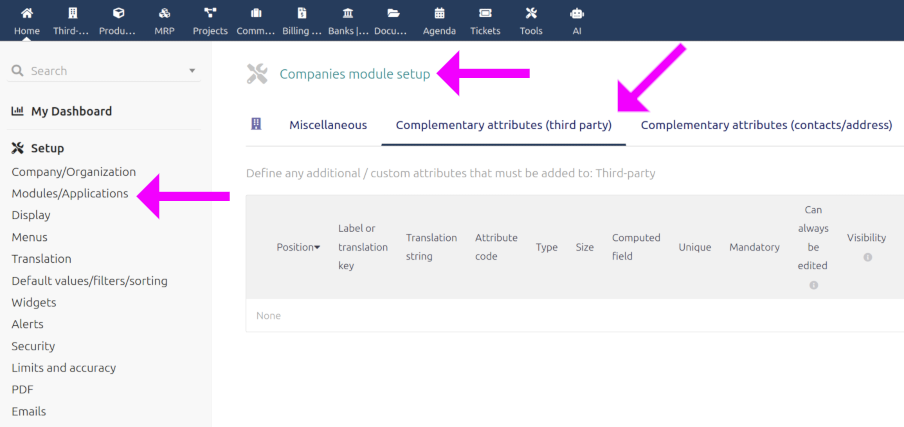

I think that in Dolibarr “third party” is the same as “company”.
You must add “extrafields” for THIRD PARTIES (“societes” in database table):
I may be mistaken here @caos30, but I think he meant his company, aka the line above in the left menu of your picture.
If so @zelly74 what kind of data are you talking about, where and when are they used?
Ah, you’re right, it probably refers to that.
In that case:
  • I’m not sure if the concept of company “extrafields” exists
  • one way to solve it would be by editing the invoice templates, or creating a new modified version to use when needed (that’s very convenient, I use it often)
  • the other way would be to create the “extrafields” as extra attribute fields for INVOICES and set default values according to what you need to appear, which will normally always be the same.
In this last case, you need to make sure those fields appear in the PDF, and that’s well explained here:
