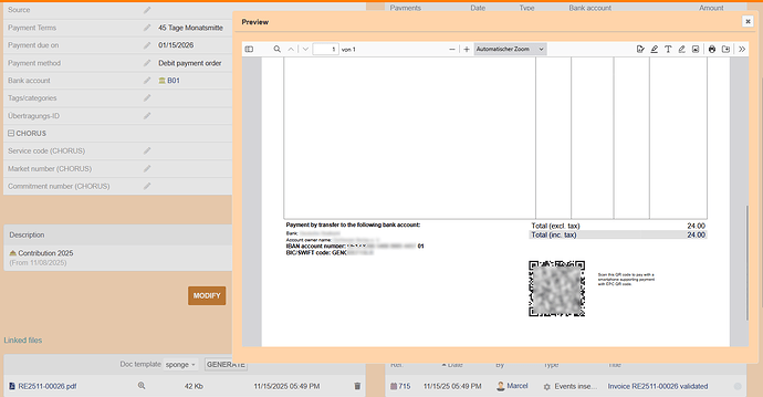

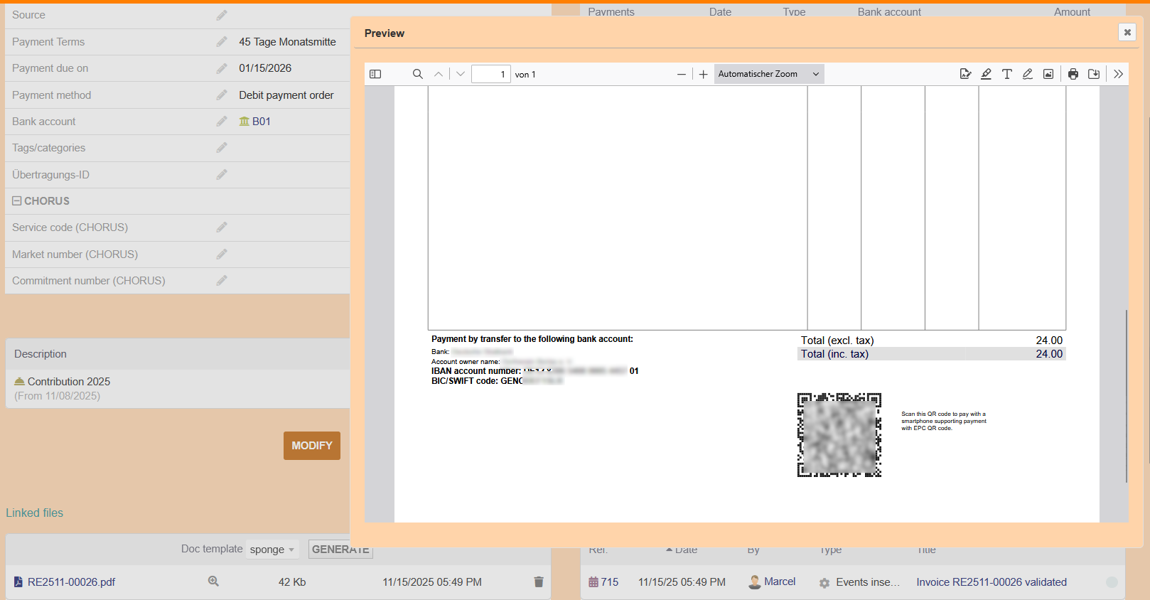

Unfortunately, the result is not as expected. In the first step of creating a contribution, an email with the PDF invoice is sent to the member. Unfortunately, not all the properties entered in the linked Third Party regarding payment options are included. Only the due date is displayed correctly. The “Payment Terms” and “Payment method” are not displayed correctly in the PDF. These are, however, displayed correctly in the invoice object - viewing https://erp.domain.com/compta/facture/card.php?id=xx. This is particularly problematic when we collect membership fees via debit payment order.

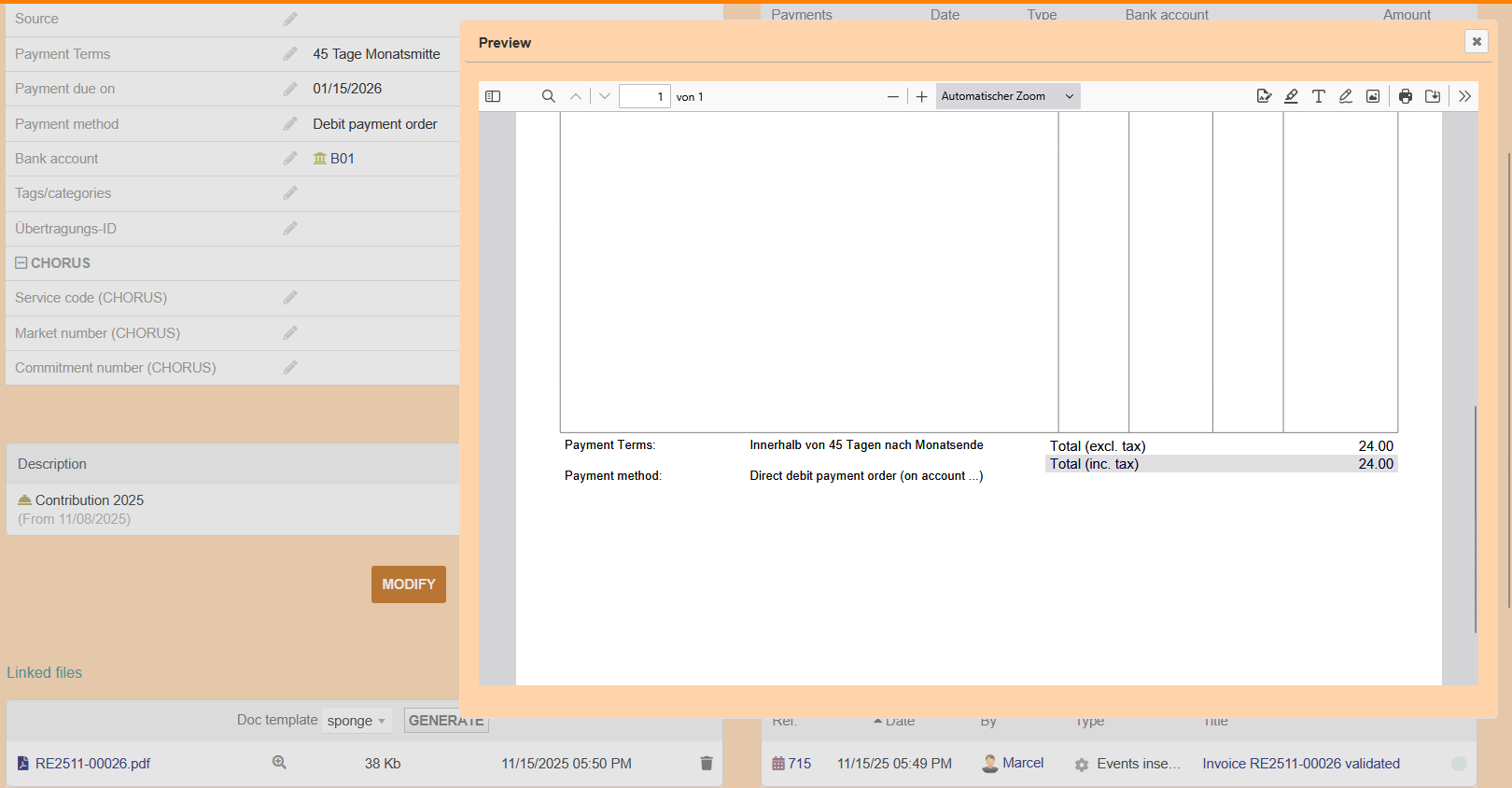

Only when I regenerate the PDF within the invoice object, the payment details are included in the PDF as desired. I have attached two screenshots to illustrate both situations.
Initial Invoice with false infos in PDF:
Correct Invoice after Re-Creation of PDF:

I can’t identify any intermediate trigger or notification calls that would disrupt the planned process of creating an invoice and a PDF document with the intended third party payment terms, as defined in the source code.
The PDF document generation starts at 20:41:16 (UTC). The result is the created file “RE2511-00037.pdf”. This time is identical to the file’s timestamps (CET) in the filesystem when I check the console.
bash-5.2$ pwd
/company-cty.de/erptest/htdocs/documents/facture/RE2511-00037
bash-5.2$ ls -la --time-style=full-iso
insgesamt 52
drwxrwx--x  2 hosting209502 psacln  4096 2025-11-17 21:41:17.185898791 +0100 .
drwxr-xr-x 39 hosting209502 psacln  4096 2025-11-17 21:41:16.897883804 +0100 ..
-rw-rw----  1 hosting209502 psacln 43149 2025-11-17 21:41:17.185898791 +0100 RE2511-00037.pdf
Any suggestions?

I think I’ve found the solution. Before generating a PDF document, it seems to be necessary to update all the information and parameters for the object to be printed by using a fetch call.
I added the following to the code before calling the generateDocument function:
$invoice->fetch($invoice->id); // Reload to get new records
Since then, all newly generated invoices created when setting up a new subscription for a member and sent via email template now contain the correct payment terms and conditions as defined in the linked third party.
I will analyze this further and then submit a fix pull request via github.
Thank you for very much your support.
Rather than inserting it just before calling the generateDocument, what if the generateDocument functions would do a fetch first things first?
Hi @jonbendtsen
If I understand the use of the “generateDocument” function correctly, it’s generic, meaning it can be used to generate a PDF document regardless of the source object (invoice, order, delivery note, payment, etc.). Therefore, it doesn’t make sense to me to process the content and parameter data (e.g. payment terms) for an invoice within this function.
Lacking better knowledge, I’ll leave it as is with my proposed addition to the source code. I’ve conducted several successful tests generating PDF invoices based on this code change.
A pull request has been submitted
