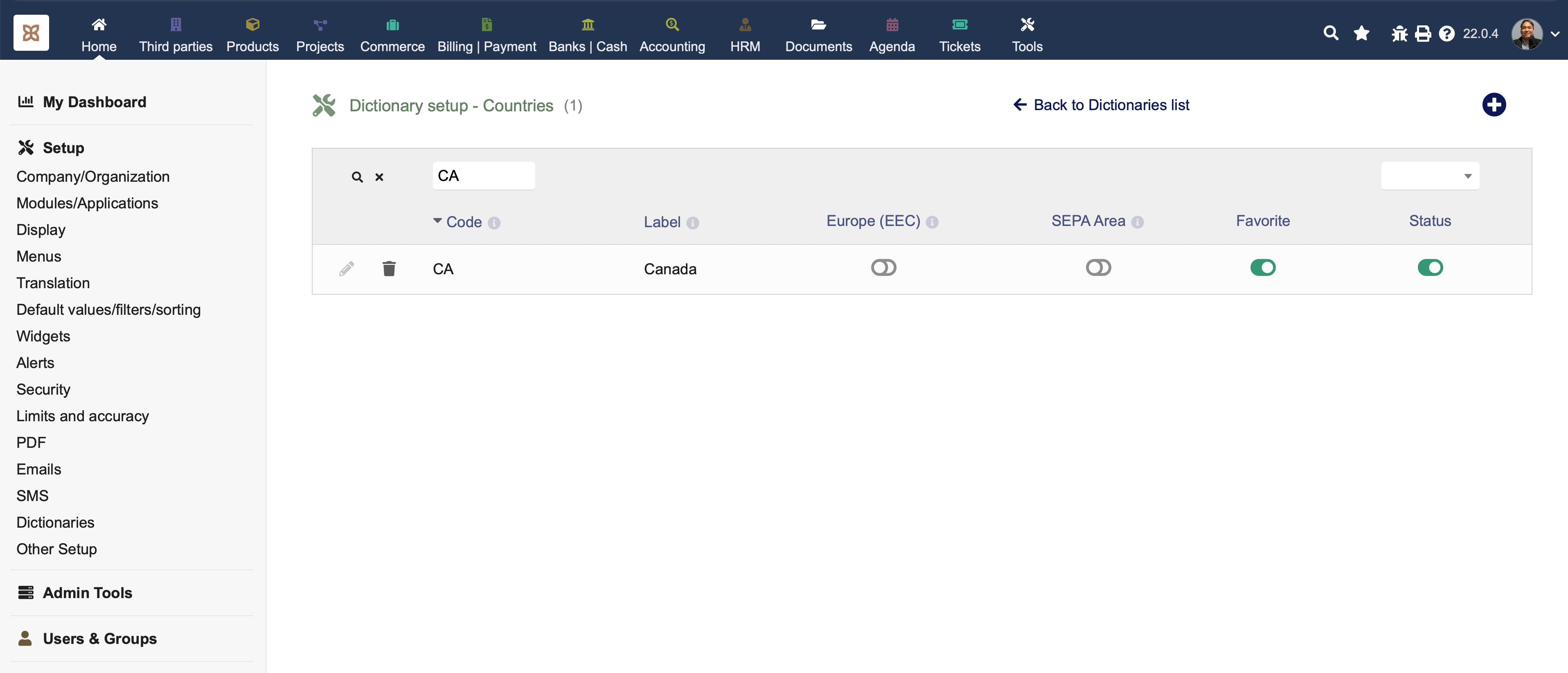

  1. Dictionary Setup: Navigated to Setup > Dictionaries > Countries. When editing Canada, the “Bank account format” field is not visible. Only EEC and SEPA checkboxes are present.

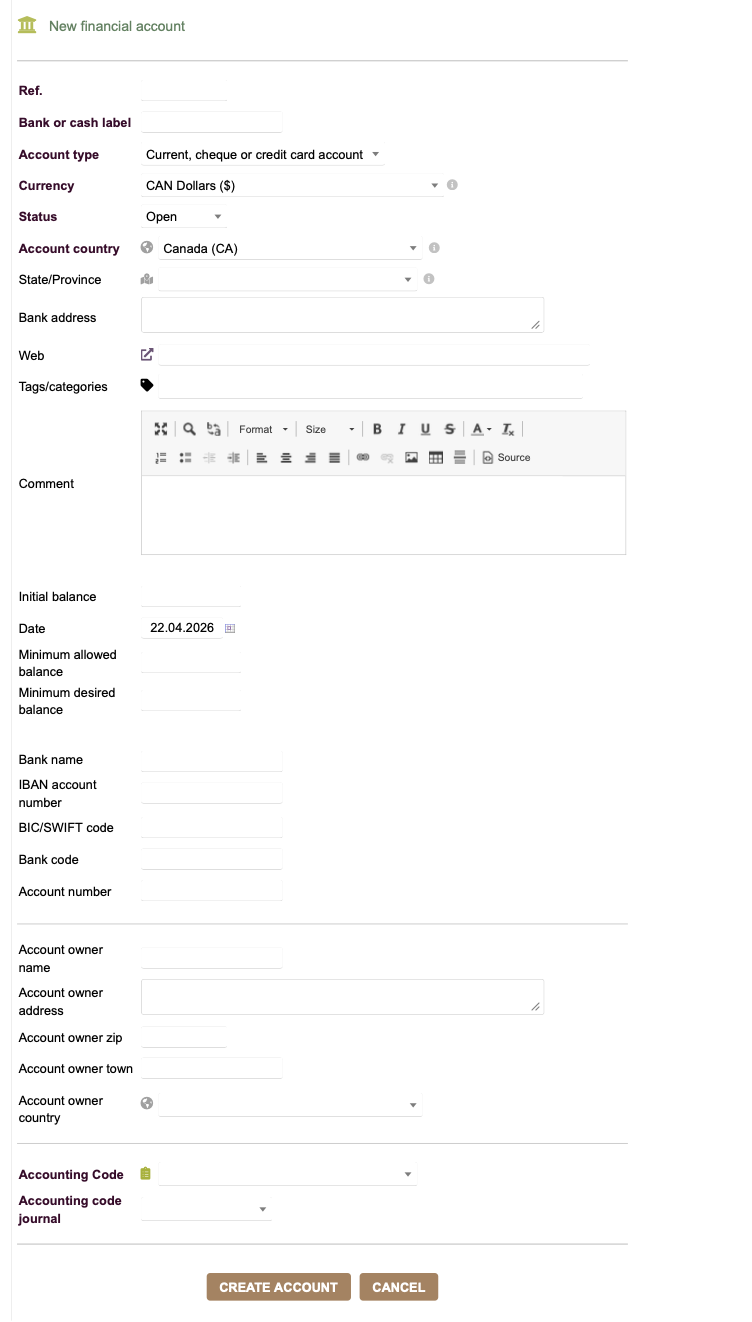

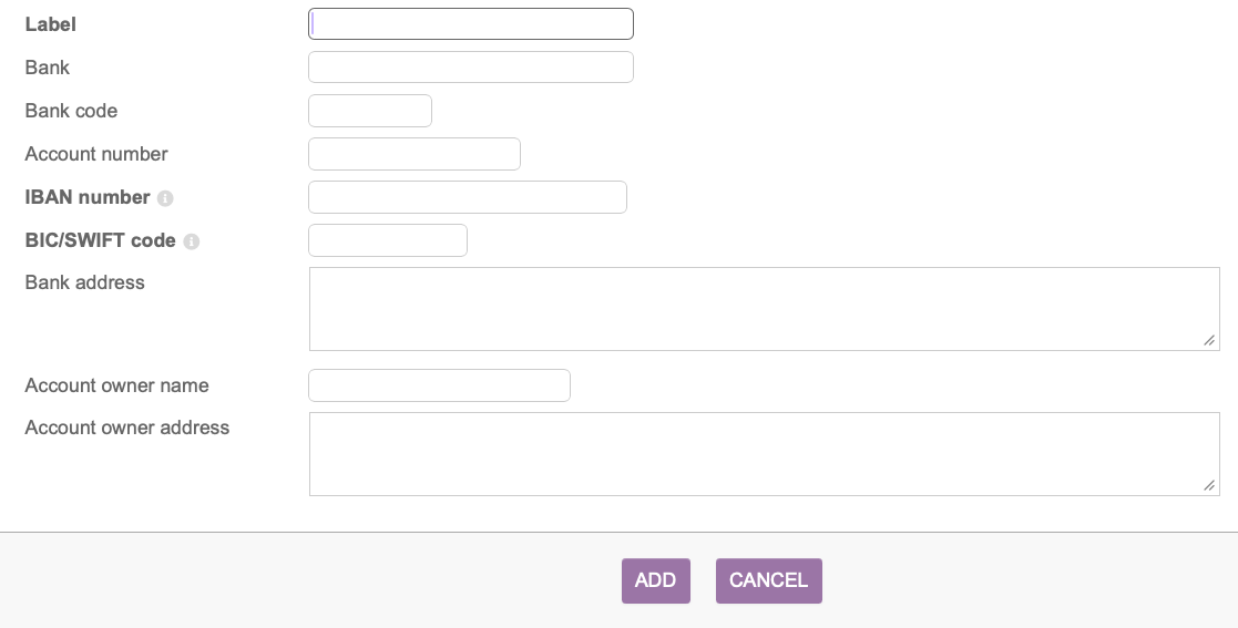

All I’m getting is this screen:
Thanks again for your help!

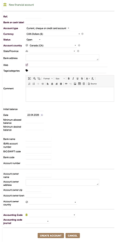

Hello Jonbendtsen,
Thanks for your reply!
Yes, the screen appears in my address: Dolibarr.MyWebsite.com/compta/bank/card.php?action=create
The issue is that In North America we use three fields to Identify Bank Accounts for EFT purposes and all wire transfer:
  • 3-digit Institution number (code_banque)
  • 5-digit Transit number (code_guichet)
  • Bank Account number (number)
Me and the AI (Claude) I’m using to configure my Dolibarr instance, believed that the options shown in the screen ( Dolibarr.MyWebsite.com/compta/bank/card.php?action=create ) are tied to the Company’s Country as defined in the Country Dictionary.
The question is how to make Dolibarr show these fields (code_banque, code_guichet, and number) instead of the European Banking Fields that should only be shown when (IBAN account number, BIC/SWIFT code) when you set the country option to EEC or SEPA in the Country Dictionary?

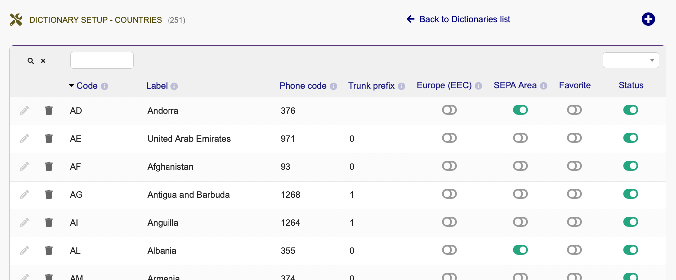

Activating or de-activating the “Europe (ECC)” or “SEPA Area” seems to do nothing at all to that screen.

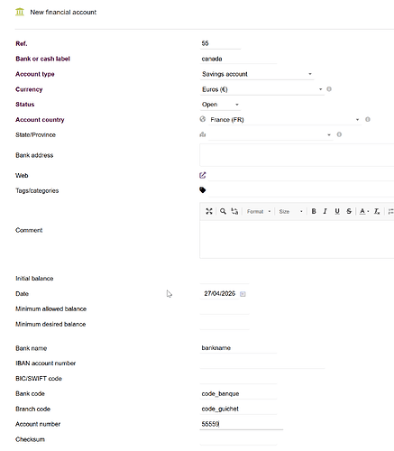

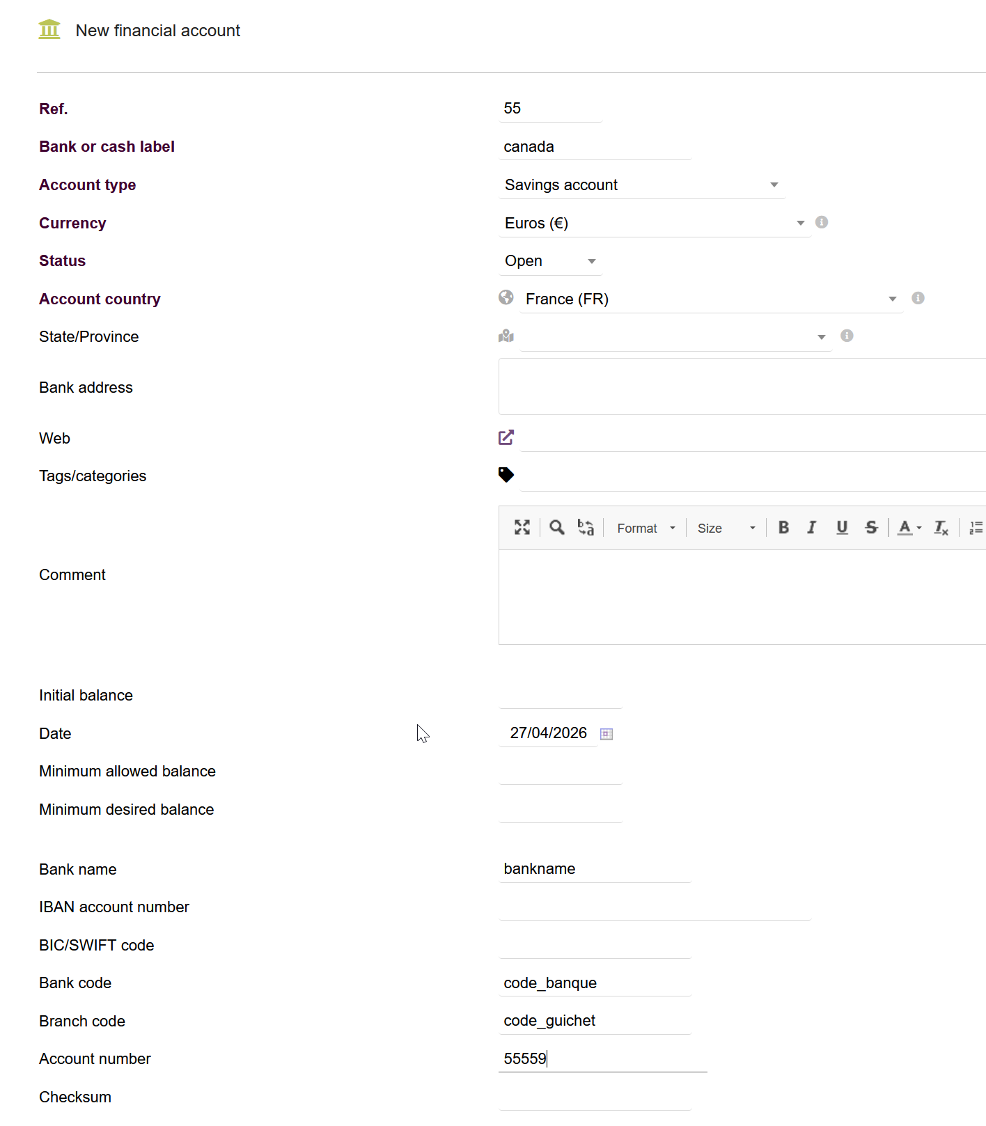

Hi Sterling,
seams to be a bug in Dolibarr. But if you switch the account coutry to France you have all the field:
using Canada as country for the account makes code_guichet disapear.

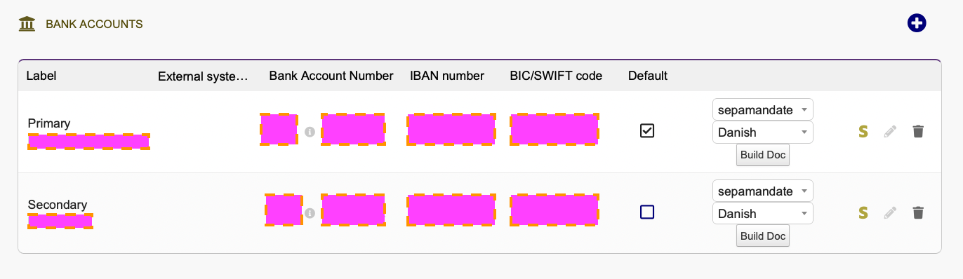

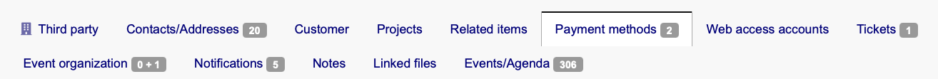

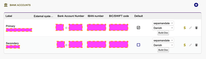

yes @Stejimenez. I think this table is populated if you go to a Thirdparty card and select the Payments Methods tab.
and from here you add 1 or more bank accounts

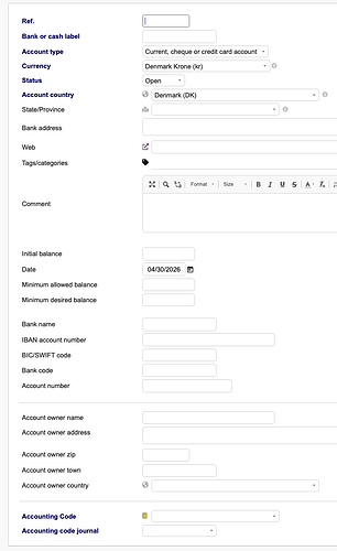

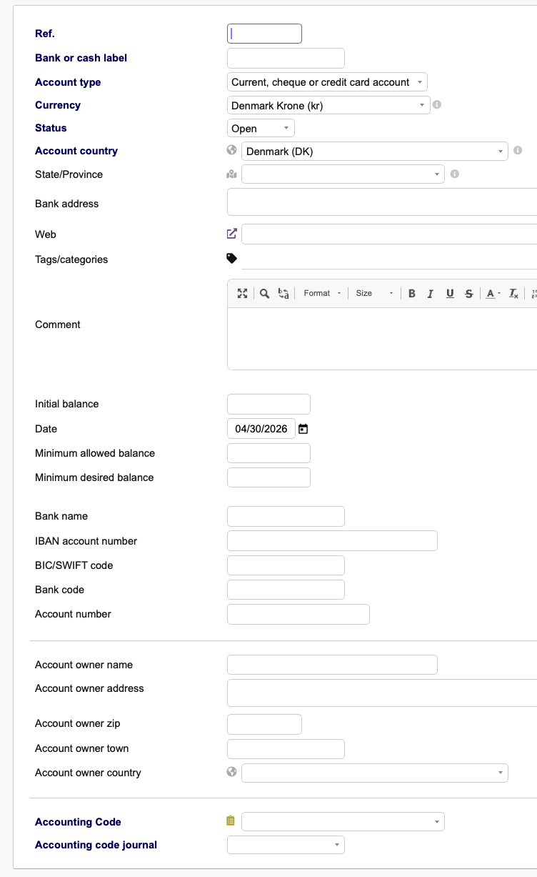

I don’t know the legal requirements @Kim_KW1975 , but I am working on a PR in core dolibarr that enables country, state, currency and status on the account - almost there
My PR has been merged, so this functionality should be available in Dolibarr v24 once that is released in a few months?
You can see pictures in the PR linked just above

@MarcLaporte my PR was merged, so the form should be changed from dolibarr v24.0.0
You can see some screenshots here
