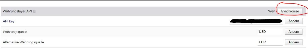

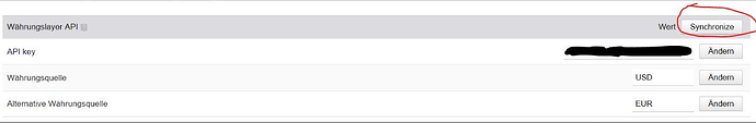

I have setup the multicurrency several years ago and always updated it manually, I found a post to update them with an API key from https://currencylayer.com/ but I could only press the sync once, then it disappeared.
How can I re-enable this field? I have changed MAIN_MULTICURRENCY_ALLOW_SYNCHRONIZATION set to 1.

I am using the same version. When I press the sync button, the following warning appears in the upper right corner of the screen.
Use of API for currency update is disabled by option MULTICURRENCY_DISABLE_SYNC_CURRENCYLAYER

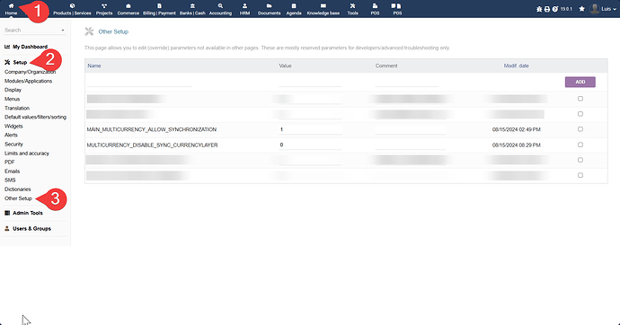

We fixed the Multicurrency as follows:
  1. Under Home->Setup->Other Setup we added the following as a precautionary measure:
    MAIN_MULTICURRENCY_ALLOW_SYNCHRONIZATION (set to 1)
    MULTICURRENCY_DISABLE_SYNC_CURRENCYLAYER (set to 0)
  2. directly in the code, in module: multicurrency/class/multicurrency.class.php, we commented out the global variable: MULTICURRENCY_DISABLE_SYNC_CURRENCYLAYER as it seems to break the sync features of the module. As the same variable was defined in the “Other Setup” section of Dolibarr, these feature is still available.

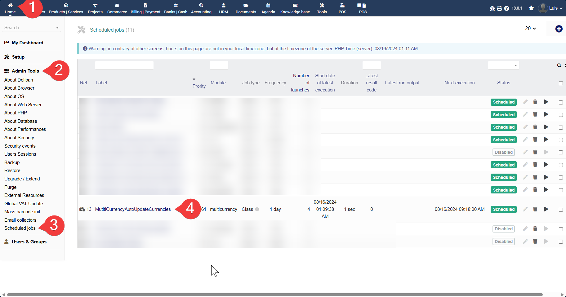

You can find the Cron job in Home-> Admin Tools-> Scheduled Jobs-> MultiCurrencyAutoUpdateCurrencies
If the cron job does not appear, turn off the Multicurrency module and turn it back on, that seems to fix the issue.

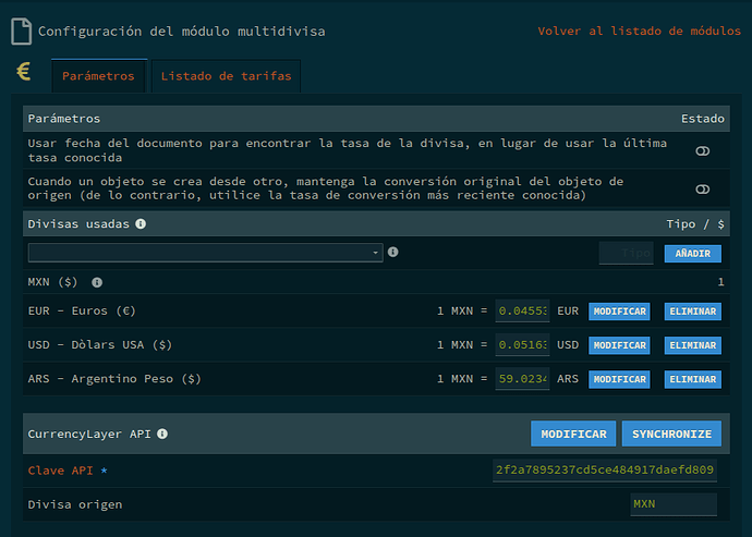

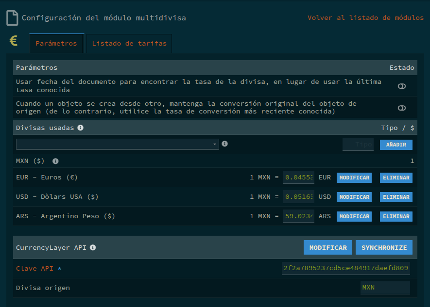

I’ve updated from Dolibarr 18 to DOlibarr 20.0.4 and it works as expected:

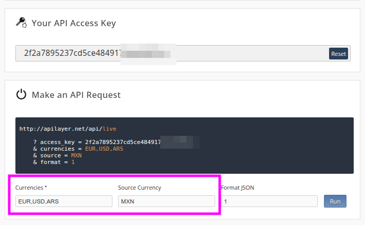

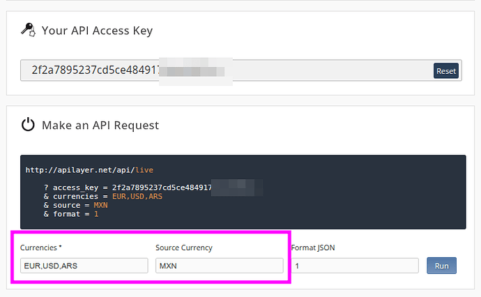

I really had to make some failed attempts before it worked, but i never couldn’t understood what was wrong. But you can test this: change different “source currency” (the last text box)… i finally put MXN which is the currency by default of my company.
Also i click the “RUN” button on the CurrencyLayer dashboard (on “Make an API request”), after define as “source currency” (MXN) and “Currencies” my other usual currencies used in my Dolibarr (EUR,USD,ARS):

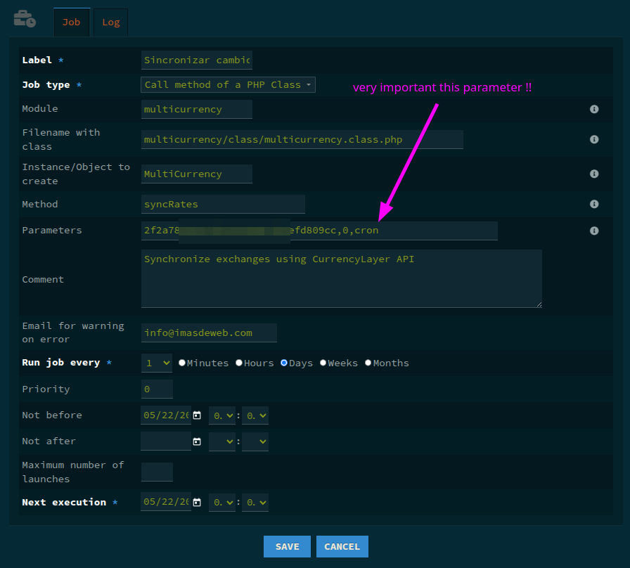

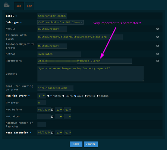

Indeed, i struggled a bit enabling the “scheduled task” to synchronize ONCE PER DAY the currency exchanges, so let me share here my settings for a new “scheduled task” defined from scratch:
Briefly:
  • Job type: Call method of a PHP Class
  • Module: multicurrency
  • Filename with class: multicurrency/class/multicurrency.class.php
  • Instance/Object to create: MultiCurrency
  • Method: syncRates
  • Parameters: <YOUR_API_KEY>,0,cron

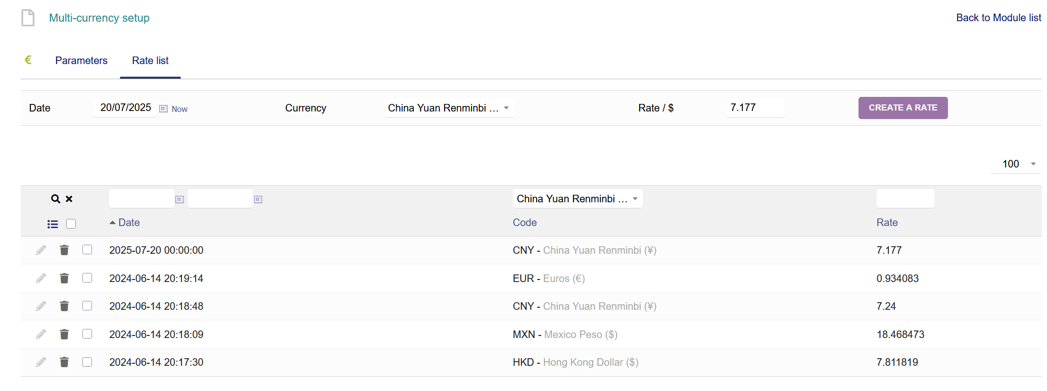

Hi. I have the same confirg in the crontask. The crontask is executed properly, in currencylayer is increased the number of API calls, and result of call error =0. Only the problem is that the record is not generated and stored in the Rate list of the module multicurrency. So the call to the API is succesful, but the result is not stored in the database, always i just have the entries i did by hand:
