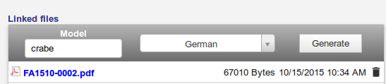

How do you edit PDF templates for your invoice?
How do you edit pfd templates for your invoice?
No need to Edit - model “crabe” works out of the box!
