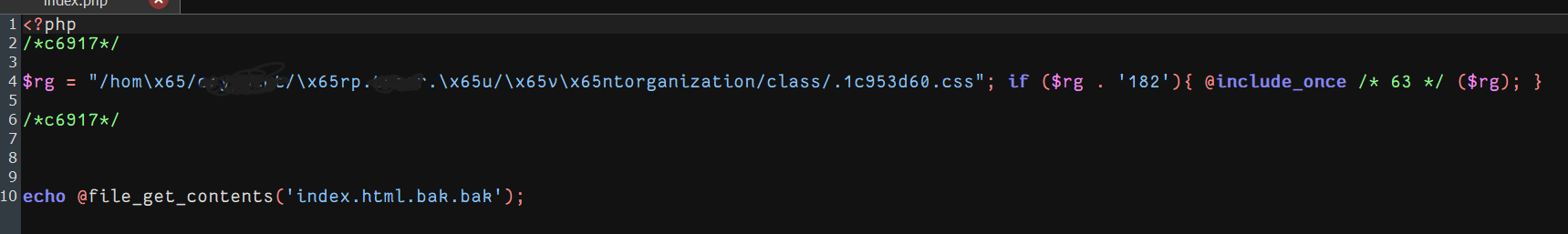

I noticed a pattern that a lot of index.php and index.html.bak.bak files were added inside most of the subfolders of the Dolibarr folder. The PHP files are referencing a css file with PHP content. They are all over the place.
The most annoying thing is that these files are also in other folders of the hosting (some other websites).
How to clean this mess? I plan to reinstall the dolibarr completely, but the question is how to make sure that this hack did not change anything inside the database?
I tried to cahnge my admin password, but I couldn’t which is really bad.
First thing I updated the Dolibarr via Softaculus to v 19, which replaced the corrupted files, but left the additional hacked ones there.
The content of the css file looks like so:

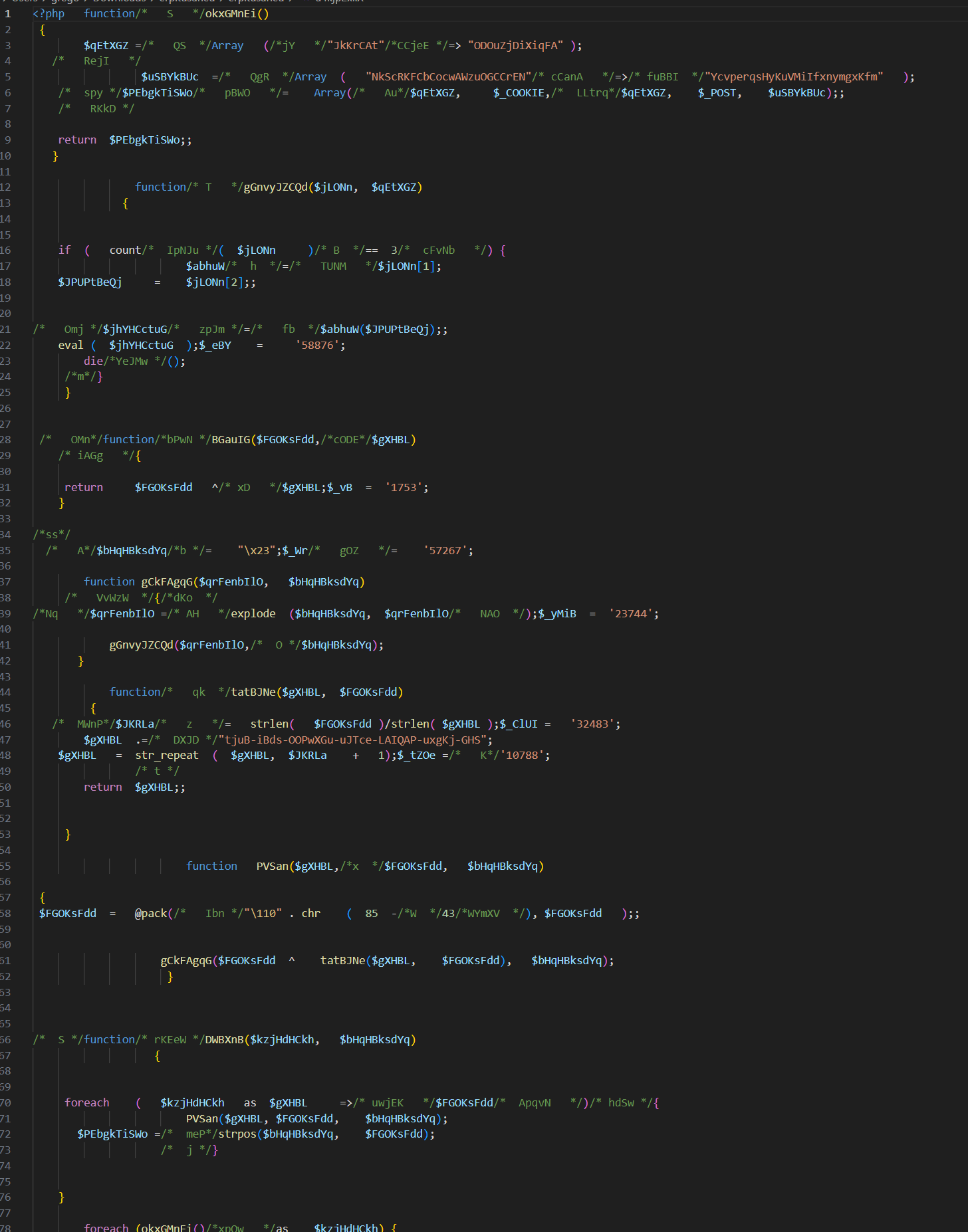

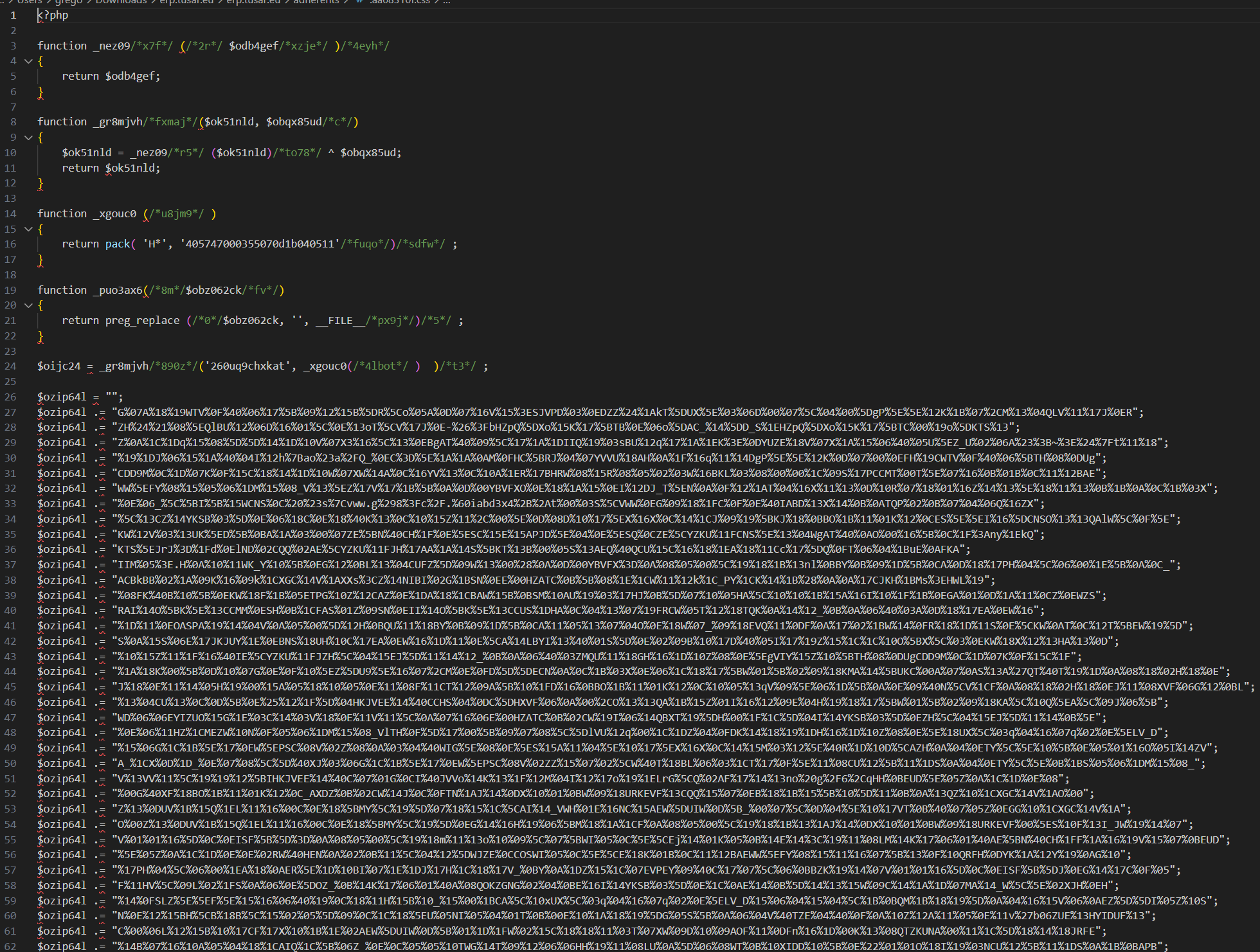

There are also some additional PHP files that have the content looking like this:
