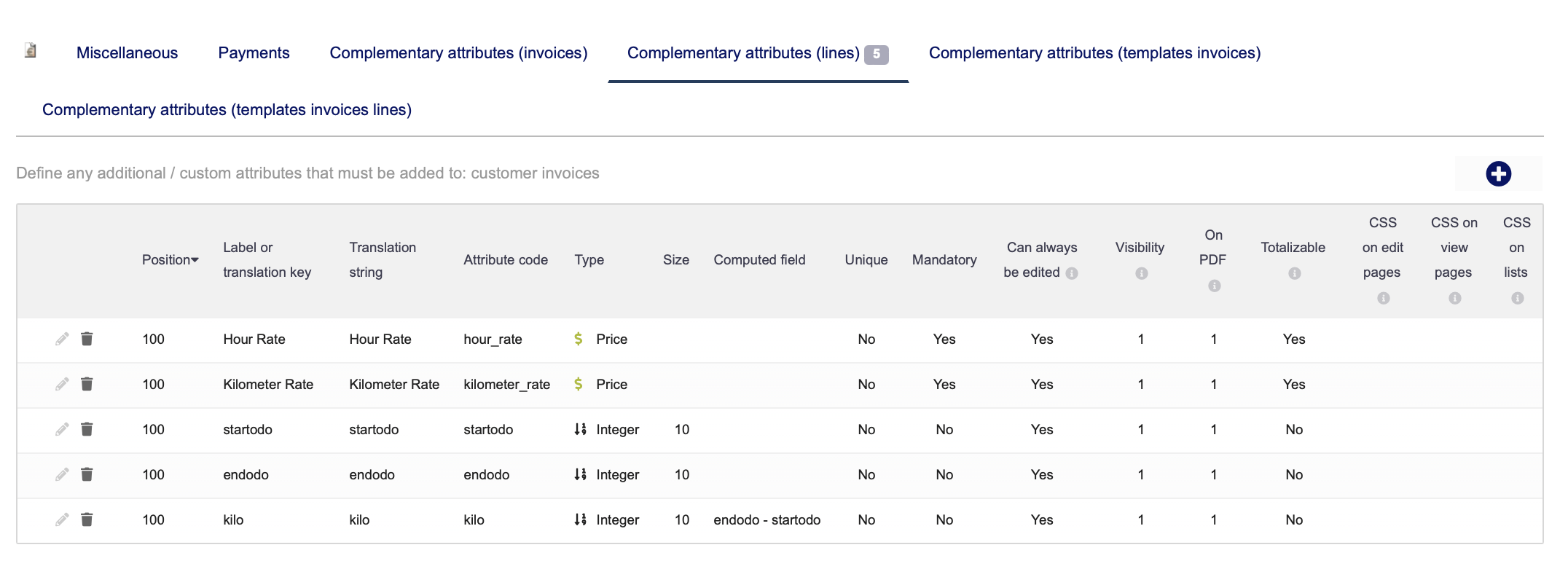

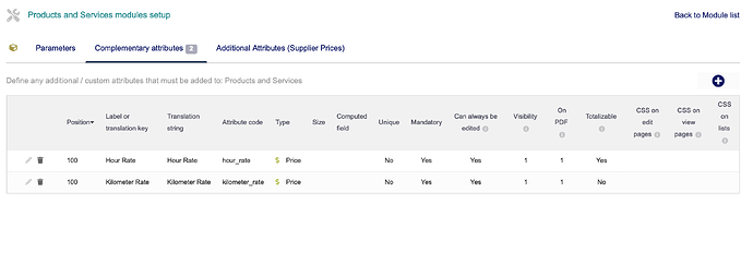

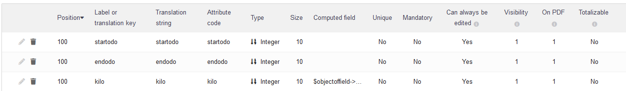

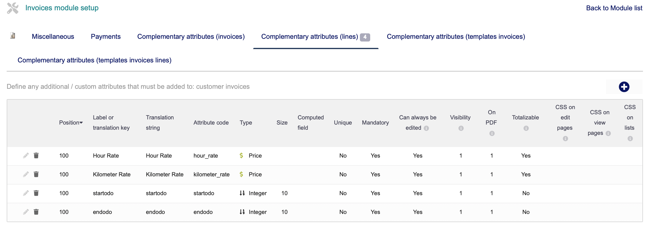

i created it in products and services also in invoice for now until i have to calculation formula to follow in proposals and orders

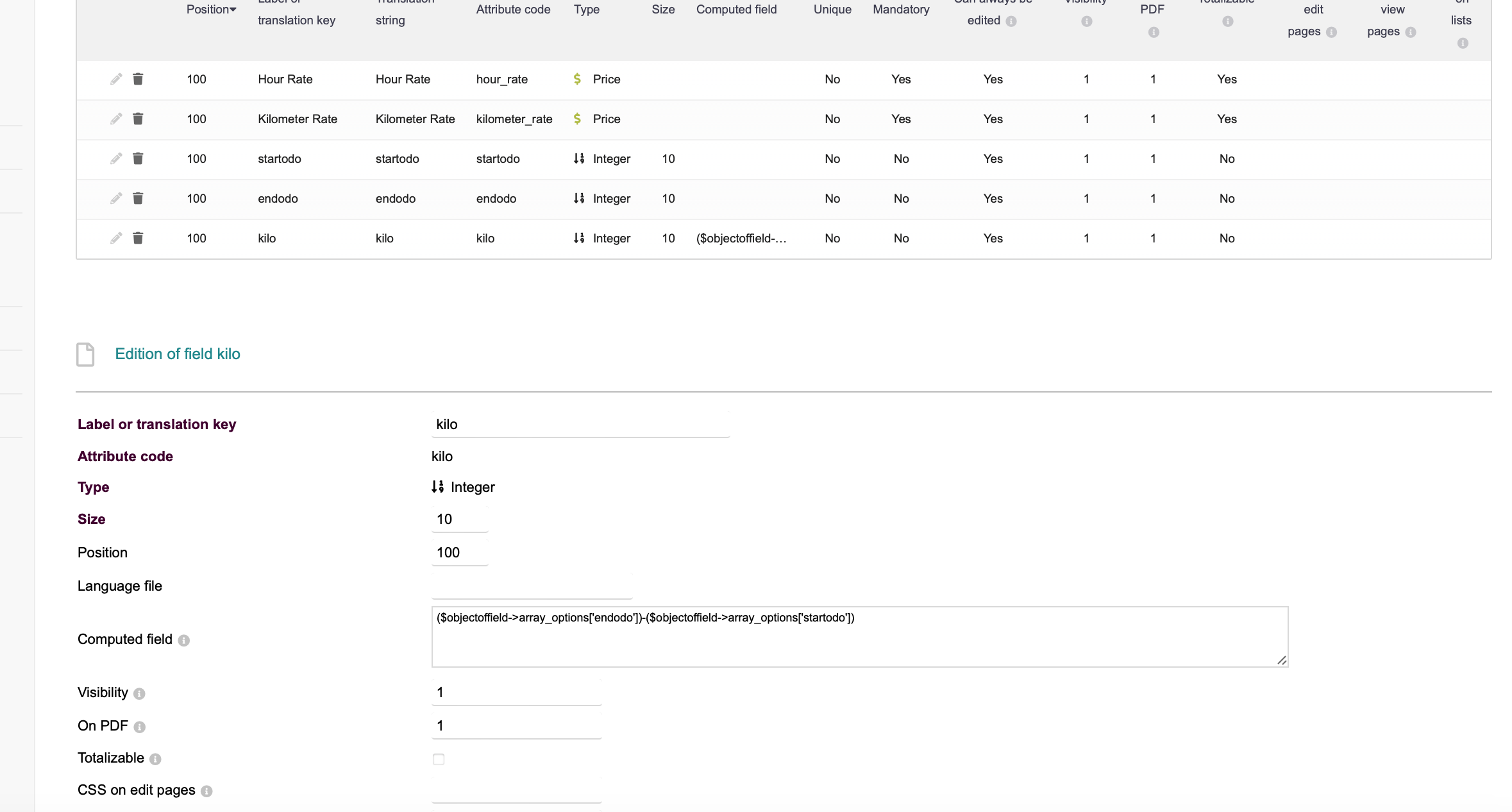

i am still missing the calculation field to get the km and hours but i dont know how the computed should be
i am missing how to make correct formula to calculate the kilometer

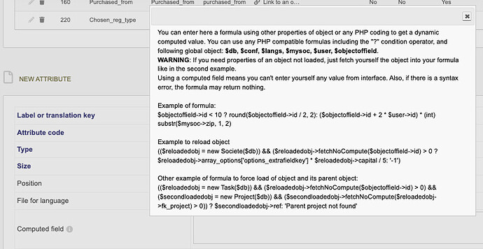

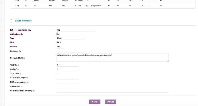

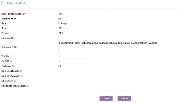

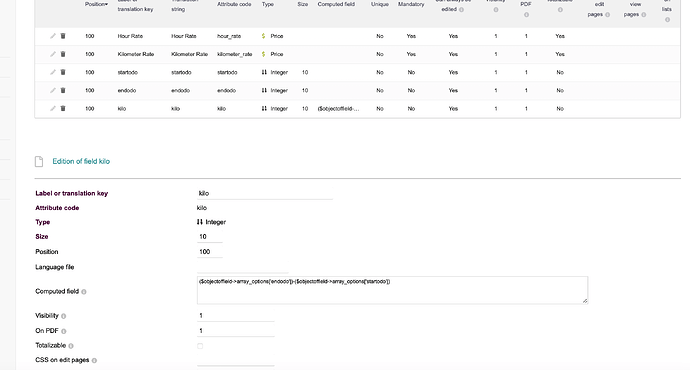

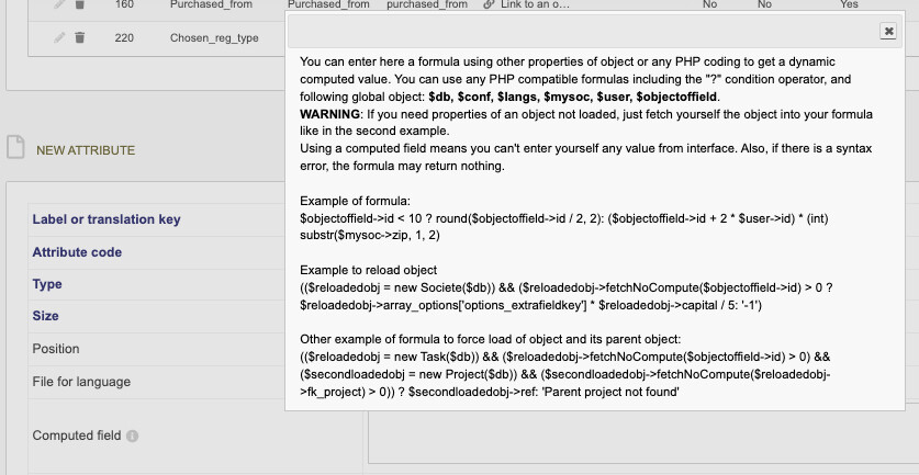

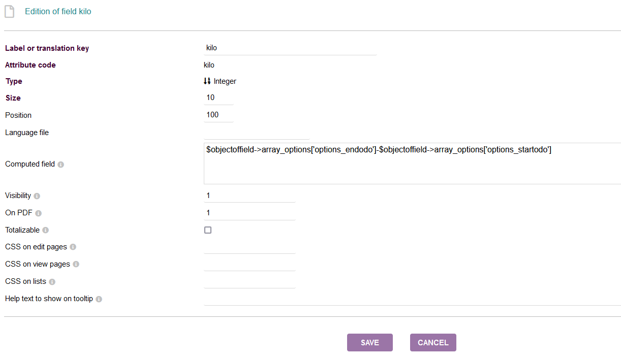

click the little i next to the text “Computed field”
yes i already tried many but failed if you give me one example how to make km calculation from endodo - startodo i can understand what i am missing
($objectoffield->array_options['endodo'])-($objectoffield->array_options['startodo'])

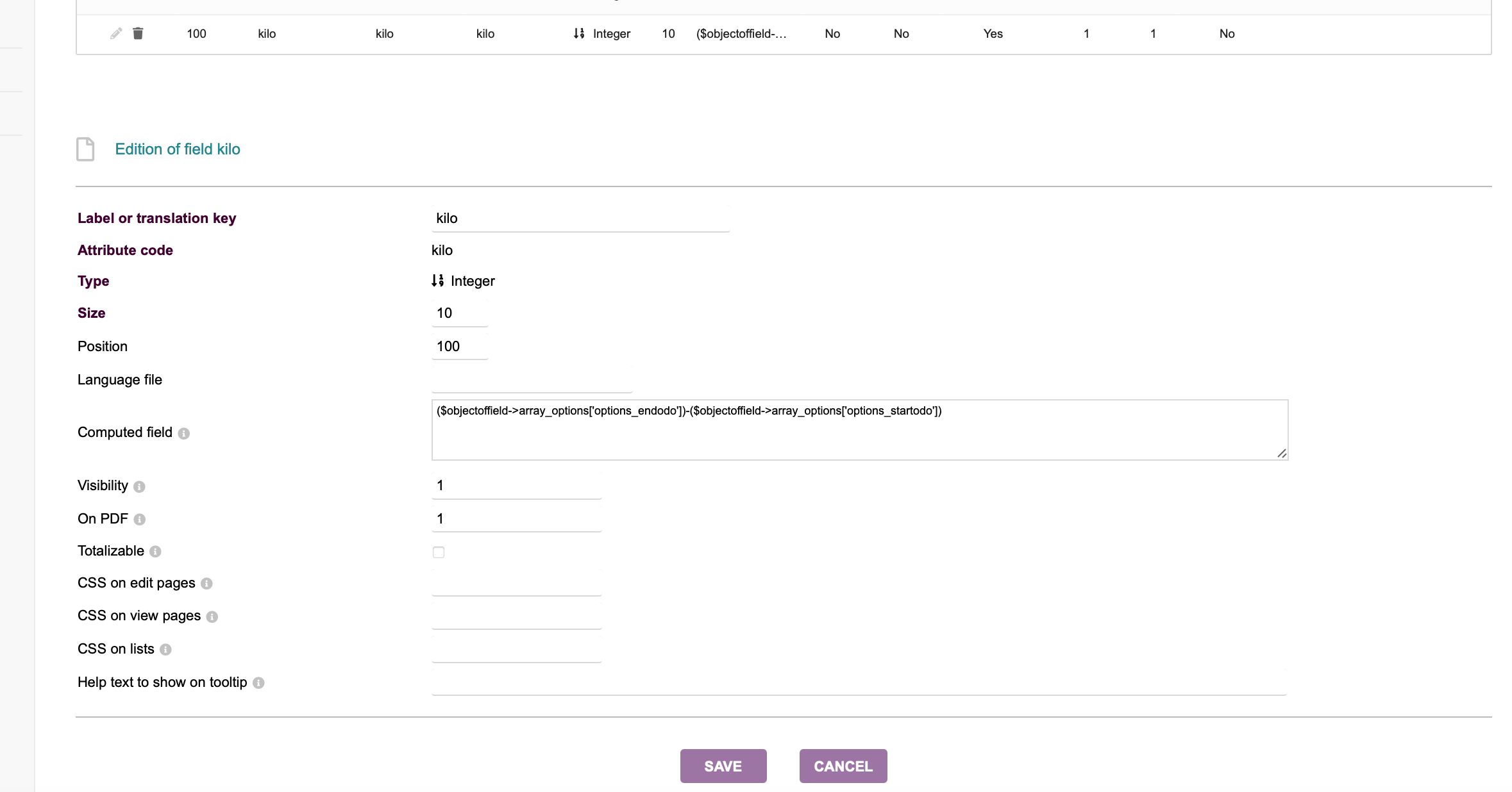

Hello ksar

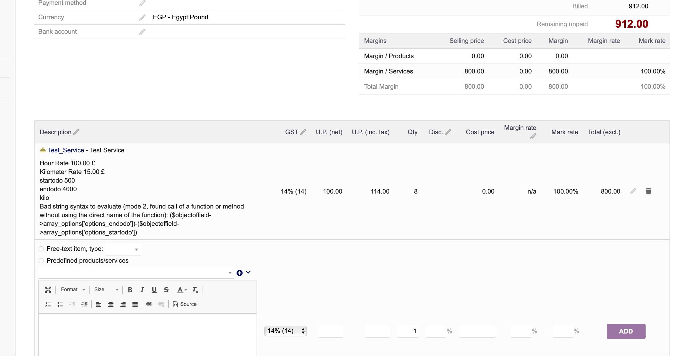

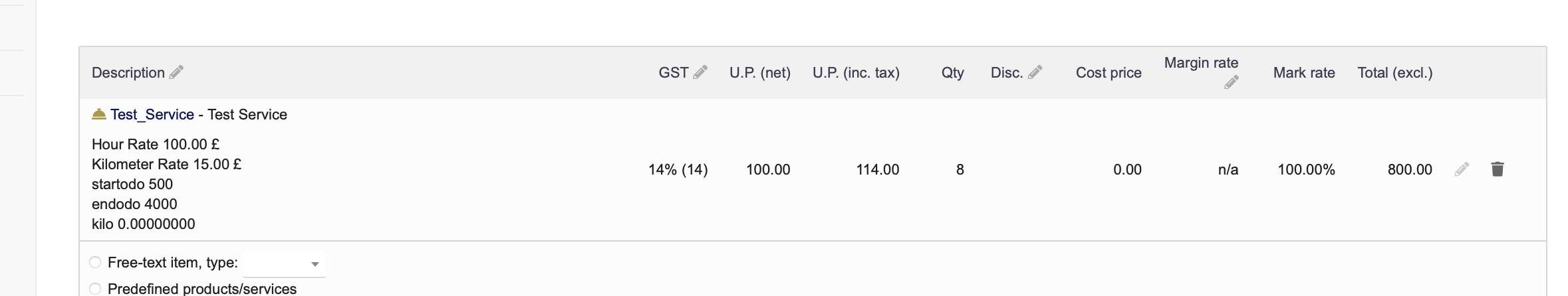

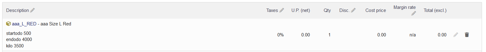

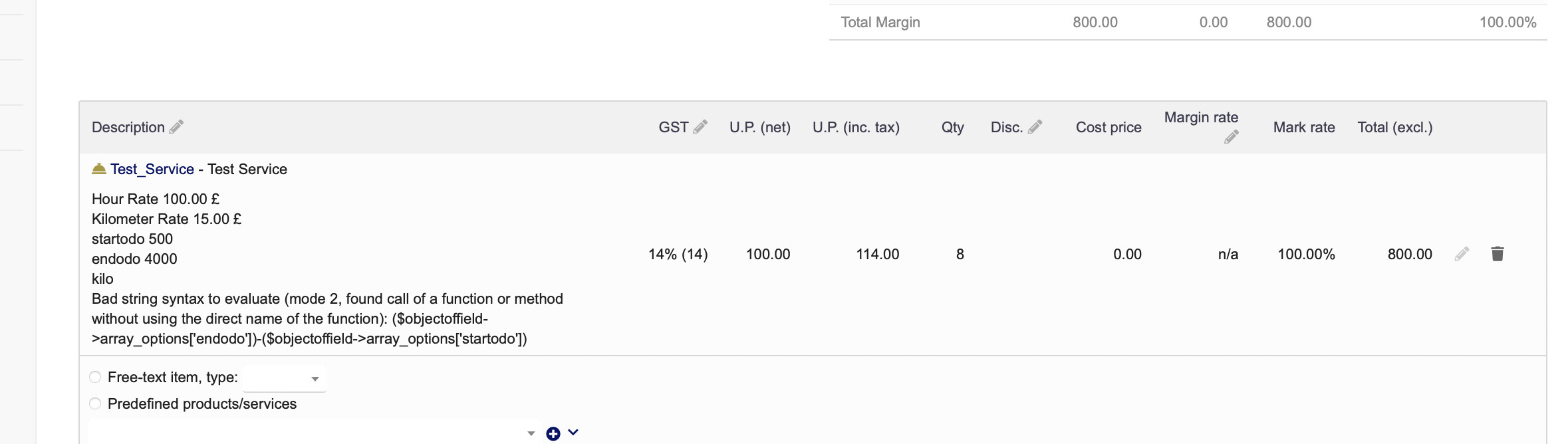

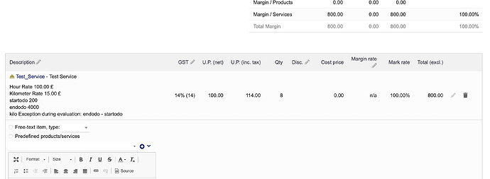

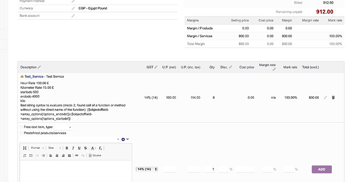

it’s not working as attached, after i changed kilo to float the error message gone but the result is 0
Yes sorry i was to quick :
($objectoffield->array_options['options_endodo'])-($objectoffield->array_options['options_startodo'])

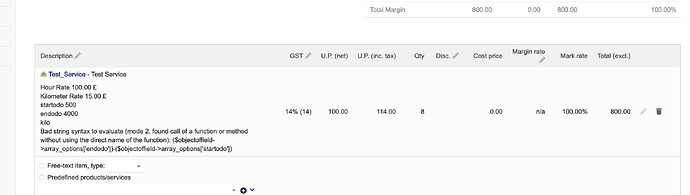

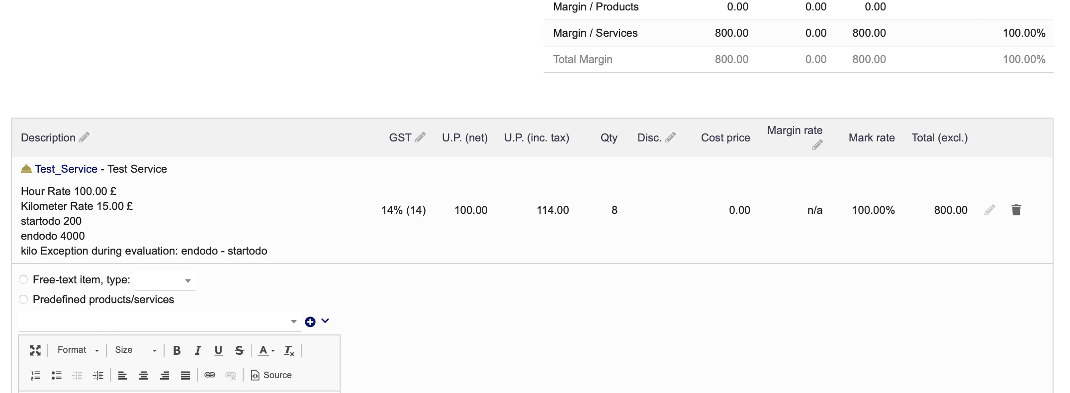

Hello, still not working
Seems that it doesn’t like the parenthesis
its working now thank you too much

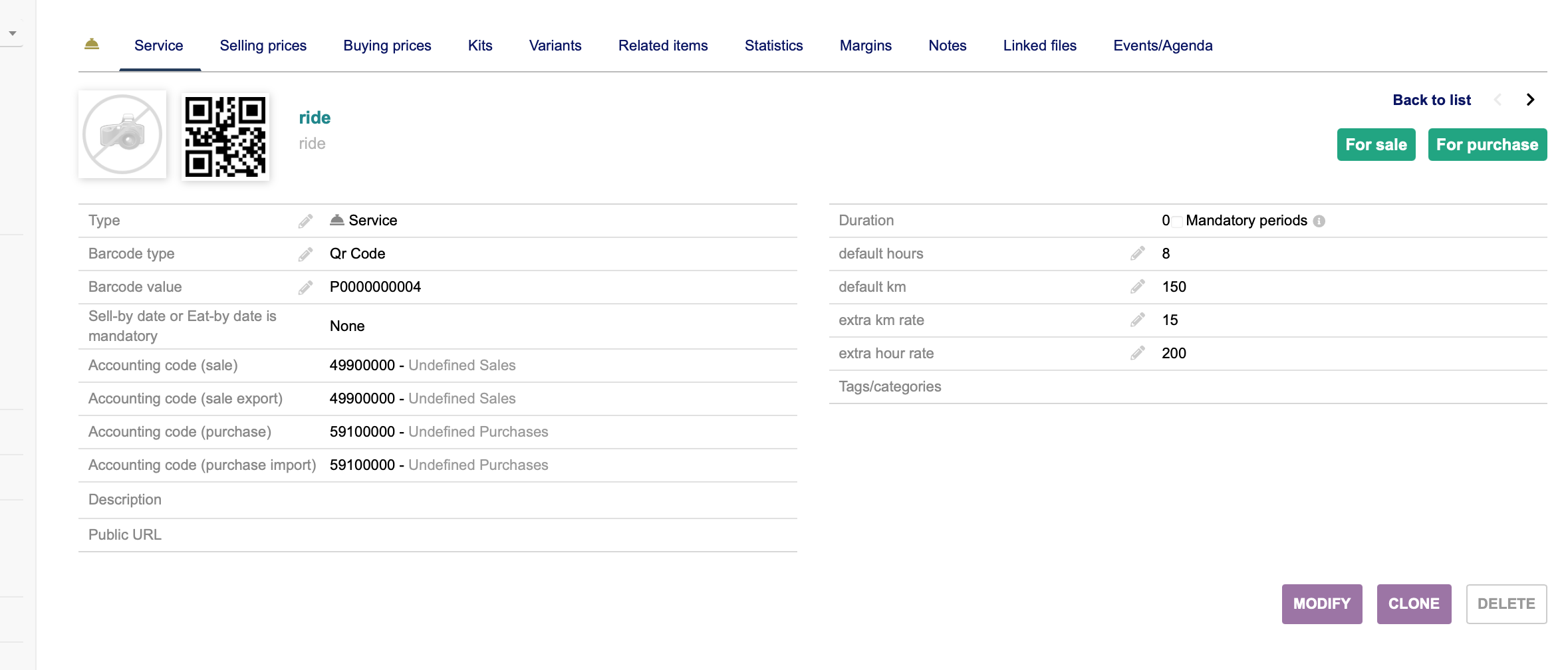

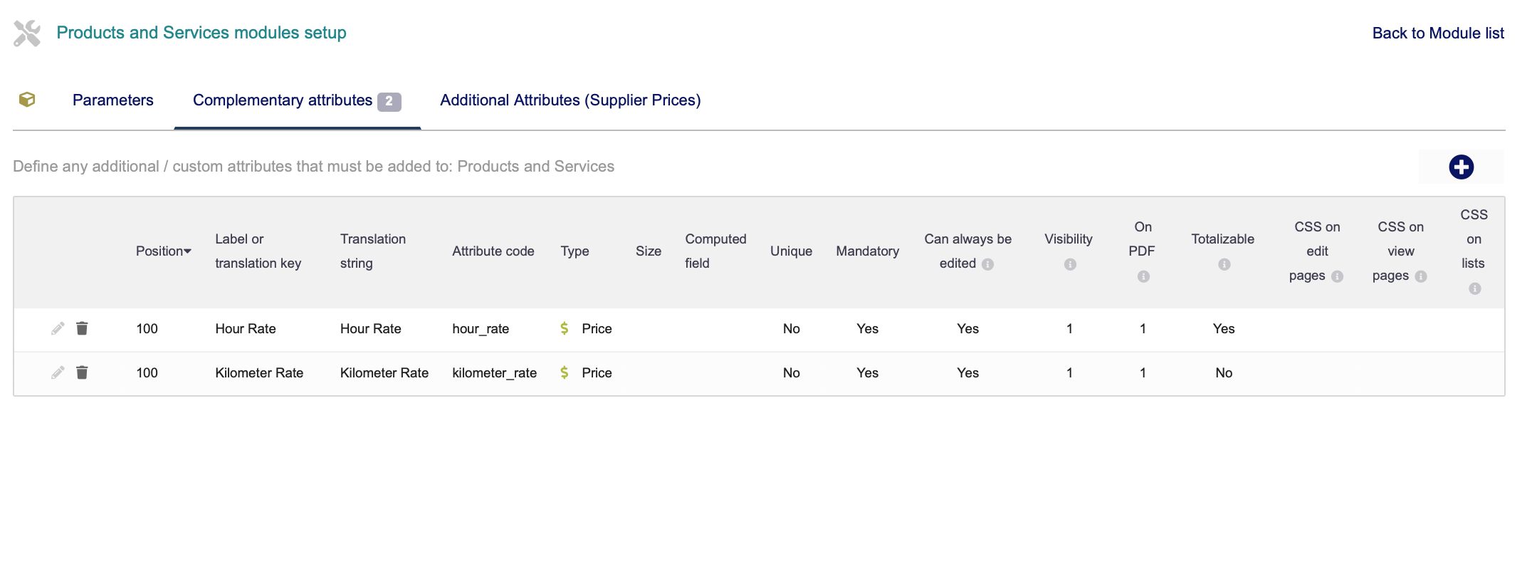

i added all needed attributes
now the major point

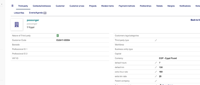

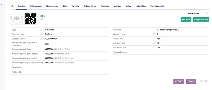

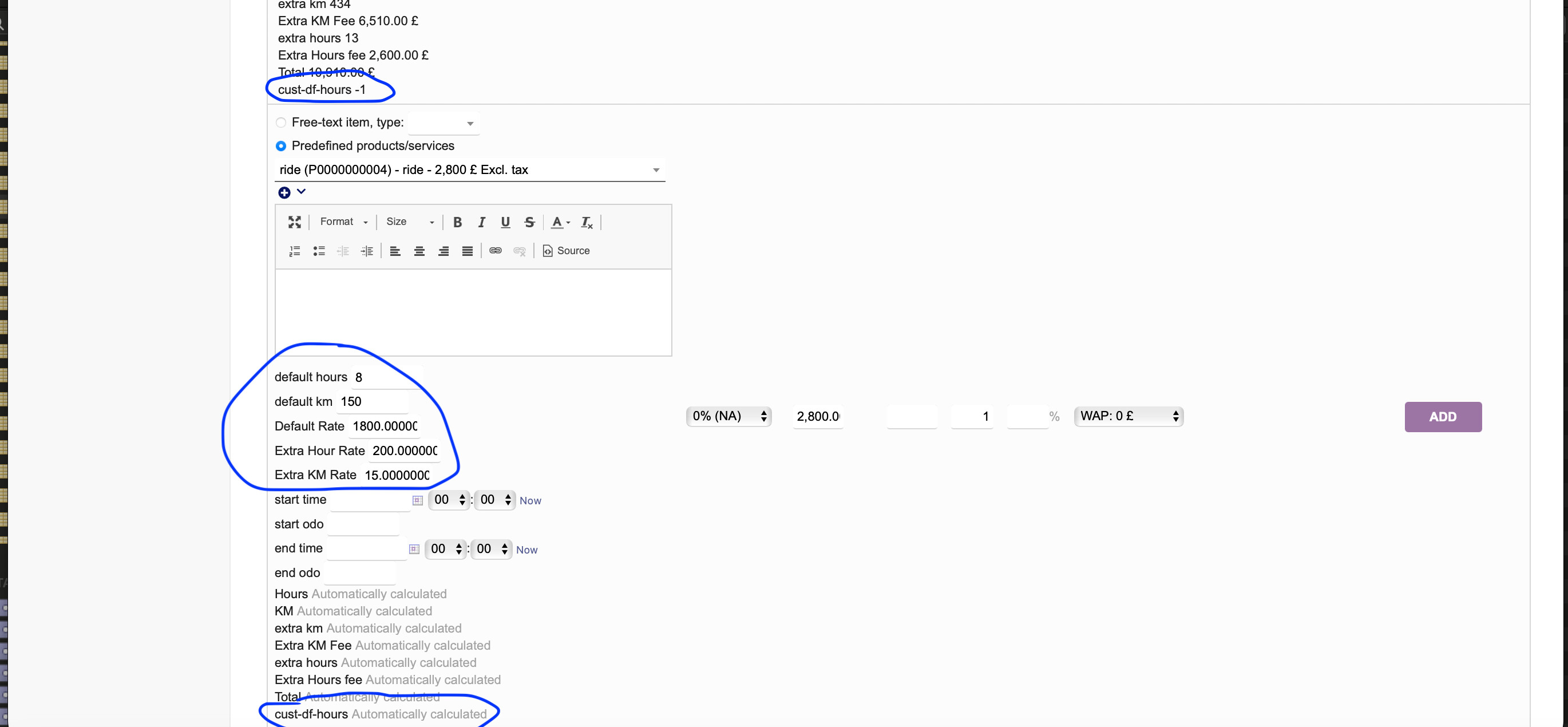

i created complementary attributes for service, third party and invoice
default hours, default km, extra hour rate, extra km rate
in service i set default hours to 8 hours, default km 150, extra hour rate 200, extra km rate 15, default price 2800

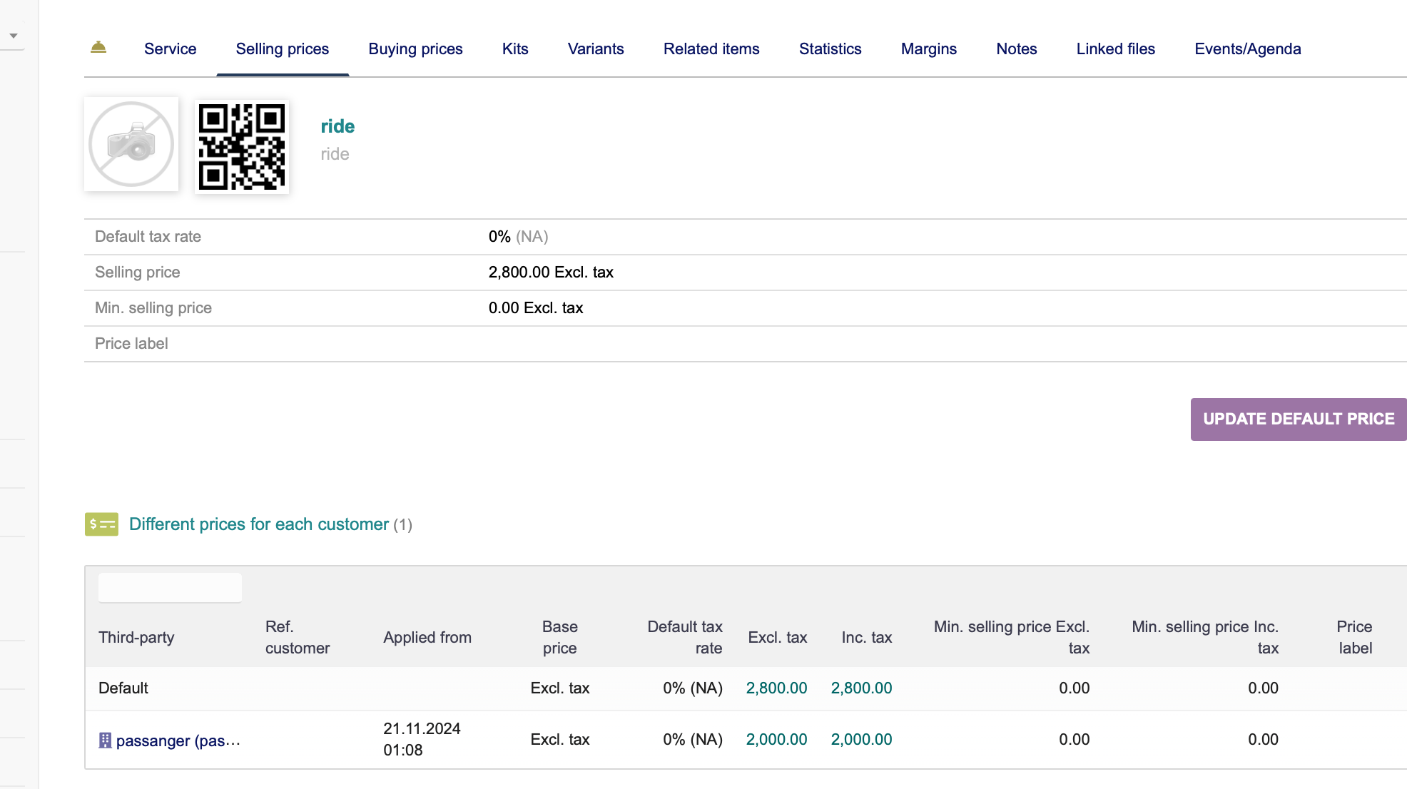

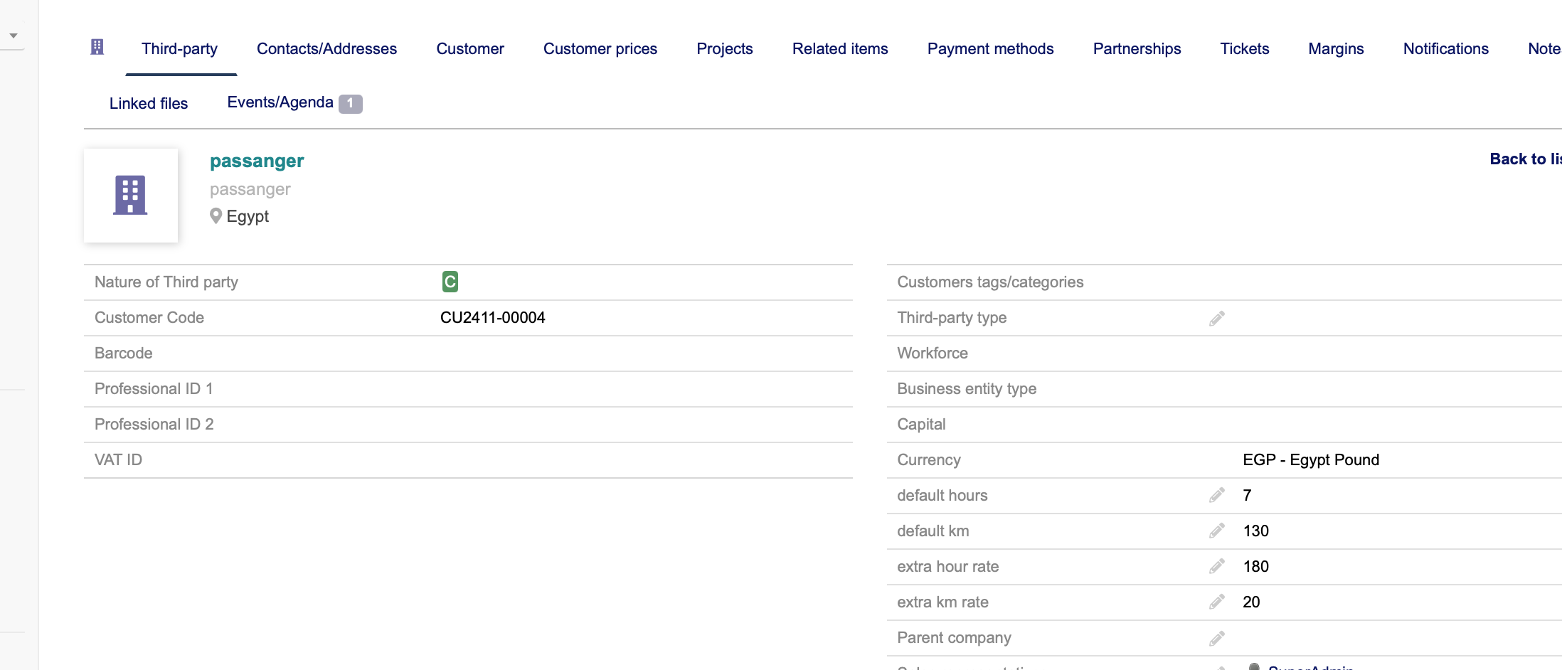

in third party i set default hours 7, default km 130, extra hour rate 180, extra km rate 20, customer price 2000
this to set basic price for the service and different price per customer

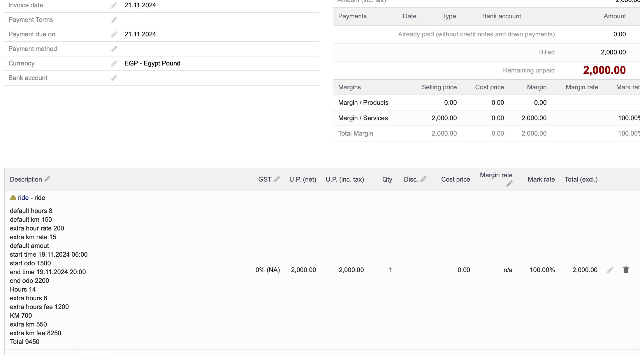

i created invoice for that customer and select the service
1- first note the service default attributes shown not the customer defaults except customer price (how to trigger customer default not the service default - as customer price not default price)
2- i need to get the customer price in the default amount attribute
3- i need the attribute total to jump into unit price net before tax
all results shown in pdf file attached, need to hide qty and change unit price net with total
please help with thanks
(PROV12).pdf (132.5 KB)
I think there is an option or module to get individual prices pr. customer
Should be possible with calculated field but will require some hours to find the good one, you can start with this exemple :
(($reloadedobj = new Societe($db)) && ($reloadedobj->fetchNoCompute($objectoffield->socid) > 0)) ? $reloadedobj->array_options['options_xxxxxxxxx'] : '-1'

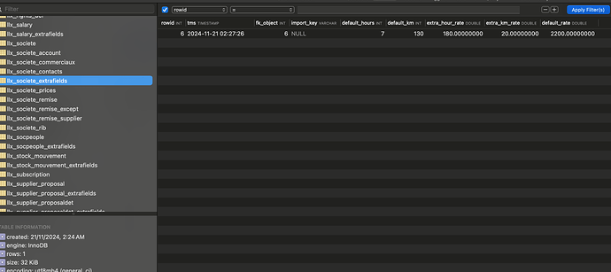

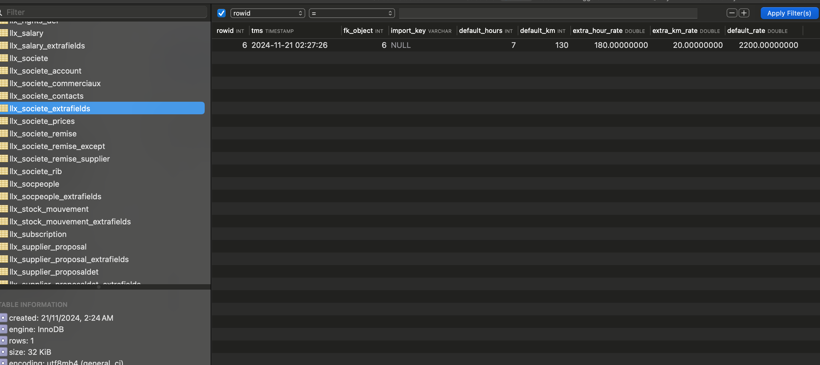

i am realy appreciate your kind help, attached the llx_societe_extrafields which i want to reload in the invoice you may give me one example for how to reload default_hours than i can follow for the rest and 90% of the problem solved
(($reloadedobj = new Societe($db)) && ($reloadedobj->fetchNoCompute($objectoffield->socid) > 0)) ? $reloadedobj->array_options['options_default_hours'] : '-1'
the result -1 something not work
but i need to this extrafield value from the customer attributes to load like default hours for the products not to be calculated (attached)
let explain again
the default hours, default km, etc preloaded in the pictures is the attributes from the product itself, i need to load these attributes from the customer attributes not from product attributes then i can go with the other calculations
