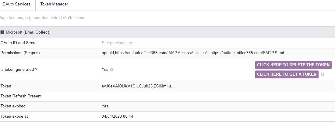

Thanks. I’m new to this so all input is good input. The token in Dolibarr does not renew itself, it lives 30 minuts and then I have to renew it manually. Shouldn’t there be a Cron of some kind? Pls see the picture below. I have to renew it manually by clicking on “Click here to get a token”
OK, it’s not 30 min, it is something else, et changes each time. Anyhow, how to make this run automatically?

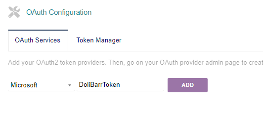

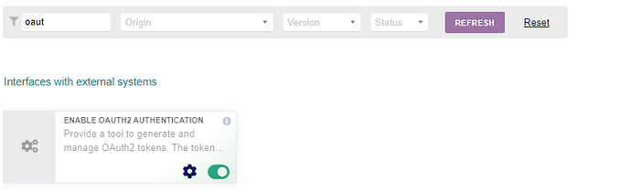

I start in Dolibarr (17.0.1). Pls follow the pictures

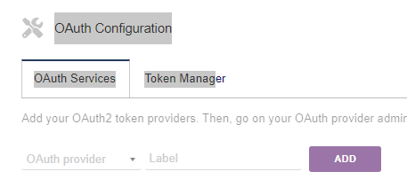

  1. On OAuth Provider chose Microsoft (for Azure)
  2. In Label, write something why not “DoliBarrToken”
“Add” then you have

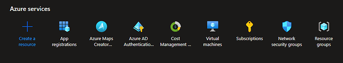

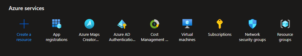

Azure

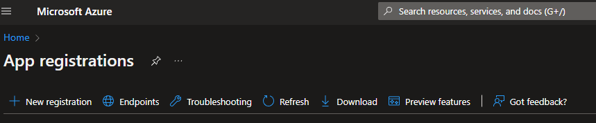

Chose “App registration”
Then “New registration”

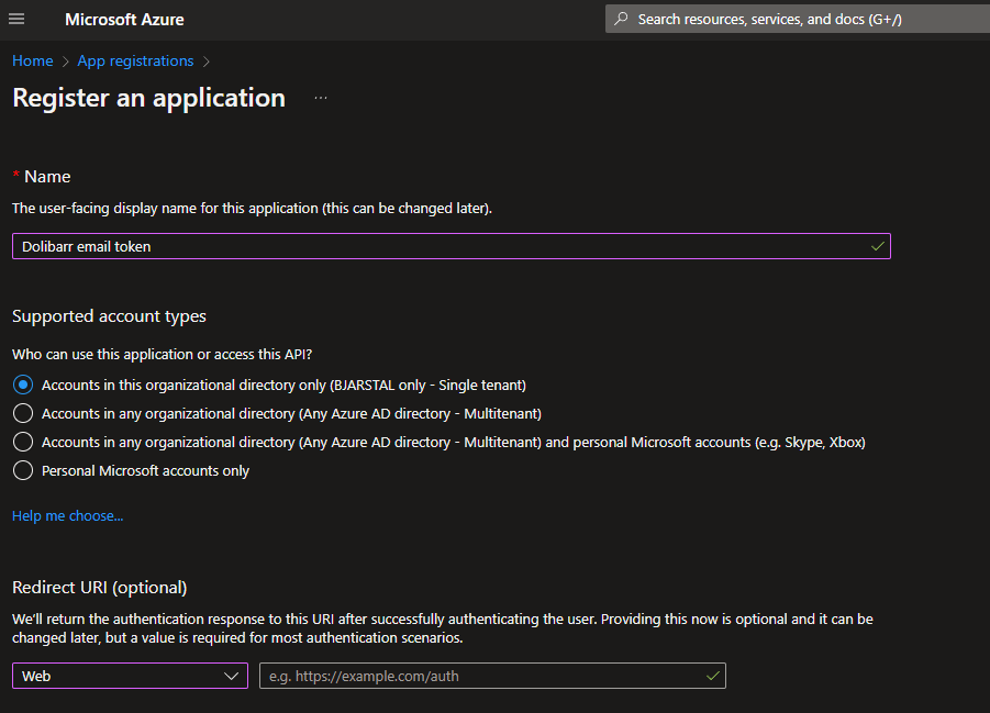

Then you will arrive to the below page. Write something in “Name” then you go down to “Redirect URL” chose “Web” and to the right you paste the string from Dolibarr OAuth config “Use the following URL as the Redirect URI when creating your credentials with your OAuth provider”
“Register”

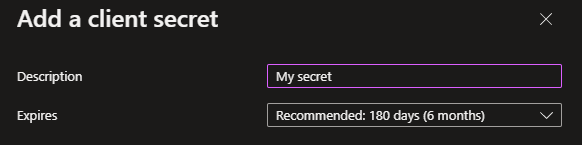

**then click on “New client secret” and on the right of the screen it pop up where you in Description writes something like “My secret”
go to the bottom and click on “Add” and you will see this

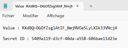

copy the values to Blocknotes (I will erase them later so no worry)

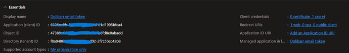

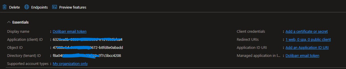

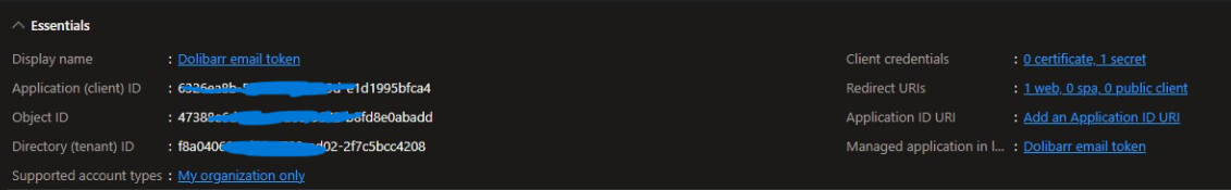

go back to the name you gave to the Token, (in my case “Dolibarr email token”) by clicking on it and you will arrive back to

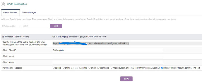

Then in Dolibarr OAuth Services

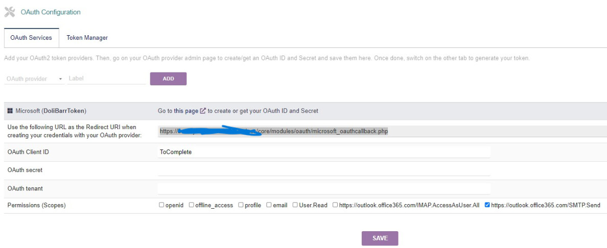

  1. Copy Application (client) ID to OAuth Client ID
  2. Copy Directory (tennant) ID to OAuth tennant
  3. Go to the stored value in Blocknotes and copy the Value to OAuth secret

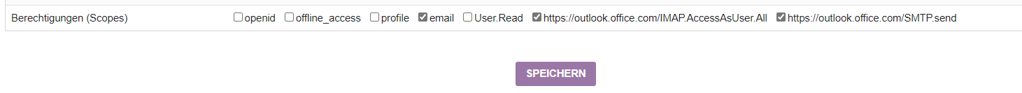

  4. in Permissions (Scopes) click the boxes you find suitable
  5. Click on Save and follow the instructions.

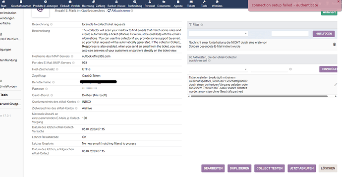

Then of course, in the email collector you have to do the right settings for Access type and so on.

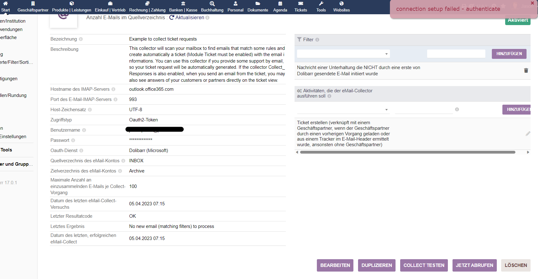

Great documentation, looks like mine, lets have a look in the e-mail collector, while testing i get an connection setup failed - authenticate error, my token is regenerating every 5 minutes, because my collector runs every 5 minutes, i do not need to do it manually, i tried all scopes, in another forum they told me to change the scopes from https://outlook.office365/IMAP.AccessAsUser.All to Sign in to Outlook
I tried with a nomber of diffrent Scopes, I don’t know what one is the right one, but it works for me but remeber that I don’t use it for collector, if it makes a difference.
My issue is as said, that the Token does not renew and I don’t understand how to make that happen.
My Connection setup failed - authenticate disappeared after i removed some scopes from the OAuth-Konfiguration -
The only problem that still exists, after finally receiving mails, they are not being moved to my existing archiv folder.

Now it works for me, it is renewing the token as it should. I found this page Setup EMails — Dolibarr ERP CRM Wiki and it seem to be that I had not checked the box for offline_access, just outlook.office365.com/IMAP.AccessAsUser.All
and
outlook.office365.com/SMTP.Send
Adding offline_access and then making a new connection with Azur, made the difference.
