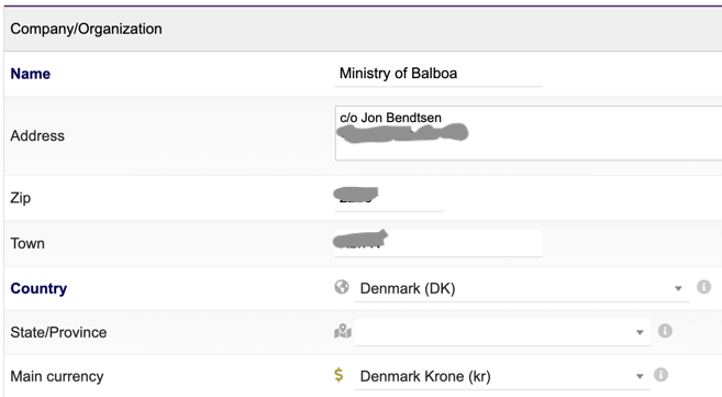

How the company configuration is made ?
I do not see any extra newlines in the company definition, and I also checked using arrow keys to move around in the boxes.

I’m using 1 big address field because I find it much easier for customers to fill out, and I don’t particular need to know where they are from, because I am using dolibarr to sell dance classes and workshops in our nonprofit, so we will never ship anything physical anyway. But we do need to know who our members and customers are.
Anyway, what I am seeing in the json for the address field is this:
"address": "Streetname\r\nPostal\r\nDenmark",
Notice all those \r and \n? Maybe I get an empty line because both the \r and \n are being translated to a newline?

Looking at the json from API → Setup → GET /setup/company I see \r\n.
“address”: “c/o Jon Bendtsen\r\nSTREETNAME”,
I used the GUI to create the address, I did not inject it using json.
I am using a mac to fill out my forms, maybe this injects a \r\n in the text field?
My iPhone does the same \r\n
My Android does the same \r\n
Maybe it’s a browser issue? I doubt that
Mac == Brave
iPhone == firefox
Android == Chromium
