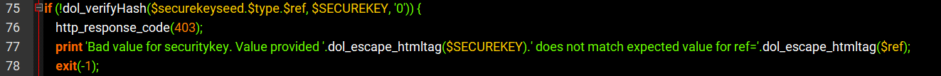

Try to replace the line into newonlinesign.php
if (!dol_verifyHash($securekeyseed.$type.$ref.$object->entity, $SECUREKEY, ‘0’)) {
into
if (!dol_verifyHash($securekeyseed.$type.$ref, $SECUREKEY, ‘0’)) {
and into signature.lib.php
$out .= ‘&securekey=’.dol_hash($securekeyseed.$type.$ref.$object->entity, ‘0’);
into
$out .= ‘&securekey=’.dol_hash($securekeyseed.$type.$ref, ‘0’);
This fix should be available with next v15.0.4 if it works for you…
