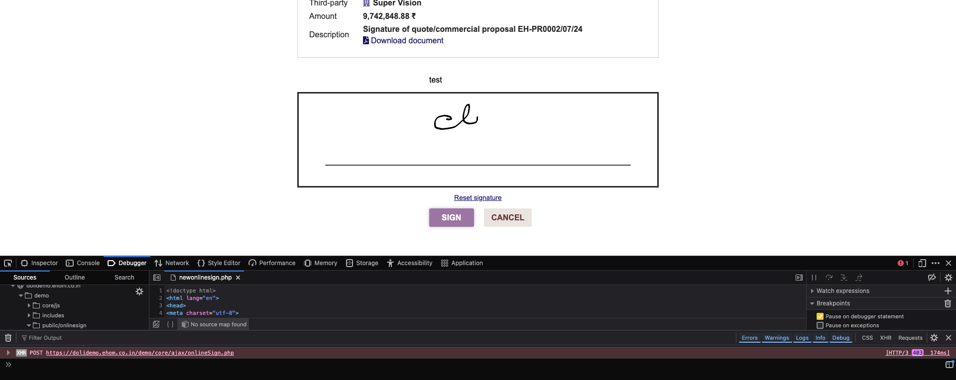

Also, I’m getting this error (browser pop-up dialogue box) when a customer tries to sign the document:
Error on calling the core/ajax/onlineSign.php. Bad value for securitykey. Value provided $2y$10$GKp/s1tumfv06lIIdMLP2.JkzdCYGtO.dD.RLU7u/j4xCoHnAuHny does not match expected value for ref=

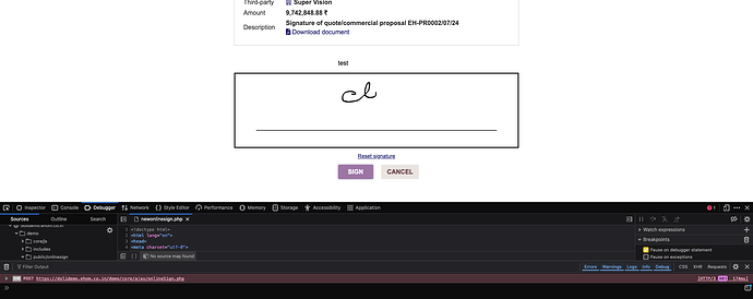

I don’t have a blank page, but as soon as I type in the last name, sign and press the accept proposal button. I get an hourglass, and it keeps spinning for a very long time. I have waited for a few hours with no further response.
Initially, when I had setup Dolibarr 19.0.2 it was working fine, no problem at all. It suddenly started acting weird.
Where can I find error.log file?

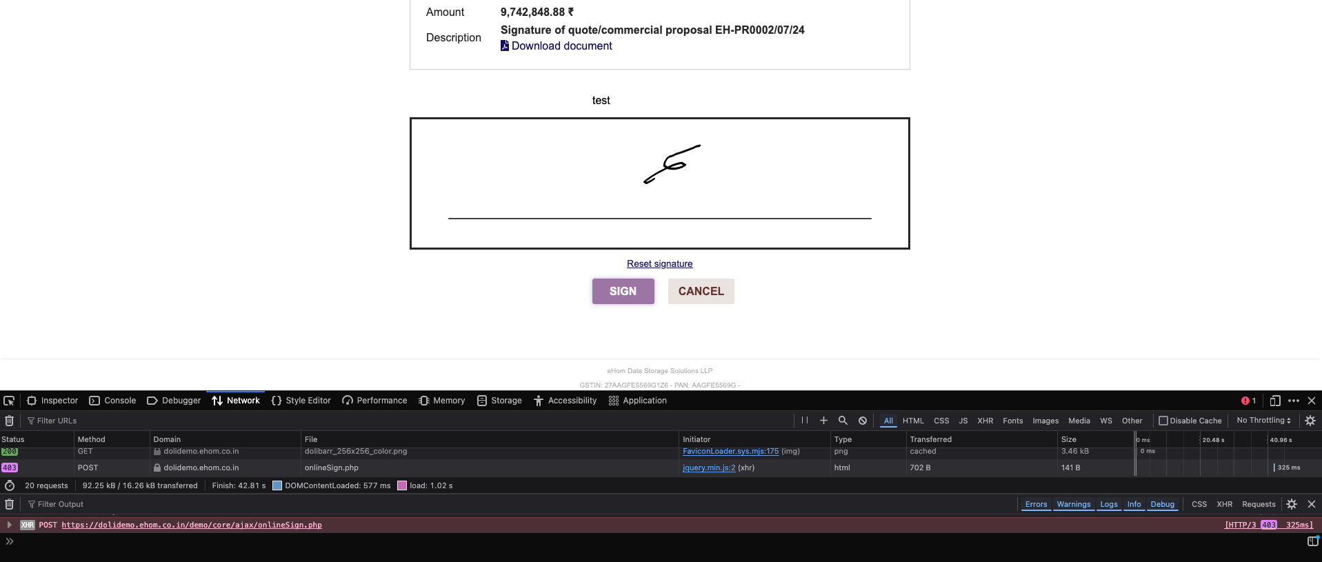

So if it is a long wait, no need for the error log. A better way to diagnose is to open the web browser console. And check if you have console error when you press the sign button.
You can also read the tab “Network” and click on the line of the page to see what is the payload content sent when you click…
