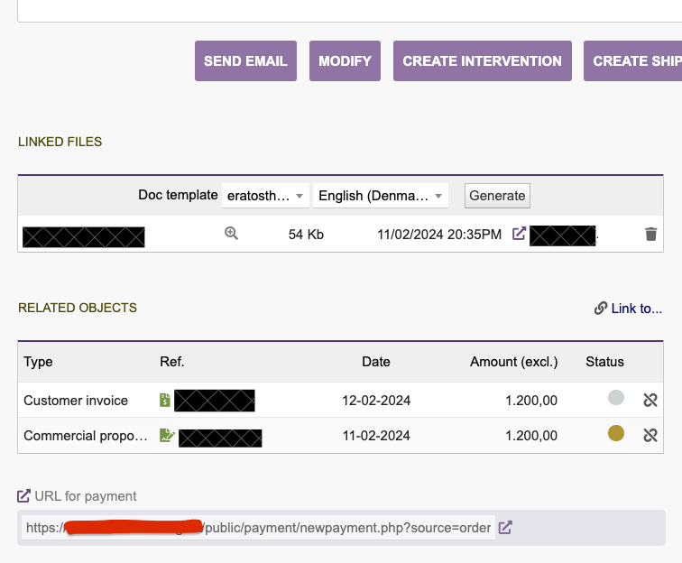

@ksar is correct, webshop receives order from user basket, customer pays then order turns to invoice.
yes it is quite immediately, but in Dolibarr it is also not the opposite.
In the bottom of this order you can see the online payment link. Yes this order is paid, but it was paid 1 day after the order was generated from the proposal. ( i have some with more time between order validated and invoice generated at payment, but I can’t find them right now).

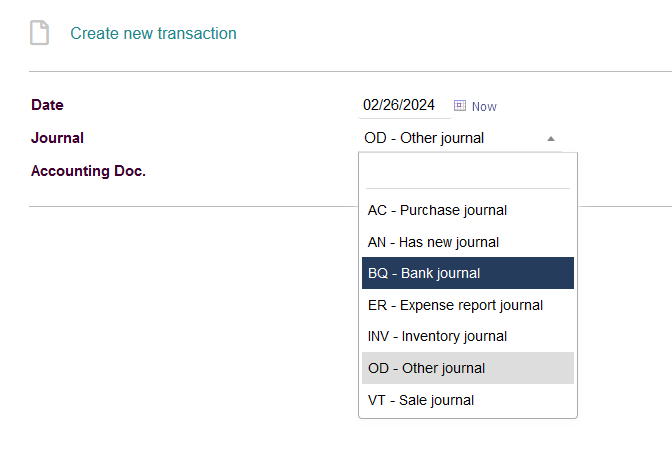

In accounting you can put some of these in OD journal :
But you can’t link them to a purchase or an order.
