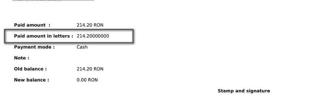

  2. On the receipt there is no text on the paid amount in letter row. I tried in EN, FR, RO, the same situation.2-a. Your answer: I only provided translations for French, Spanish and English. You should create your romanian translation file for yourself if English is not useful. 2-b Result: I didn’t asked you about any translation, the problem is that there is still no text on the paid amount in letter row!!! Not in English, Not in French and so on.

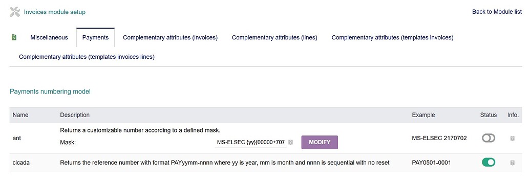

  3. In Dolibarr - Setup - Modules - Invoices - Payments - Payments numbering model is blocked. I can not activate “ant” for custom numbering or deactivate “cicada” for the standard Dolibarr numbering. 4-a. Your answer: You should hover the interrogation mark with you mouse to get complete information on how to build numbering masks that is also valid for any other Dolibarr object. You should try the examples given such as ABC{yy}{mm}-{00000}. 4-b Result: The Payments numbering model is BLOCKED since I installed your module. I CAN NOT activate for custom numbering. As you can see on the printsceen I do know how to set up custom numbering.
