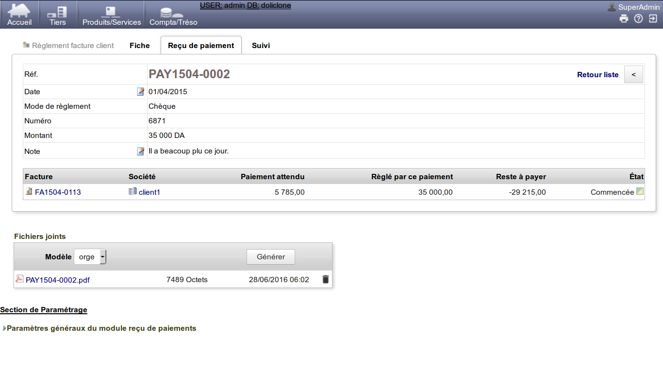

Payment Receipt : with document model
I announce the release of the “Payment Receipt” module that adds a tab to payments editing pages.
This tab is similar to the main payment page but integrates an extra section for generating the PDF of payment receipt.
This document includes fields to be signed by the recipient of the payment to be used as proof of payment.
Like all modules of Dolipar, this module includes a parameterizing section that includes so far only one parameter to display the document in the browser without the need to download it.

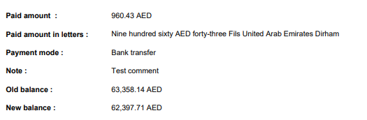

attached in the picture link, the CUrrency is showing twice before the Decimals and after even i did change the numberwords module to show symbol and not to show symbol still shows twice the Currency before and after the decimals.

Hello Again, i have sent already picture image it is showing AED and United Arab Emirates Dirham so it has Currency mentioned Twice as Symbol and in words. AED(Symbol) United Arab Emirates Dirham(in Words)

Hi AbuSamra,
Thank you for your message. I am sorry to take so long to answer.
I have corrected the bug. You can download the new version from Dolistore.

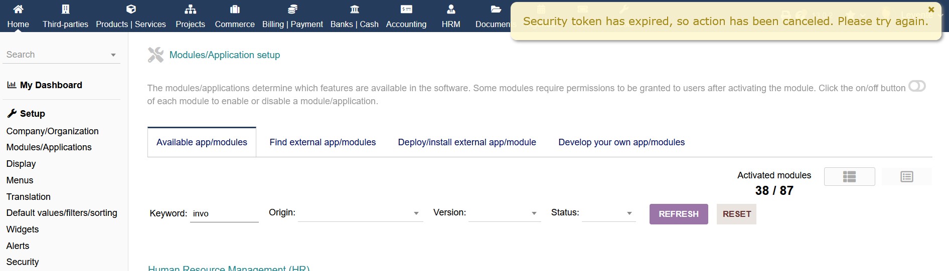

Hello!

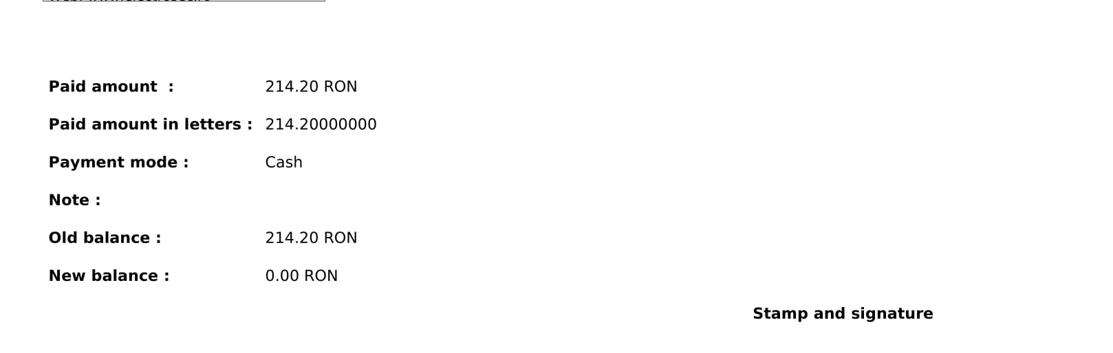

I bought the Payment receipt module on the 28th of April. I have some problems and since I didn’t receive any answer from the author, I post my problems here also, hoping for some answer.

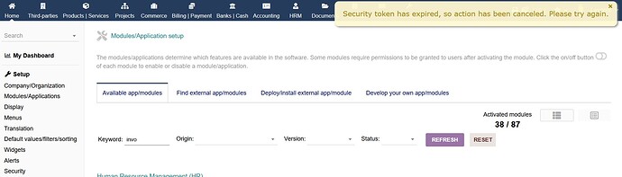

  1. since I installed the module I can not activate/ deactivate (start/stop) any module, not even Payment receipt module. The error message is “Security token has expired…” Print screen attached;

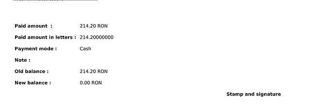

  2. On the receipt there is no text on the paid amount in letter row. I tried in EN, FR, RO, the same situation.

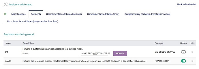

  4. In Dolibarr - Setup - Modules - Invoices - Payments - Payments numbering model is blocked. I can not activate “ant” for custom numbering or deactivate “cicada” for the standard Dolibarr numbering.

  1. The “Security token has expired” message is due to a bug on the version 13 of Dolibarr, it appears when you try to search or activate any module. To fix it, you should put the $dolibarr_nocsrfcheck=‘1’ in conf.php and set the constant MAIN_FEATURES_LEVEL to a value< 2 in home>setup>Other setup
  2. I only provided translations for French, Spanish and English. You should create your romanian translation file for yourself if English is not useful.

4-You should hover the interrogation mark with you mouse to get complete information on how to build numbering masks that is also valid for any other Dolibarr object. You should try the examples given such as ABC{yy}{mm}-{00000}.
