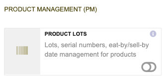

I want to trace every product that is received in my warehouse by a unique serial number so i turned on the module for lot/serial numbers in my 21.x installation.
However, my products come in shipping containers in lots. so i need an additional field to store the lot number. again, the products are boxed so i want to be able to store the box numbers as well.
