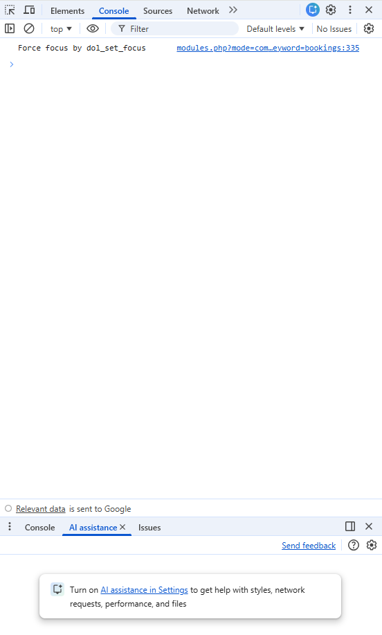

Would you please check the server log and the console of your browser.
That should give at least an indication what is wrong.

I will suggest you check the Dolibarr log once, and also the php error log. Also, try to enable the custom module from the module builder screen. Then check what is happening.

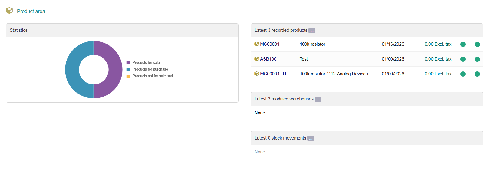

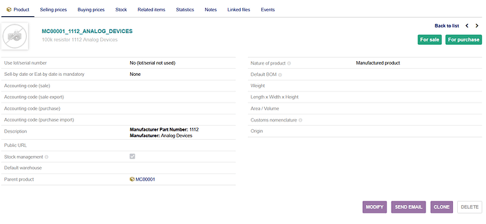

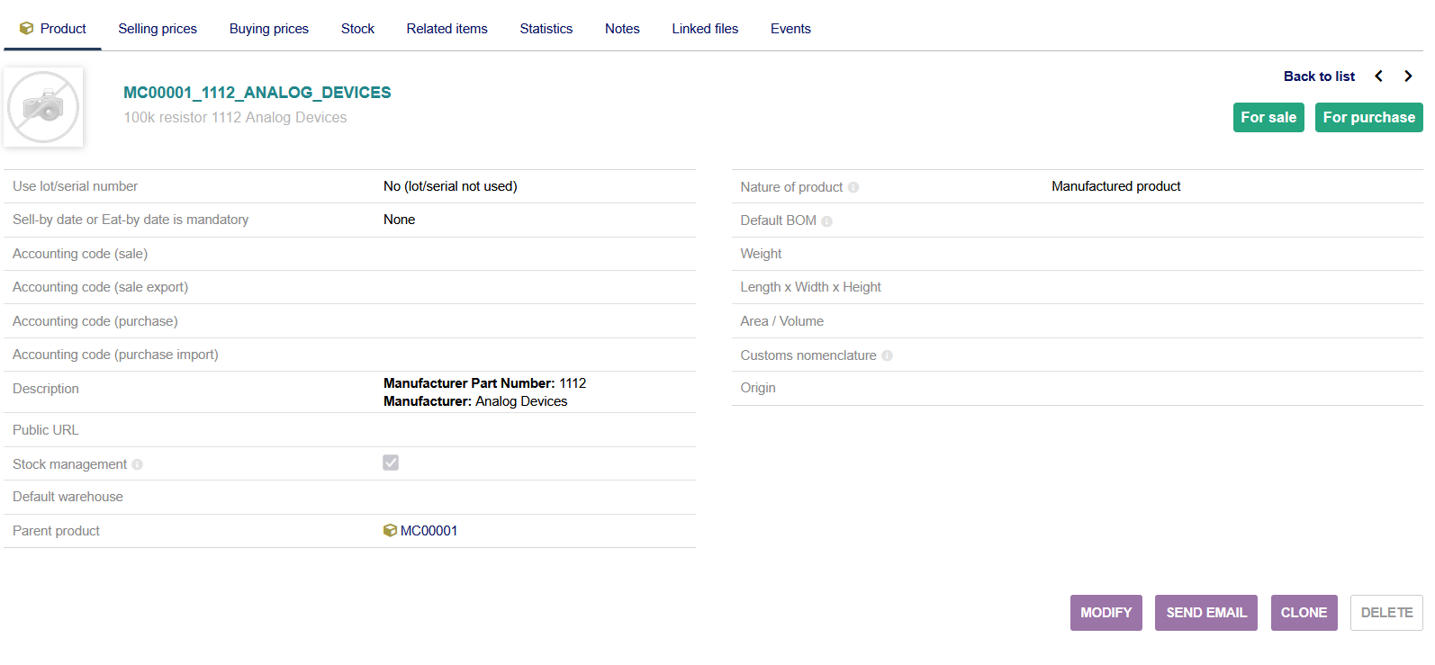

I looked into the idea proposed and it might be workable. The product tab looks acceptable with the part and its variants, but I do not like that it creates a separate product page for each variant as shown below.
For me each variant is the same parent part number. The variant would be equivalent parts. I also don’t particularly like how it affects the right hand side of the main products page.
I am not sure how I will be able to part search at this time, but I have not investigated this as of yet. I don’t know why the product page doesn’t contain a manufacturer and manufacturer part number entries available.
