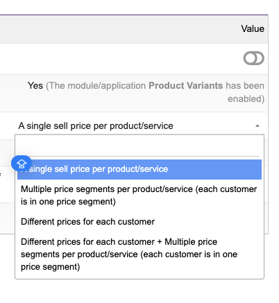

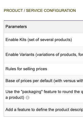

I think you can do individual prices, but I don’t use it
select rules for selling prices and you get the first drop down picture.
