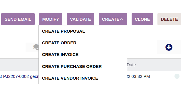

After you have activated projects in Dolibarr and created a project, you have the opportunity to create suppliers as well customer invoices
Schermafdruk van 2024-07-21 09-39-38
to the same project.

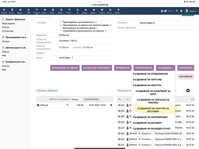

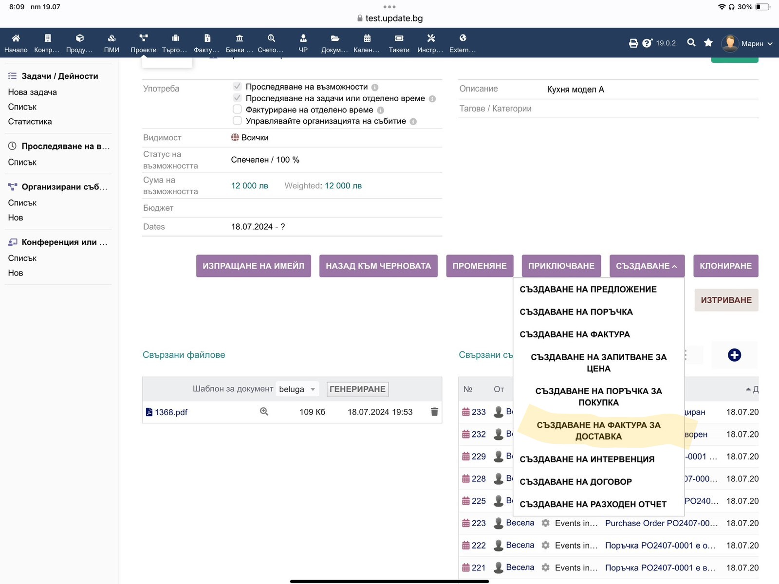

Thank you. I’ll check if this is added in our version’s drop down menu.
This option is nested in our drop down menu. When trying to create vendor invoices we are limited to create only to the contragent of the project which is the customer.
