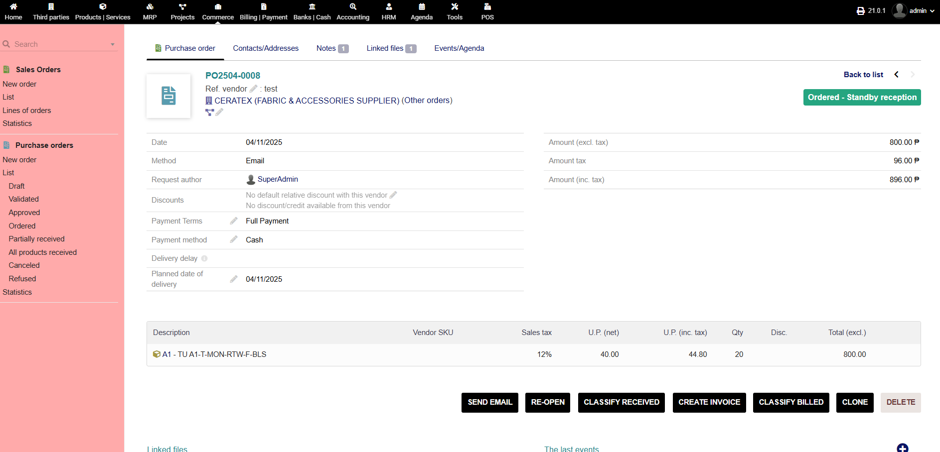

Give an idea to the reader of the "current’’ scenario of what I did.
  1. VENDOR PROPSAL, reached Status = Accepted
  2. PURCHASE ORDER, reached Status = Approved
    then Next Step I did was to MAKE ORDER
  3. PURCHASE ORDER, reached Status = Ordered - Standby reception
    no change of buttons for create reception either.
Did I miss any configuration or activation that should trigger the change of button or to at least “unhide” the create reception button?

  1. no new button of reception button appeared
  2. no button that it’s name to “create reception”
Appreciate for anyone that can shed light on this. Thanks in Advance!
Thanks @Wiz this was able to unhide “Create Reception” that I was looking for.
Now I was able to do
  1. Create Reception and Validate Reception as received.
  2. Make Stock movement and deliver it to my Target Warehouse
  3. Validated, after Validated of reception and made Stock movement the function worked and it added Physical Stocks onto my warehouse.
Thanks again!!
