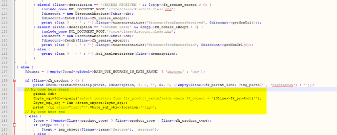

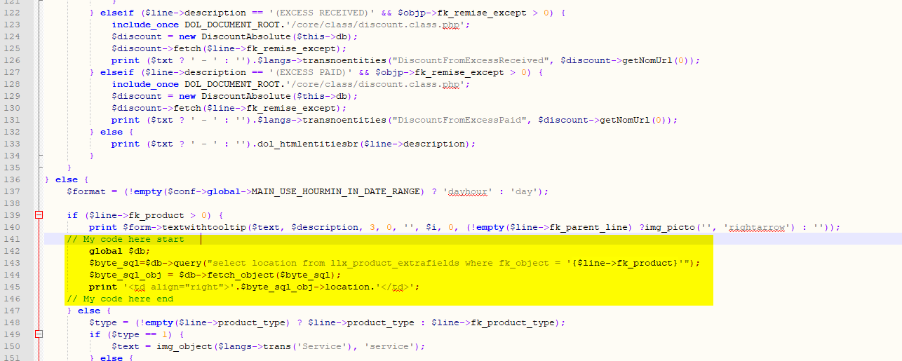

  1. In this file dolibarr\htdocs\core\tpl\objectline_title.tpl.php I want to add this piece of code colored in yellow

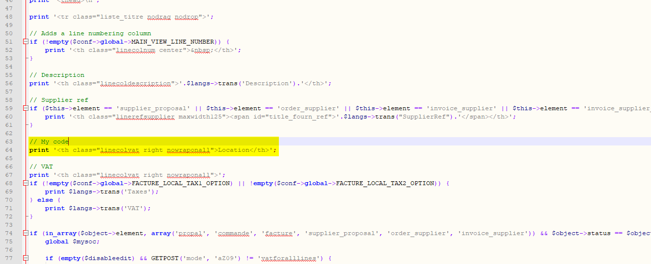

  1. In this file dolibarr\htdocs\core\tpl\objectline_view.tpl.php I want to add this piece of code colored in yellow
But I do not want to add these changes directly in these two files, because after the next upgrade these changes will be lost.
In some cms system there is tool which tool can search a certain phrase in a certain file and then an additional code can be added before or after that phrase. Or replace that phrase with new one.
But in dolibarr there is no such option, that’s why I am begging for help how can I achieve this.

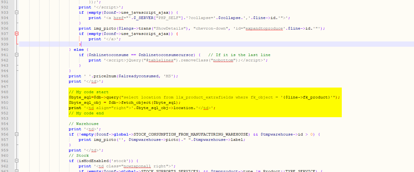

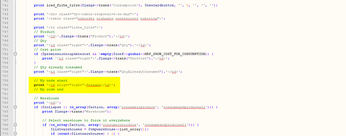

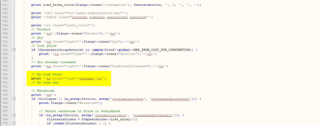

I want to insert a couple of lines of code at two places.
Is there an option to replace php core files, similar to replacing tpl files?
Also, in this file there is hook execution at 3 places, but I am afraid that they do not apply to this part of the code that I want to change.
Can you help, please
No, for core module, you have to use triggers or hooks.
