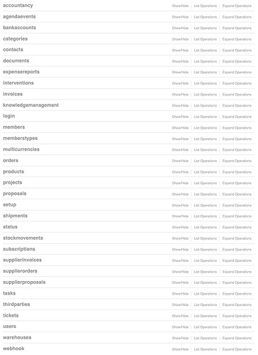

I’ve used the API quite a bit, but I never used the accounting API. Looking at it, I think you will be disappointed :-/

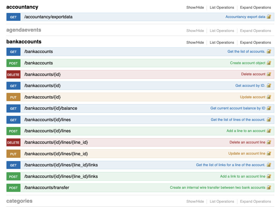

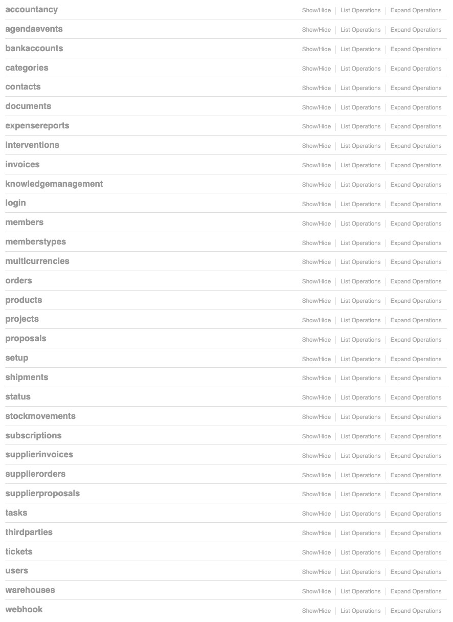

This picture below are all the API endpoints in my Dolibarr 21.0.1 and it depends on which modules I have enabled.
Clicking on the GET in the API Explorer will unfold to this picture - the others will also unfold - and to fold just click the same again.
IF you don’t find all the API endpoints you need - I didn’t - then it is not too hard to make them yourself. I’ve made quite a few contributions to expand Dolibarrs API endpoints

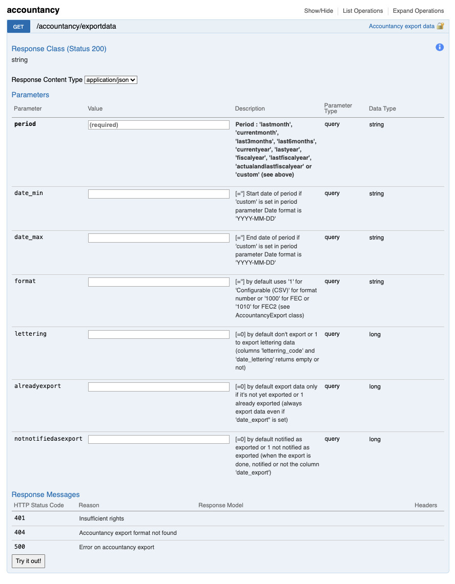

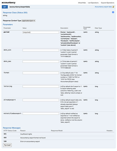

JonSweet16:dolibarr jonbendtsen$ find htdocs/ -type f -iname *api* | grep -i account
htdocs/accountancy/class/api_accountancy.class.php
htdocs/compta/bank/class/api_bankaccounts.class.php
Thank you so much. I think the only real API exposure related to accounting is Exporting accounting data.
Some indirect exposure through invoices, payments, and thirdparties, which can feed into accounting modules that i can apply for my system.
