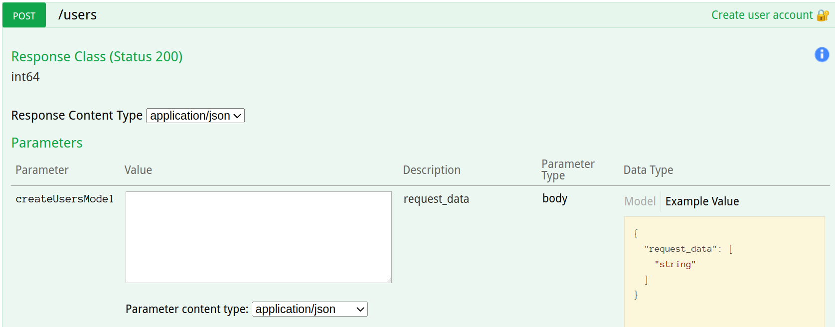

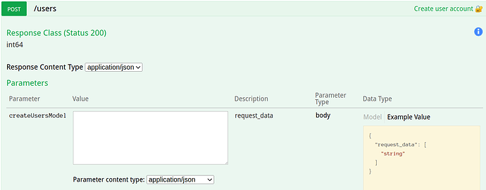

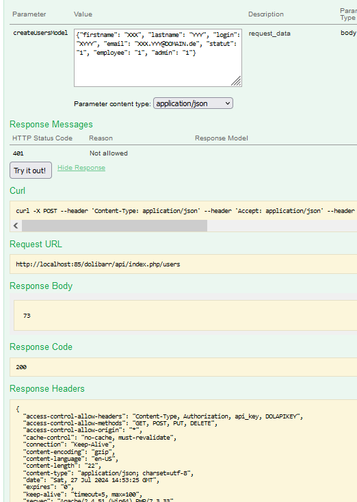

Here a screenshot from the Swagger UI
→ user “XYYY” is successfully created
OMG, i spent so much time on this!!! THANK YOU!!!
The problem was that in my API explorer i got this:
