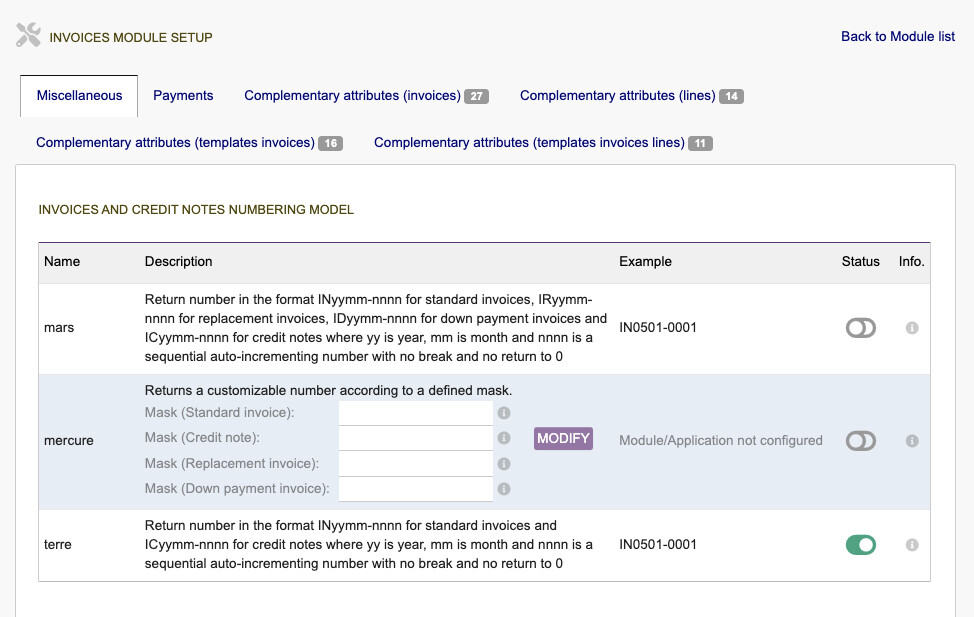

Please look for the invoice module under the setup, modules/applications. inside there you can change the numbering system
how to configure i
my requiremt is
ist set starting from FA and oyher starts from IN
This is my configuration of invoice module. I have not tried any of the others because I don’t need another invoice numbering system, but I am thinking that maybe the one in the middle can do what you wish for?
