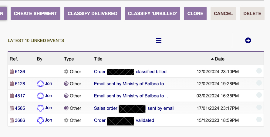

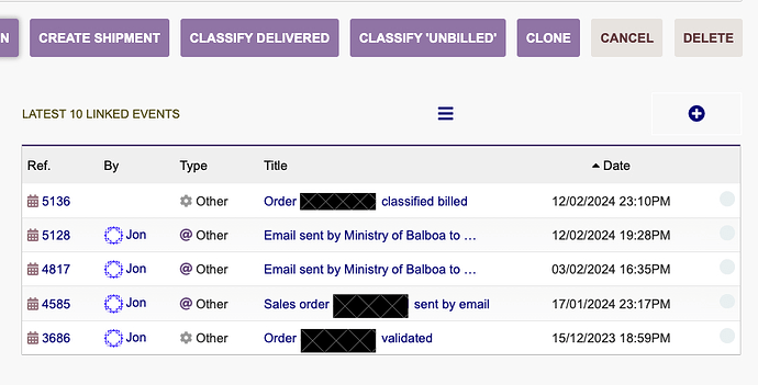

You can see some information if MANUALLY sent in the invoice/order/proposal events.
This is in the bottom right of the Sales Order page for any given order. I would expect the same to be present for invoices, proposals, …
