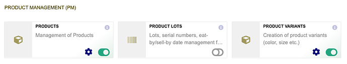

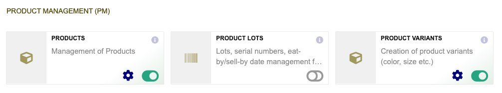

Did you enable product lots? (As you can see I am not using it so maybe what I suggest will not work)

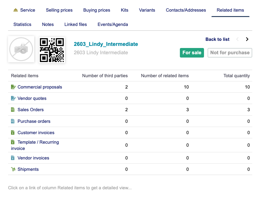

If i look under products, and a specific product, I can see related items like proposals, orders and invoices.
Maybe the same works for Product Lots - just a lot more detailed?

It is enabled. But not help me more. The way that a product come connected with a customer is invoice, order etc. But in my case, the customer has allread the product. I am only servicing and not selling.

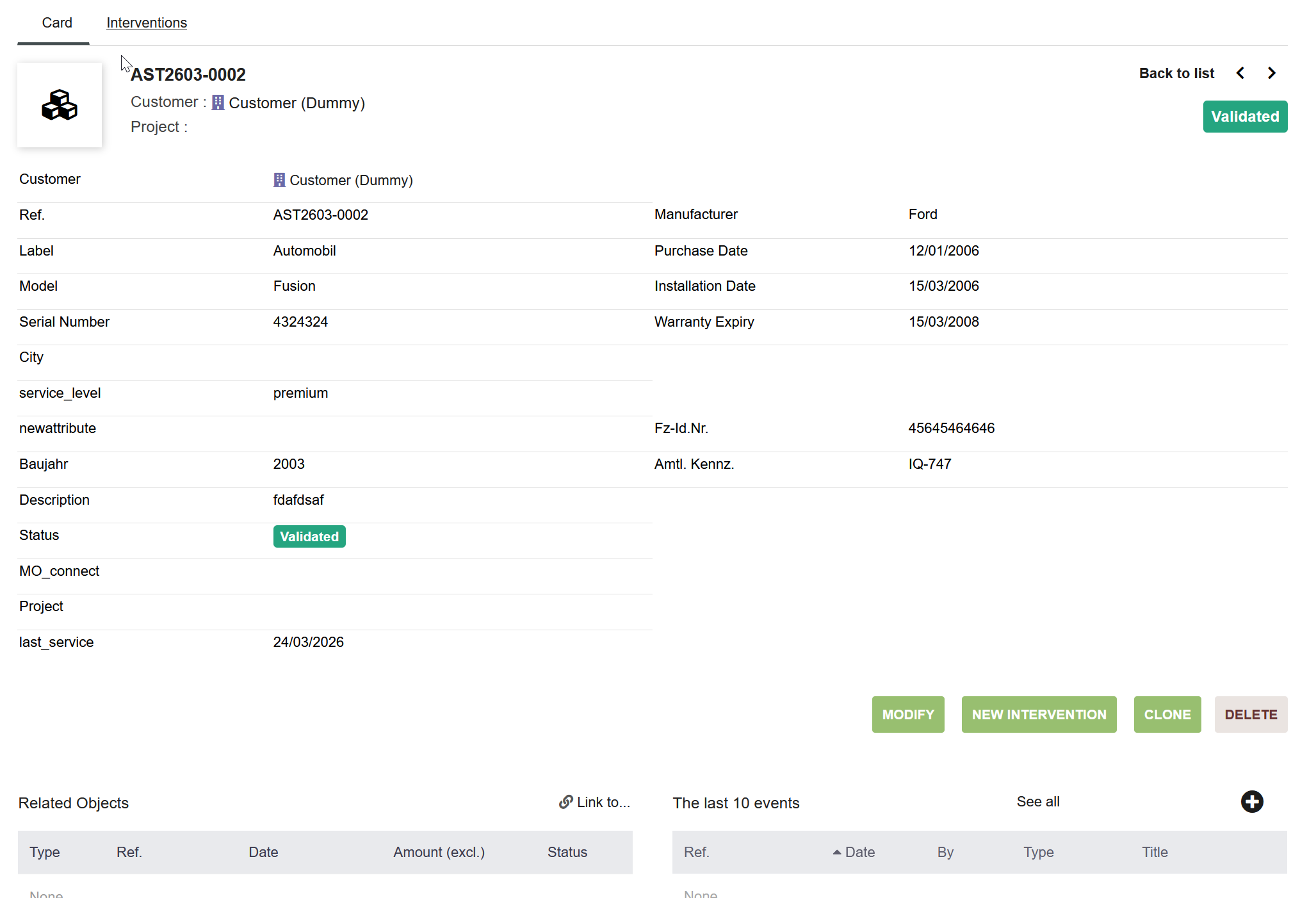

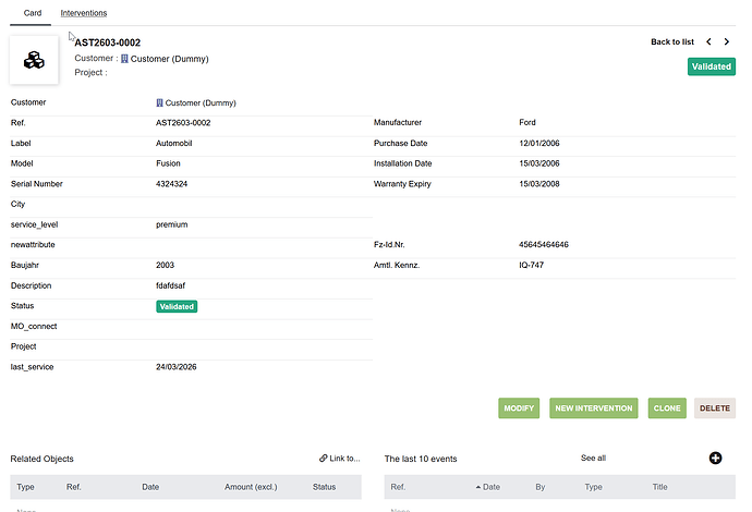

Did this to enter any kind of Equipment, having the option to connect to Projects, Customers, existing serial no.
As you see it links also to Interventions module. With in the third party section you have the tab “Assets” with a list of Equipment for each specific customer.

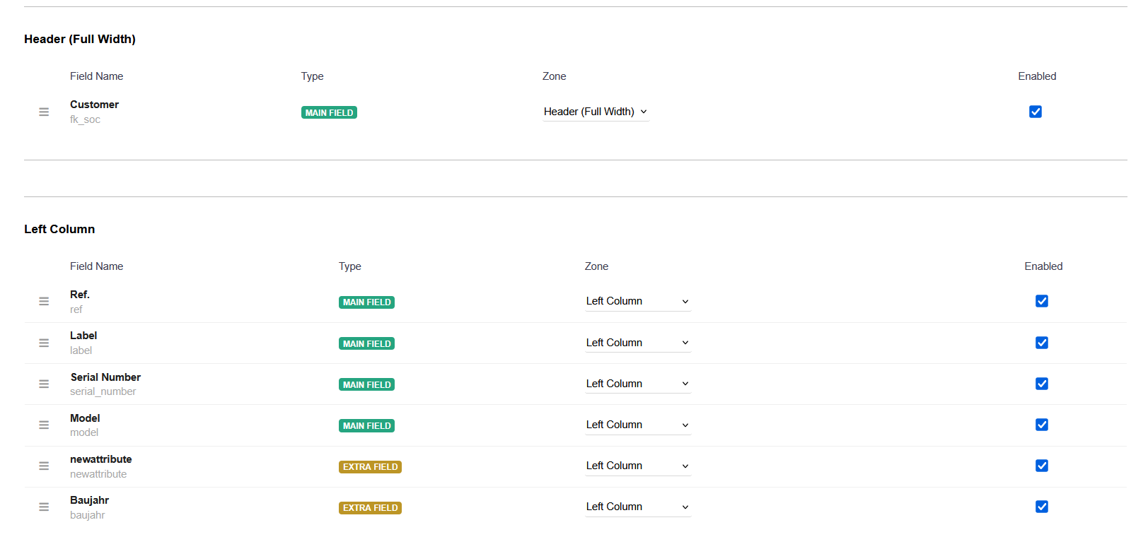

Layout of the Asset page can be modified at the module setup.
