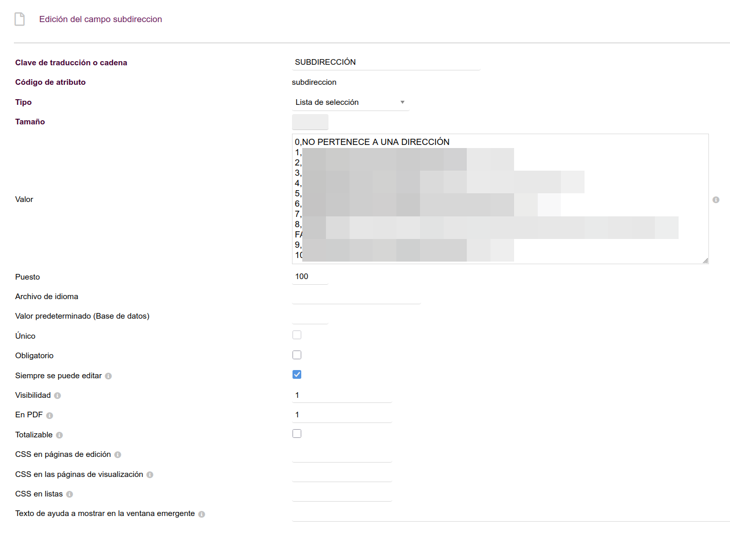

Where on the template do you want to place the 2 extra fields, and would you mind sharing the extra field definitions?
I would also like to see an object where there are data in these extra field. A screenshot cutout would be fine.
@jonbendtsen thanks for your quick response.

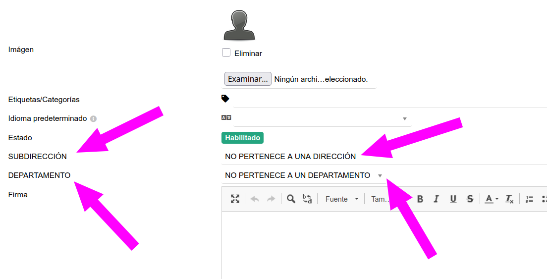

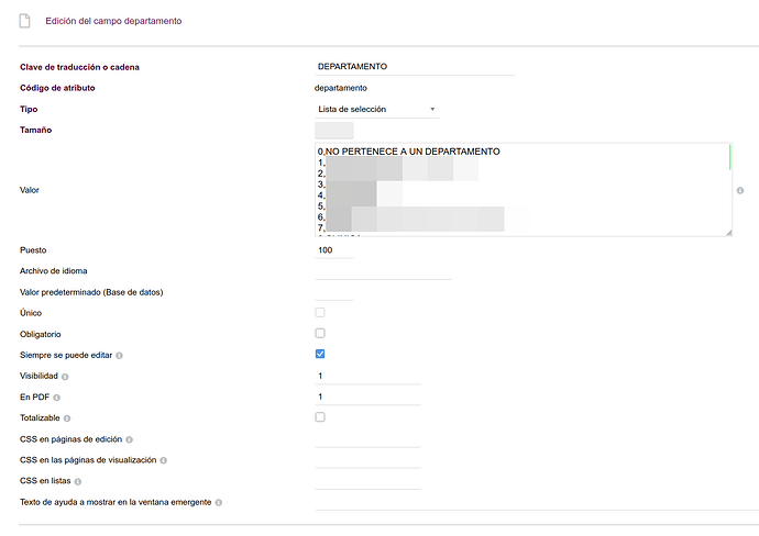

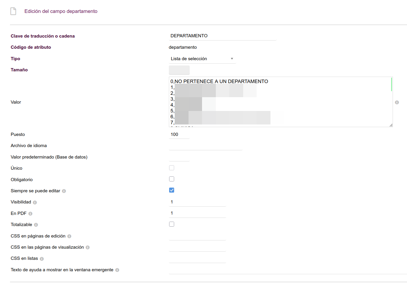

The Extra Fields were added to the user’s module:
This is an example of user extra-fields with data (please notice “NO PERTENECE A UNA DIRECCIÓN” and “NO PERTENECE A UN DEPARTAMENTO” is an option in the extra-field.

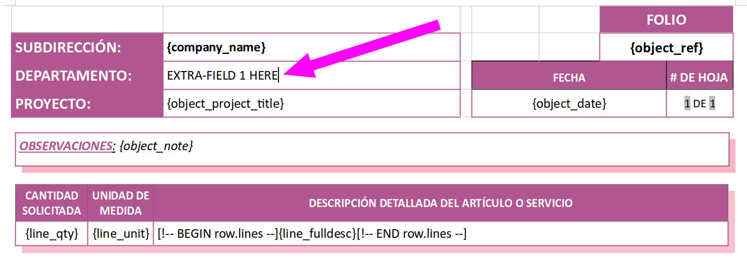

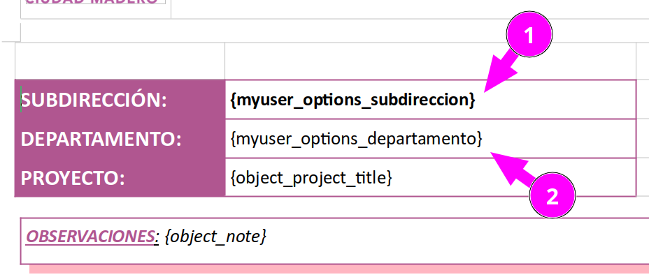

Here you can see the area where I want to place the extra-field 1, which must contain the “NO PERTENECE A UNA DIRECCIÓN” text.
I don’t know how to call these user’s extra-fields.
Can you please guide me?

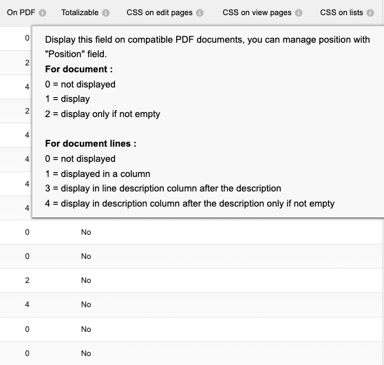

I don’t use extrafields on users. I do use them on proposals, orders, invoices. + on Projects.
I have them both on the object itself and on the object lines.

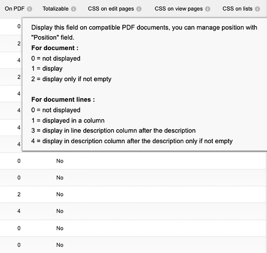

I don’t always display the content of the extra field on the PDF.
As for the complementary attributes on lines, aka extra fields on lines, I only use the value 4.

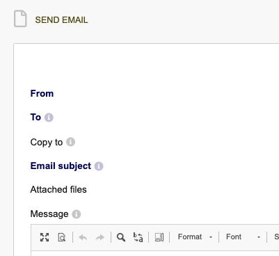

Maybe this can somehow help. If I click send email on one of these objects and I click the little encircled i next to Message then I get a popup with a lot of variables I can use for inserting data into the email. Maybe it is the same with ODF templates?

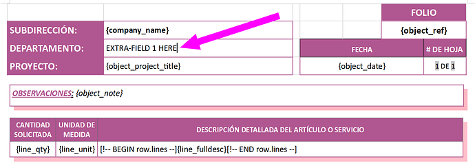

Your previous response gave me the idea and I thought that, if we can call the variable names with a standardized name, we should be able to do the same with the user’s extra-fields with using the same logic as per in the other modules.
So I went for:
  1. {myuser_options_subdireccion}
  2. {myuser_options_departamento}
The document template is now:
I am happy with the results.
