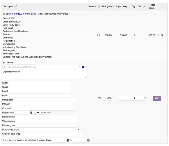

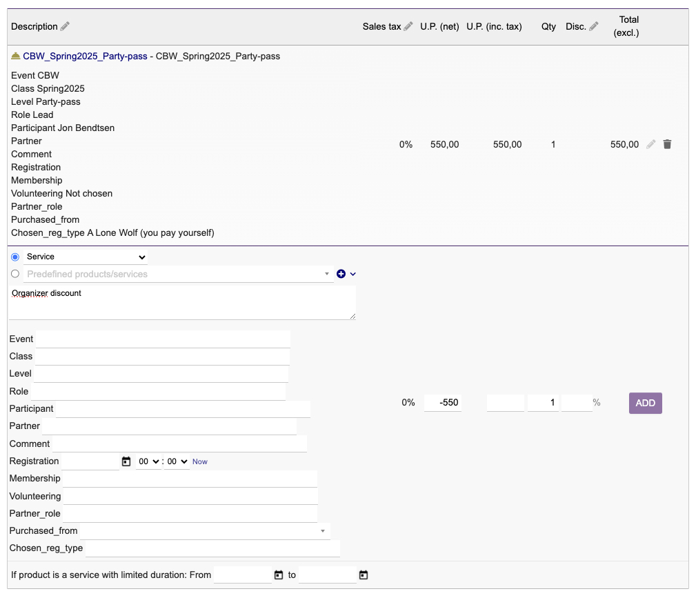

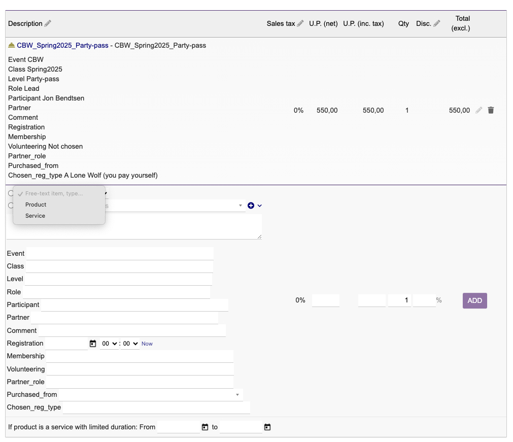

On an proposal, or order or invoice, I simply add 1 line which is a “Free-text item” the type doesn’t matter, but I use service. If you only have enabled products, then use products.
I fill out the form with a text with the reason for the discount - this can be anything “pink elephant”, anything. I usually write a meaning full text, and in these pictures you can see me give myself an organizer discount for the weekend dance workshop that I help organize next weekend.

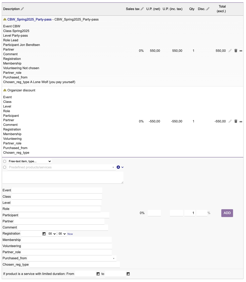

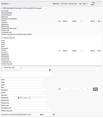

Once I click add, then the negative price is counted against the price of the service/product that is on the proposal, order, invoice, …
After this order is modified I can just validate it and even create a 0,00 invoice if I want to.
