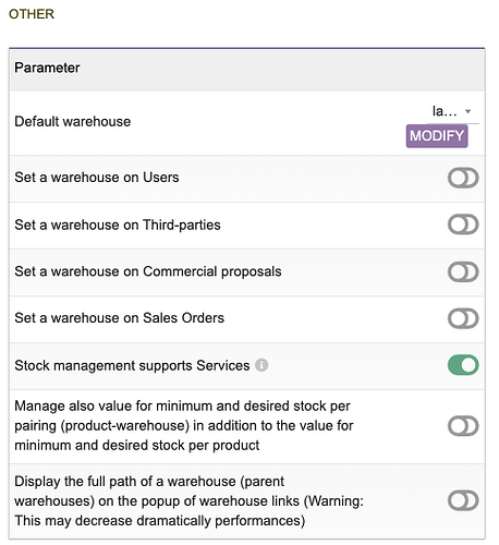

My “product” in question is a service, and I have enabled stockmanagement for services.

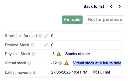

Looking at the stock tab for this service I see 5+12
It does not matter if I change the date on /product/stock/stockatdate.php?mode=future&productid=128 it is still always 5+12 - when will this change?
Using the API I get the same - /api/index.php/products/128/stock
"stock_reel": -5,
"stock_theorique": -12,

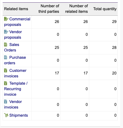

Looking at related items I see 17 invoices, and 5+12 is 17. But 3 of those 17 invoices have the same service twice on them. So the numbers should be 20, not 17?
/product/stats/facture.php?showmessage=1&id=128

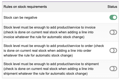

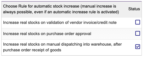

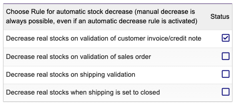

Here is my stock module configuration
