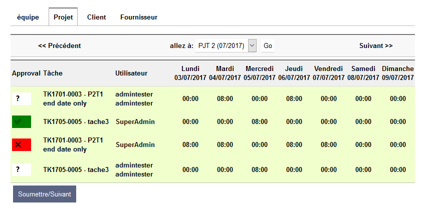

  2. the manager of the user (N+1 or N+2 base on manager name in the user page) go on the approval page (in the left menu) and elect approved or rejected for the ts on the screen

approval per project
here the approval screen for project :
