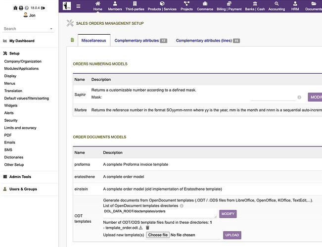

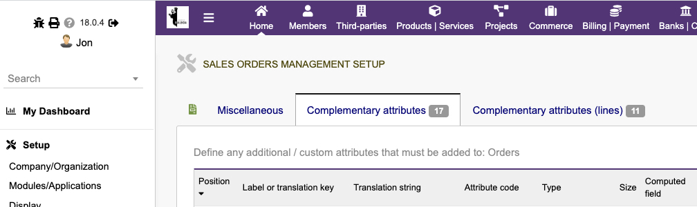

You enable Complementary Attributes here in Dolibarr 18.0.4:
Home, Setup, Modules/Applications
search proposal, order, invoice, … and click on the gear wheel.
Then in tab 2 are Complementary Attributes and in tab 3 are Complementary Attributes for product/service lines on the order.
I use both and I have an external form that fills out the same information in both places. I use the Complementary Attributes for overview in Dolibarr GUI and the Lines part for the PDF for the customer so they know what to get.
Hope this makes sense

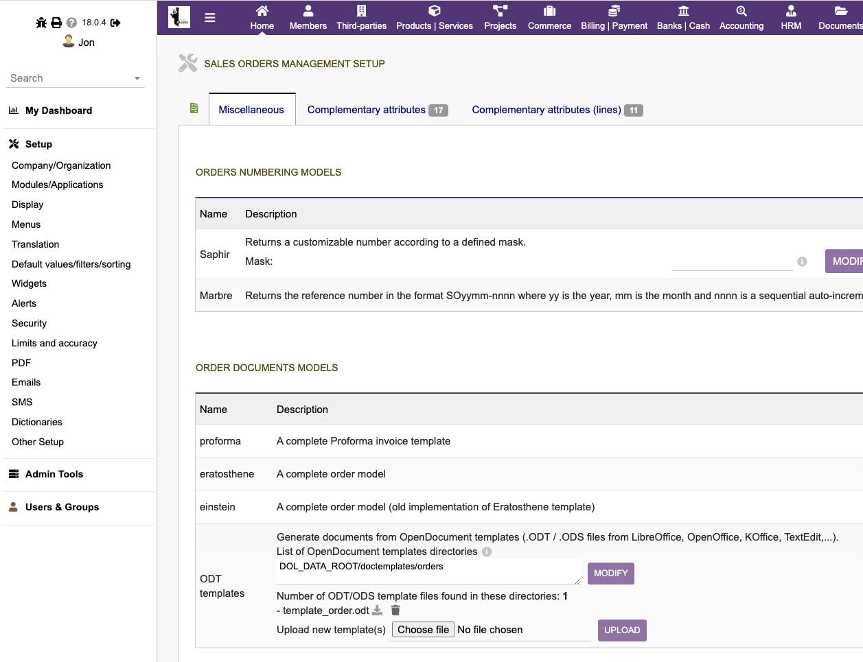

Second can I choose some other pdf template because that I have for order not fit me?

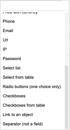

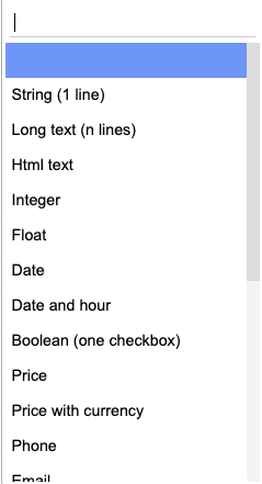

You can find the Complementary Attributes in the module setup. I don’t think you can make a dropdown, but there are other selectors available.
complementary_attribute_top
complementary_attribute_bottom
yes you can choose another order template

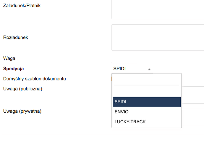

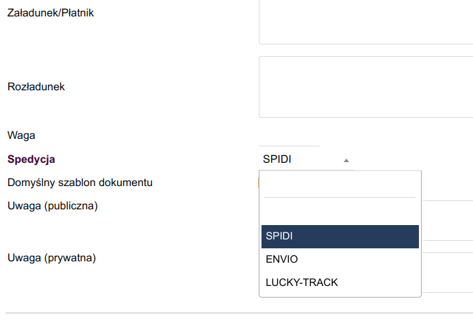

Thanks, I choose List and add somple logistics company I can choose from :slight_smile:
I think I will make something with that.

You can create a custom attribute with a list from a table, using your list of third party companies, by affecting them categories/labels/tags
That is an exemple where we can specify the housing tenant inside an invoice, based on the contacts with the tag “Locataire”, where the tenant is a contact of the company owning the house.
socpeople JOIN llx_categorie_contact as cc
ON cc.fk_socpeople = rowid:lastname:rowid::fk_soc = (
       $SEL$ fk_soc FROM llx_facture WHERE rowid = $ID$)
AND cc.fk_categorie IN (
      $SEL$ rowid FROM llx_categorie WHERE label = 'Locataire')
