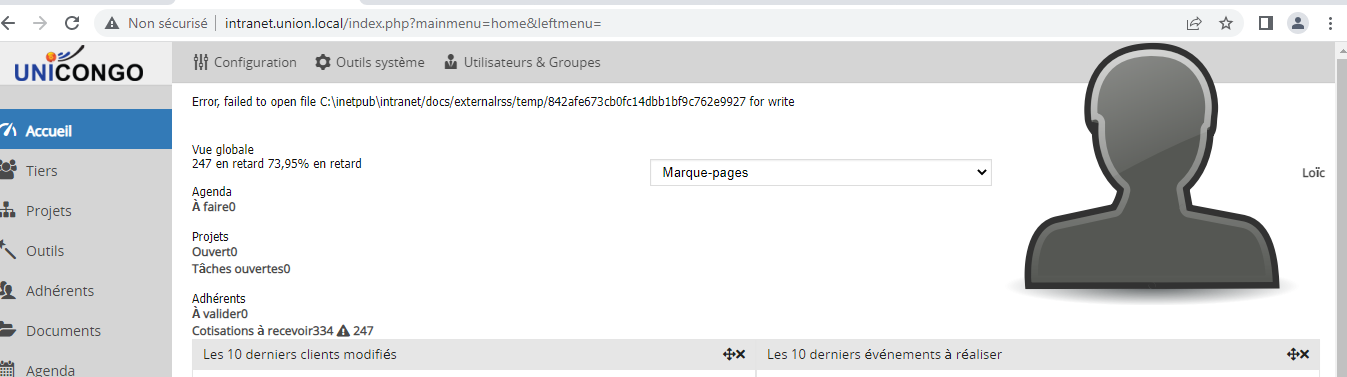

I get an error on the front page about access to a file that is restricted.

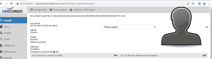

The profile user picture/avatar is huge and does not go away or stay in the top right corner.

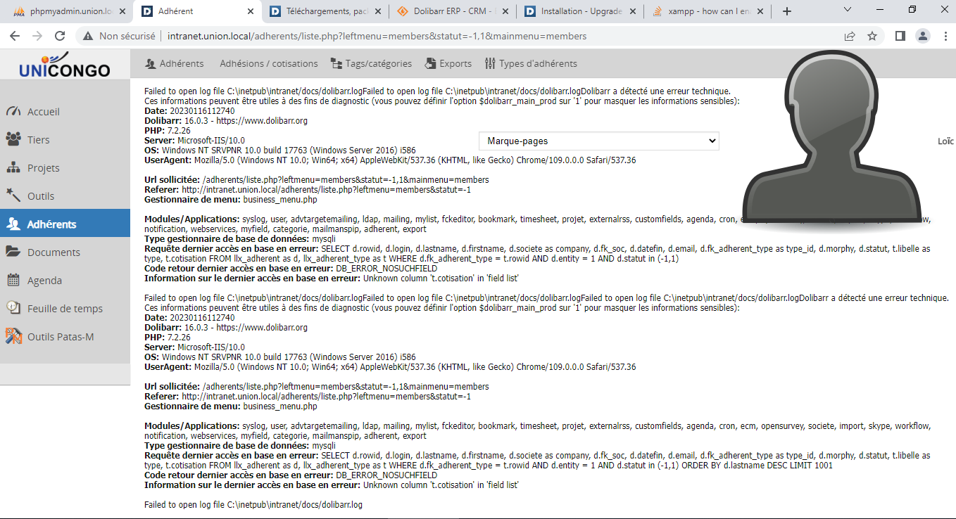

The members list is broken.
Any ideas what might cause this?
I have attached images of all 3 problems in this window.
this is the error on the main page.

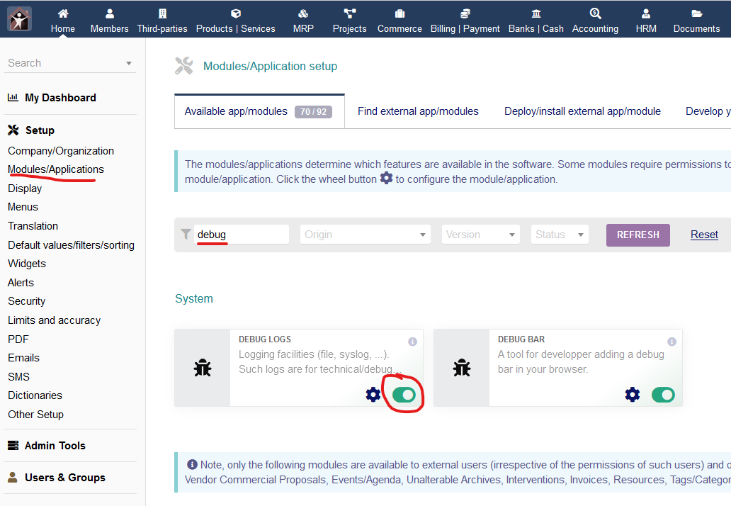

The fatal error is due to the configuration of the Log module.
Try to deactivate it :
For the “big” picture, I think it’s a browser cache issue, try to reload page with Ctl+F5 or clear the browser cache
My version looks nothing like yours. I’m so confused.
ksar, turning off the module helps with some errors but isn’t it a permission issue we can fix differently in windows?
And how about the huge profile icon on the right side?
From my research it seems that the table:
llx_adherent_type
as changed.
Column “cotisation” was removed and “subscription”, “amount”, “morphy”, and “duration” were added.
But why is the query asking for “cotisation” in the image i uploaded in the new version of Dolibarr?
This error seems indicate that you have old PHP files with new PHP files.
Try to remove all the PHP files and put back fresh V16 from archive
I tried 5 times, there is a bug with the update process. I tried it with a blank installation and still nothing.
Unfortunately, it will be difficult to guide you through a forum.
Maybe you can contact a dolibarr partner to help you on that?
