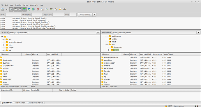

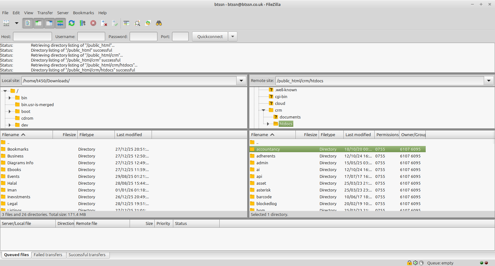

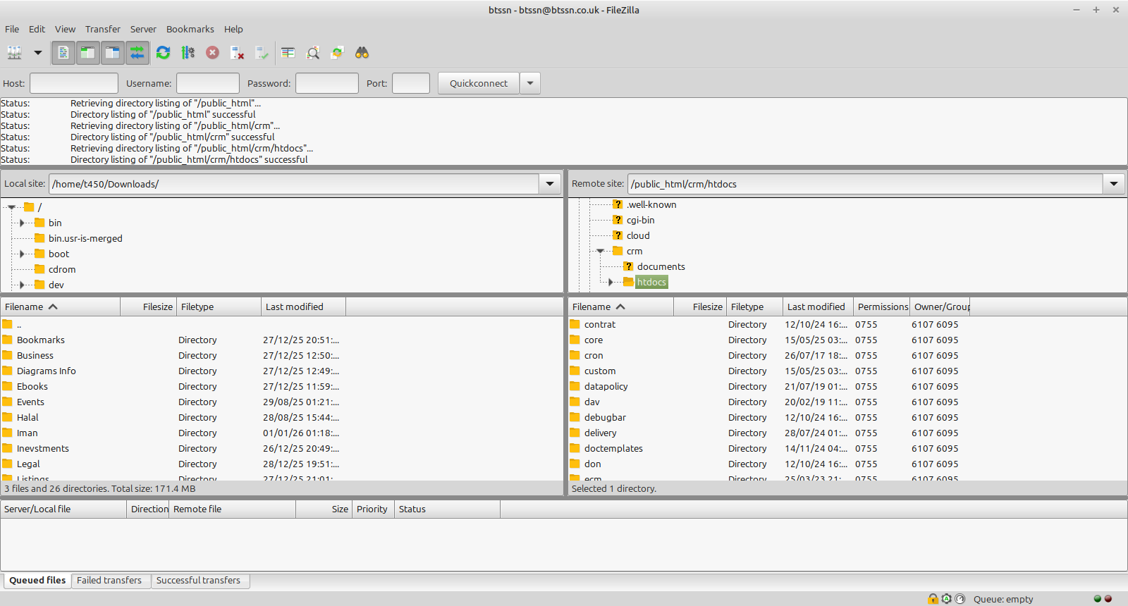

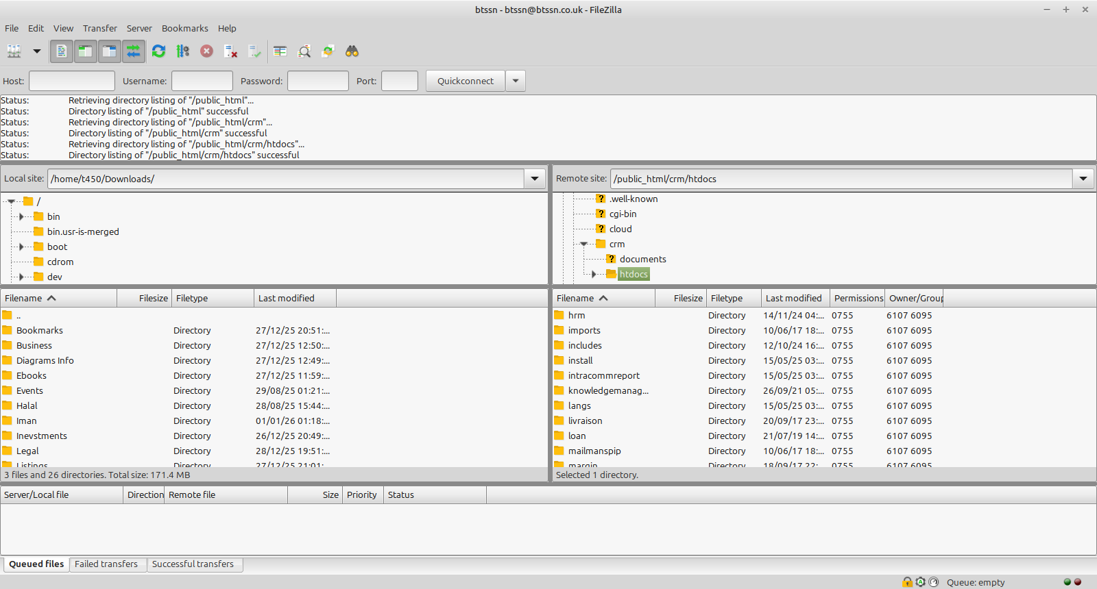

firstly, please post a picture where dolibarr should have been shown so we can see more of what is wrong with your setup.
webiste/crm/htdocs/
the file you are getting back is the index.php. Instead of executing this file it is downloading.

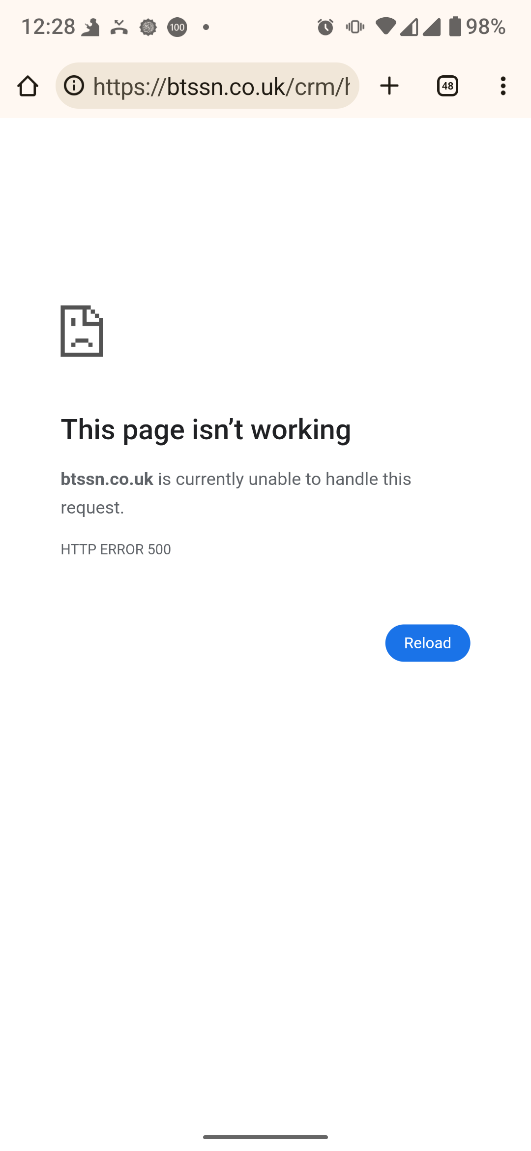

update hostgator fixed php now it says php works but not showing login page ?
then what does it show? show us a picture of your browser, not of Filezilla
your page has an error 500 - find someone with experiance in setting up the server.

@sajeel find out why it returns 500, read the webservers error log
