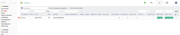

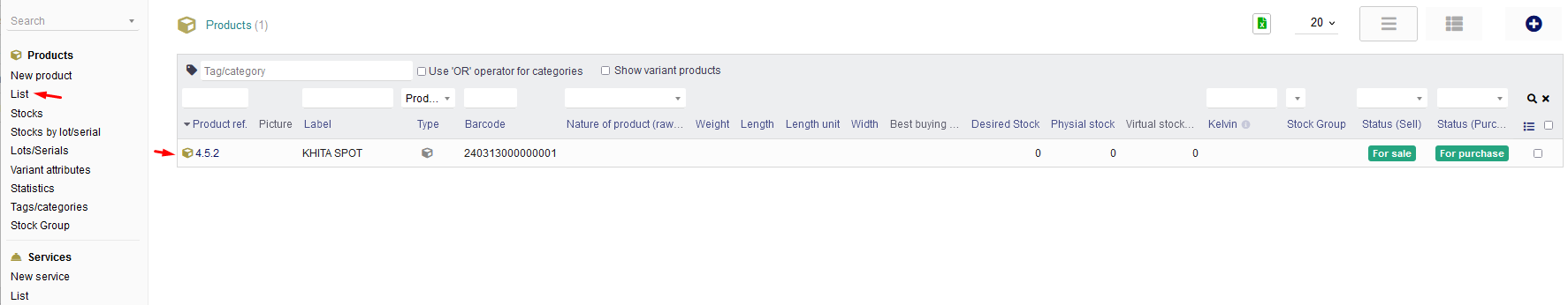

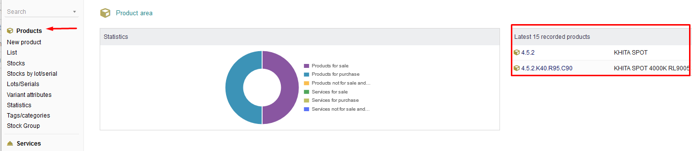

I use variant products with variables. and only the main product appears on the listing page

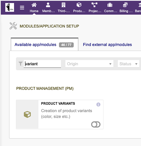

Of course, if the options are not activated, this menu will not appear.

The error is caused by expressions and variables in list.php. as seen in the picture below.
