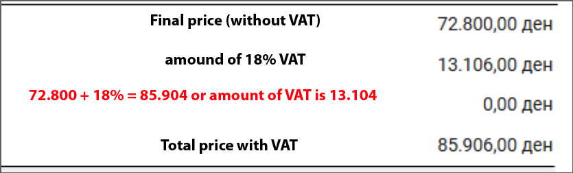

I have a problem with VAT calculating. Now VAT calculating on each line separately.
But in my country it must be calculated on final price (without VAT) not on each line.
Main problem is that when it make calculating VAT on each line on the end i am getting different final price with VAT.
On the image i will show you the problem.
So the main question is there a option to make VAT calculation on the Final Price and how can i make this?

did you have a look at this Wiki page: VAT setup, calculation and rounding rules - Dolibarr ERP CRM Wiki
You are probably looking for this variable (under Settings/Others): MAIN_ROUNDOFTOTAL_NOT_TOTALOFROUND.
This lets you configure, if you round the lines first and add them later or calculate the sum first and round this. VAT is then determinded based on these values.
Hope this helps,
Joachim
Hi, yes that’s what i need, but if i set MAIN_ROUNDOFTOTAL_NOT_TOTALOFROUND = 1 than i have a problem with adding any line in invoice.
When i click add it only refresh page and line is not added. In Total Price it show price, but not add lines.
