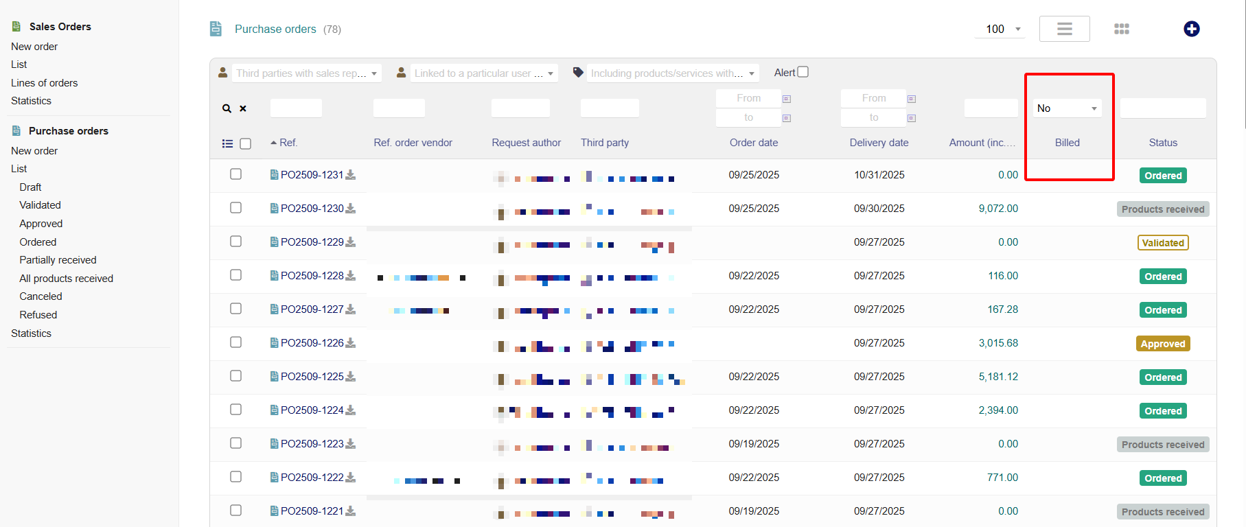

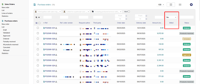

Hi, I can clear the filter and get all my PO back as normal, but if I go around and back to List of PO page, it will be filtered Billed=NO again
So I think filter’s functionality is fine, just the default value should not be applied.

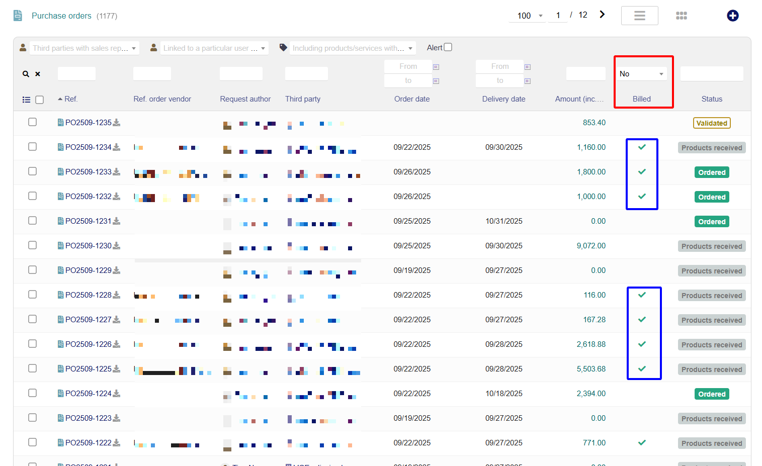

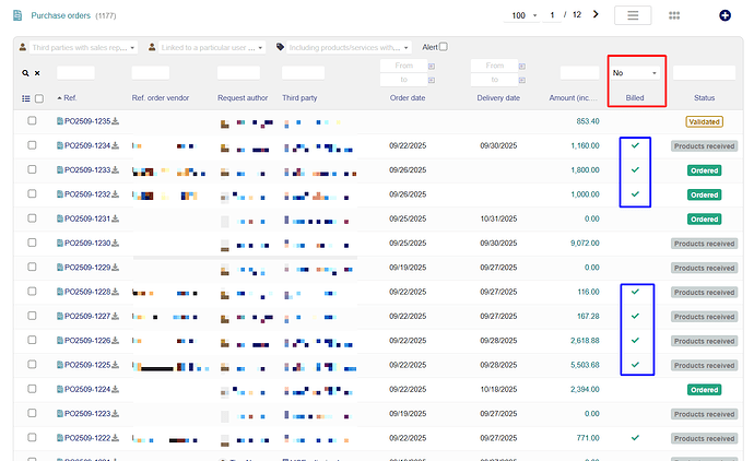

Hi, just want to update: the above described problem happened when I select PHP v8.3,
when I rollback to PHP v7.4, the Billed = NO doesn’t work as it should be, as you can see in attached picture
