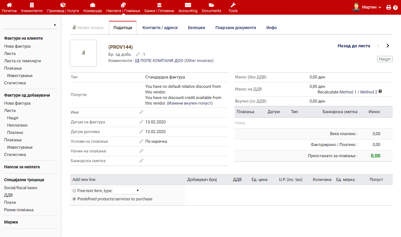

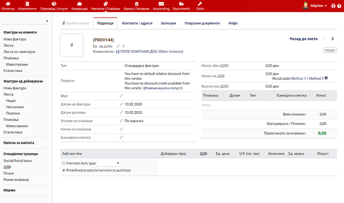

Actually i can select third-party, select dates, ref. number etc., but after clicking “Create Draft” i am on page where i can add all products what i want “Products Line”.
Here i have a problem, i have only to select “Free-text item, type” and only text without drop down menu where i can select products “Predefined products/services to purchase”.
I first time have that problem and only noticed with one supplier.
I sending image where is showing the problem…

Hi Martin,
It looks like the page is only partly displayed, indicative of a php error when grabbing the list of predefined products. You should have a look at your php error log.

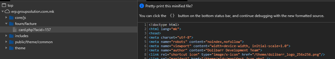

I find this in inspect

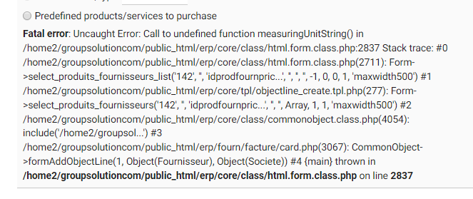

I find this, i hope this will help…
What does it say in Dolibarr/Home/Admin Tools/About PHP ?
From cPanel, can you access php logs ? Can you ssh to your server ?
That’s a very good candidate indeed ! It looks like you have a product from that vendor with units defined and the system is calling a non existant function. If this is not critical for you, you could maybe remove the units from these products and avoid this error…

I fix the problem…
The problem was in Other Setup, i remove that option PRODUCT_USE_UNITS and now page is loading without problem…
But this remove all units from products… is there any other way to activate unit on product?
Can you edit the file core/class/html.form.class.php and add the line
require_once DOL_DOCUMENT_ROOT.‘core/lib/product.lib.php’;
after line 2828 ?
This should allow php to find the missing measureUnitString() function.
