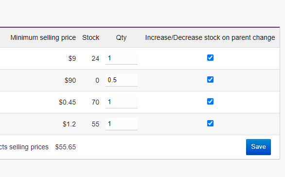

Hi Dolibarr community.
I’m having trouble understanding the Virtual products (Kits) feature.
Situation:
* I have a virtual product that consists of two real products.
* The virtual product has the option “Increase/Decrease stock on parent change”
* Dolibarr is configured that when shipping products, the stock decreases and when receiving shipments, the stock increases.
When I sell the virtual product, the real products attached to it decrease.
When I receive ordered real products, the stock count of the real product increases. But the virtual products stock count does not.
When I correct the stock for the virtual product, the real products will also increase…
So the question is, how to I automatically, or manually increase the stock of the virtual product? (Or do I need to uncheck the “Increase/Decrease stock on parent change” on the virtual product, and then correct the stock, and then change the “Increase/Decrease stock on parent change” back…)
What is the correct flow for this?

Untick ‘increase or decrease’ option
use factory module -> real products quantity will be consumed to make the final product. so real products decrease and the final product increase.

I don’t think buying a module for the Dolistore is a reasonable answer to this. The detail on the ‘virtual products’ tab of the services is clear about how this should operate.
Is this actually a bug?
