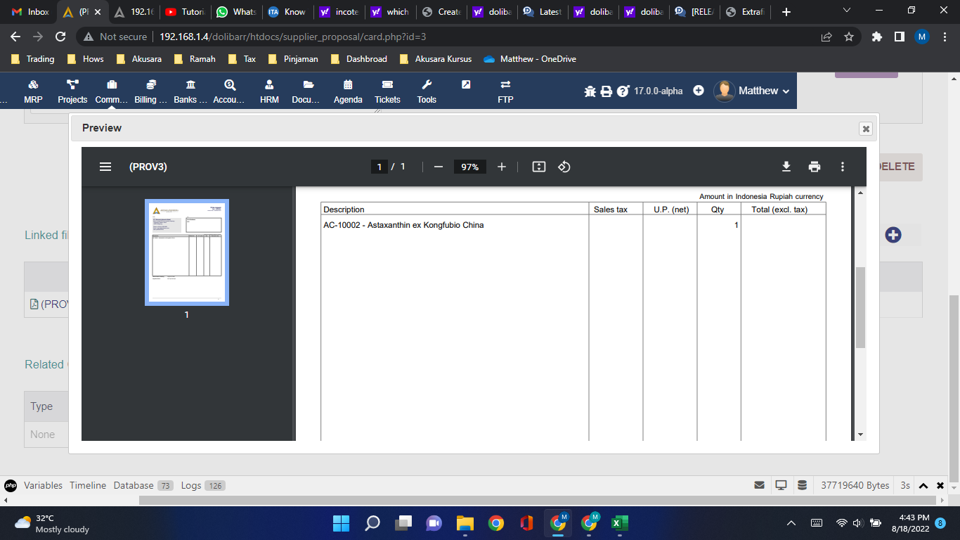

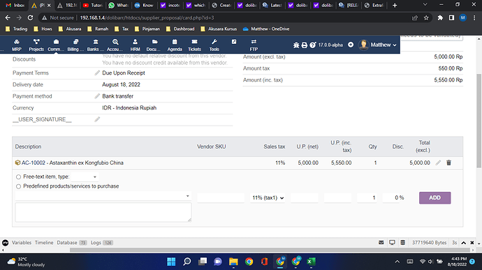

Why my vendor proposal Amount not show at my PDF
Hi guys i having some problem, why is my vendor proposal Amount not showing at my PDF form, anybody could help me

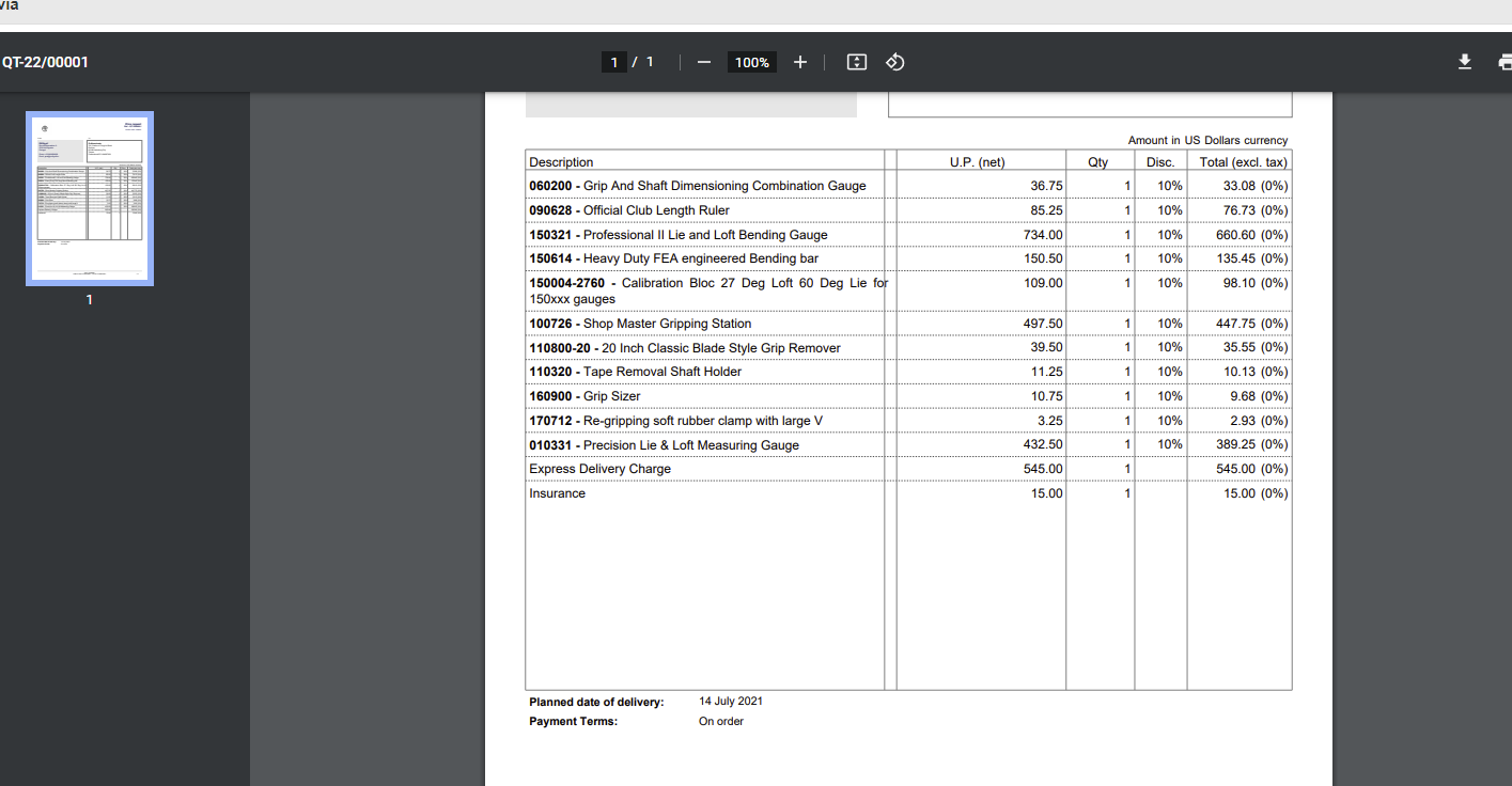

This is how it looks now btw.
I still have to put the tax in its own collumn and see what changes I made there as it is not very cool to have total and tax in parentheses in the same column. I might have rushed this but for now its enough.
