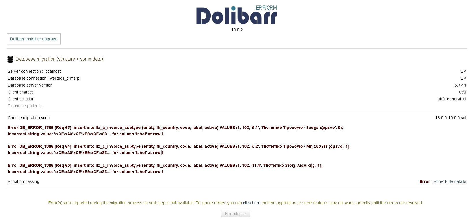

Hello everyone. I am attempting to perform an update, but I have encountered an error that is preventing it from continuing. Any advice would be appreciated. Thank you!
You have one table that doesn’t have the good collation
Try to run the repair script : /install/repair.php?force_utf8_on_tables=confirmed
You can also have a look here : DB_ERROR_1366 & DB_ERROR_1452
Also note that you can ignore this error (the 3 lines are used only for greek users)
@ksar Thank you. I just ignored them and the installation seems to went through.
Thank you Eldy.
I just ignored the errors and the installation went through.
