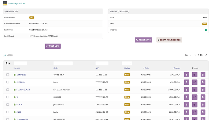

The incoming invoices page will be in v1.0 and can view incoming invoices

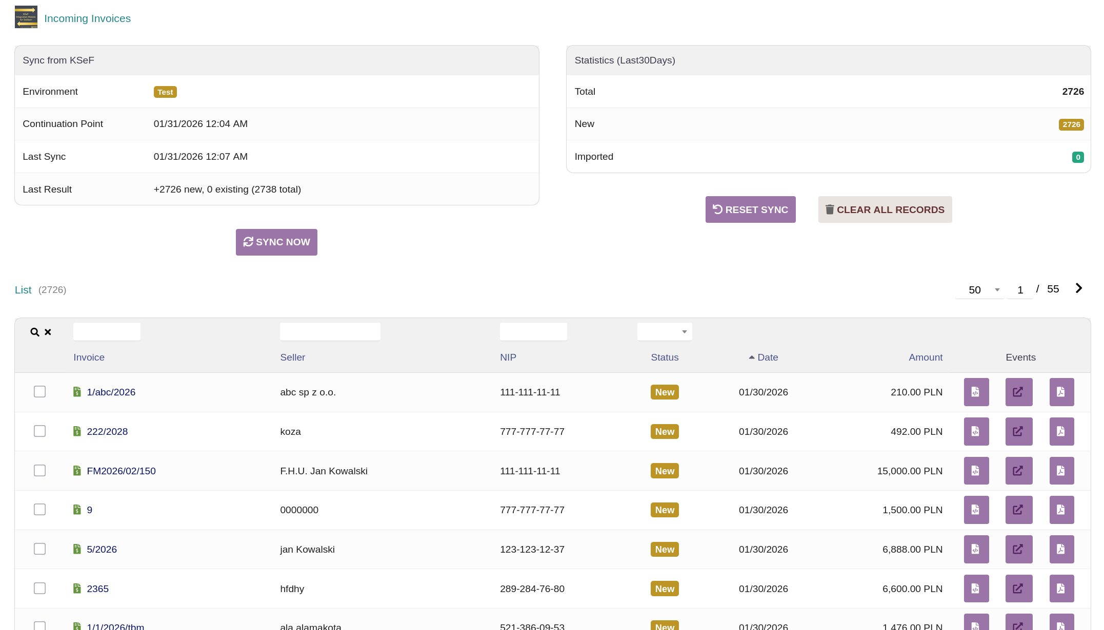

Downloading the invoices from KSeF in bulk is working. However, in the test environment I’ve seen it can potentially be very slow for huge numbers of invoices - downloading 30 days of test environment invoices for instance attempts to download and process ten thousand invoices each time it syncs which takes about 5 minutes, especially if you leave debug logging on and end up with a 300MB logfile of every database action… However I successfully grabbed 29199 invoices from the test environment so it does work.
It’s using the high water mark synchronization method from the KSeF docs.
It’s also possible to become rate-limited, but thankfully they provide a “retry after” response in the API and this response will properly block the sync button.

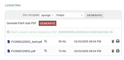

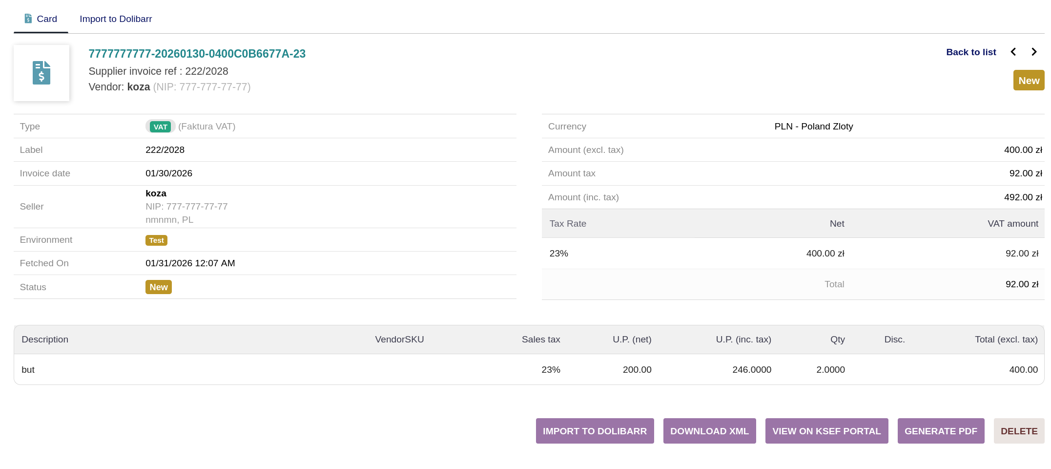

I have based the preview card for these imported invoices on the card.php from htdocs/fourn/facture/card.php, just with more limited functionality. The Import to Dolibarr button and tab are unfortunately just a placeholder and have no function (yet).
The Generate PDF button is somewhat working and uses TCPDF to generate a PDF in the KSeF style, since the KSeF API does not allow for downloading the visualization PDFs. However, it needs some more polishing so I’m not sure if I will finish this before 1.0. I would also like to allow overriding the PDF generation for standard invoices with this as well, in case this style of visualization is preferable.
I have managed to get the PDF visualization working closely enough to mimic the visualization available on the KSeF website for incoming invoices and so v1.0 will also contain a second “generate” button to the Linked Files box for outgoing invoices (using the same visualization class), which instead of using the Dolibarr templates generates invoices in the style of the KSeF visualization using TCPDF. This may be preferable for some than the sponge/crabe templates. However, in the event of Offline invoices this button will gray out and be disabled. Right now only the sponge/crabe templates have the additional logic to handle such a case at the moment.
In a future version will look at replacing this separate button instead make this visualization style another template available for use in the standard way, but this was easier to implement in the near-term.

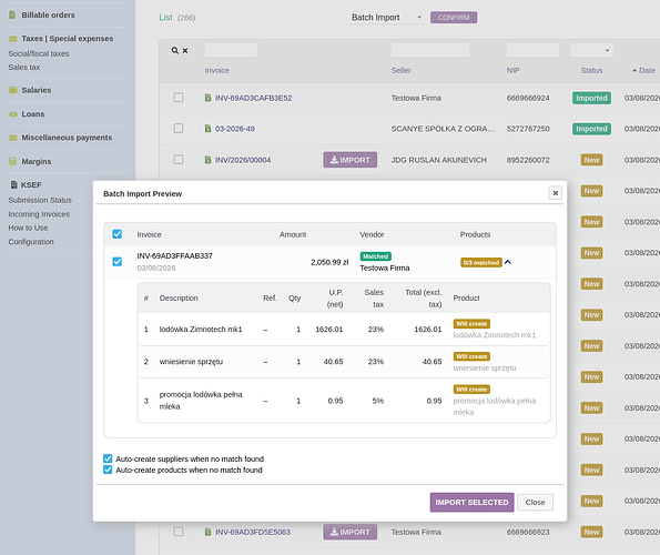

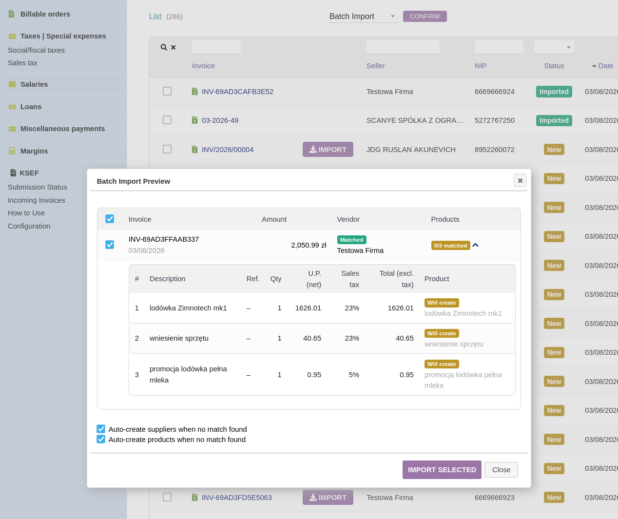

Obviously this is test invoice data, but the (still WIP version) allows for auto-matching of the Third Party and auto-matching of the product by barcode if it’s on the invoice in batch import. Otherwise, it can autogenerate a new product (albeit with somewhat limited information/data).

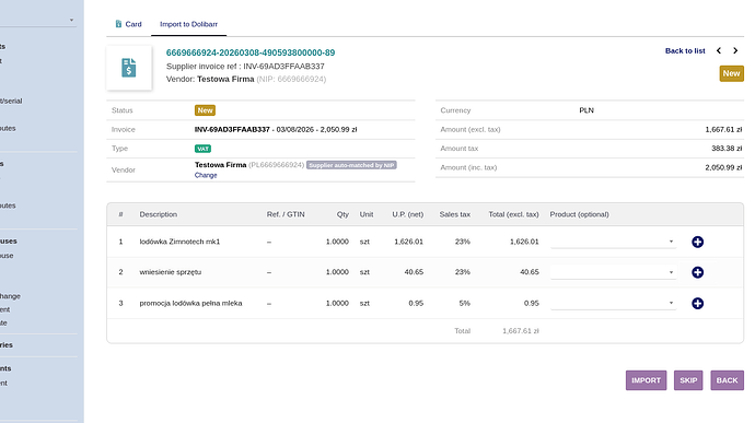

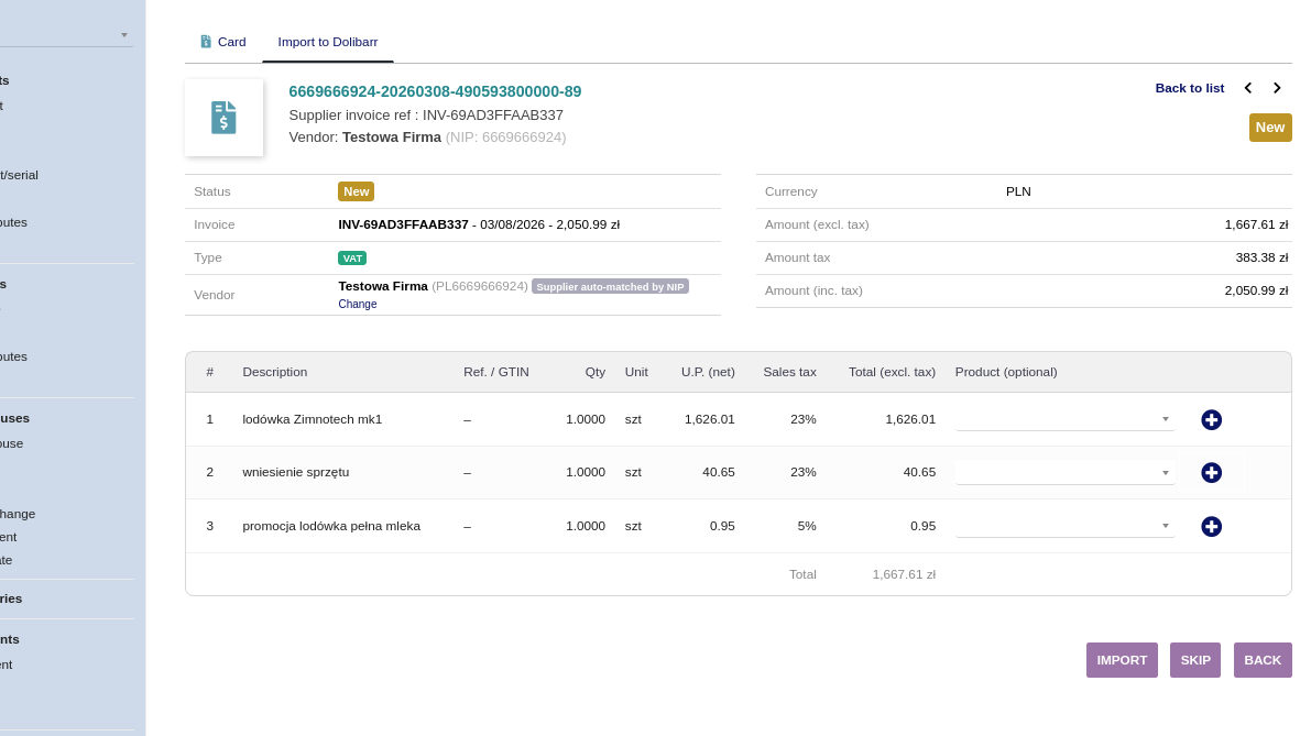

There is also the ability to import invoices individually of course, seen in the “IMPORT” button in the background of the above screenshot.
It pulls up the page below (also accessible on the Import to Dolibarr page that previously existed) and users can either create/find an existing third party and then choose to import only the line items as text in the Dolibarr vendor invoice (as described in Option 1 in the above post) or manually choose products from the product list (as described in Option 2 in the above post). I will add the auto-match on barcode functionality to this page as well.
Importing only line items without linking them to products is also possible on the batch import if “Auto-create products when no match found” is not selected.
It will likely be a few more days to finish solving various edge cases and handling credit notes properly. I provide it just for initial feedback on the direction
